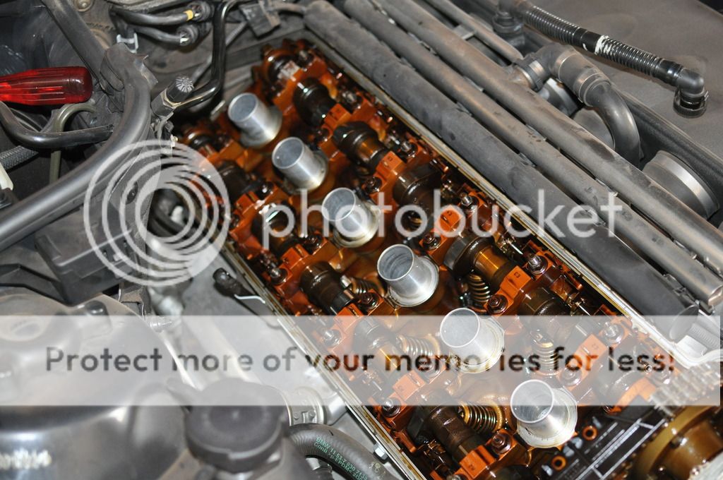

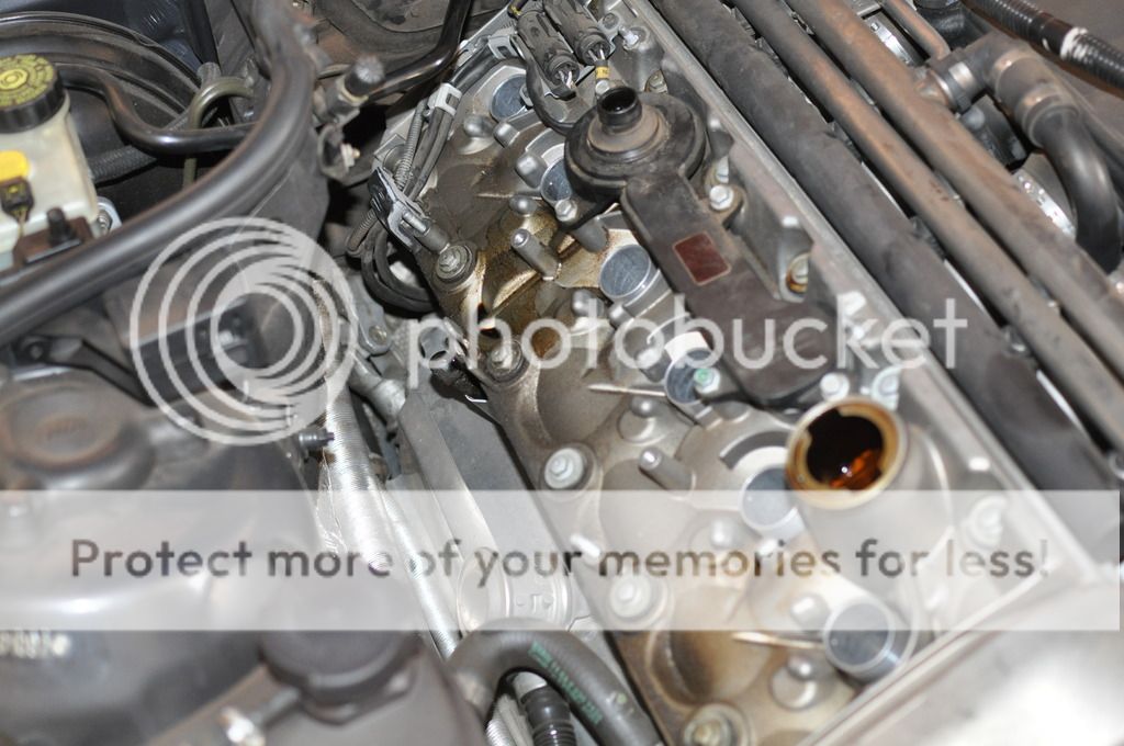

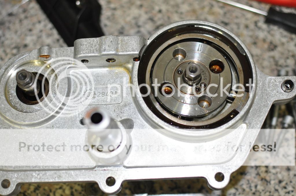

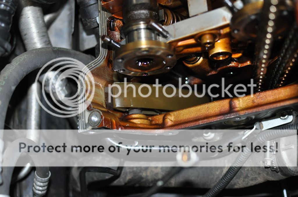

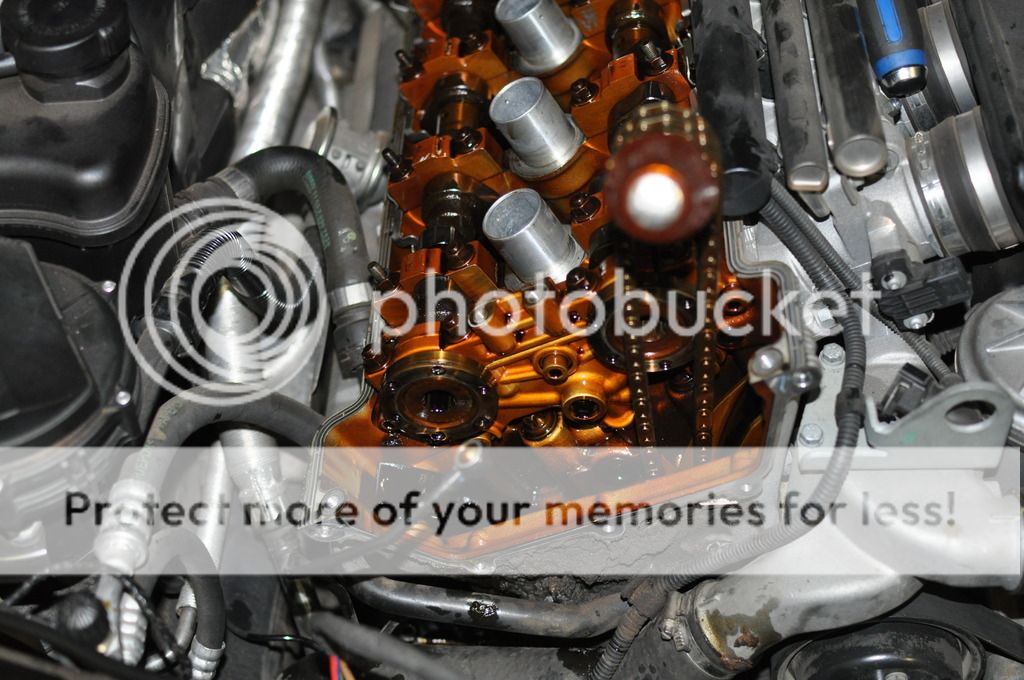

This is a low kilo car with a rattle and nosiy engine.
Car is a weekend toy predominantly

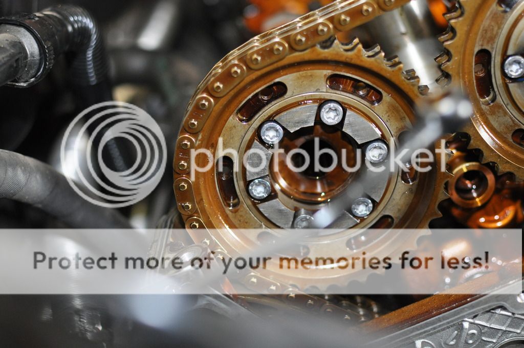

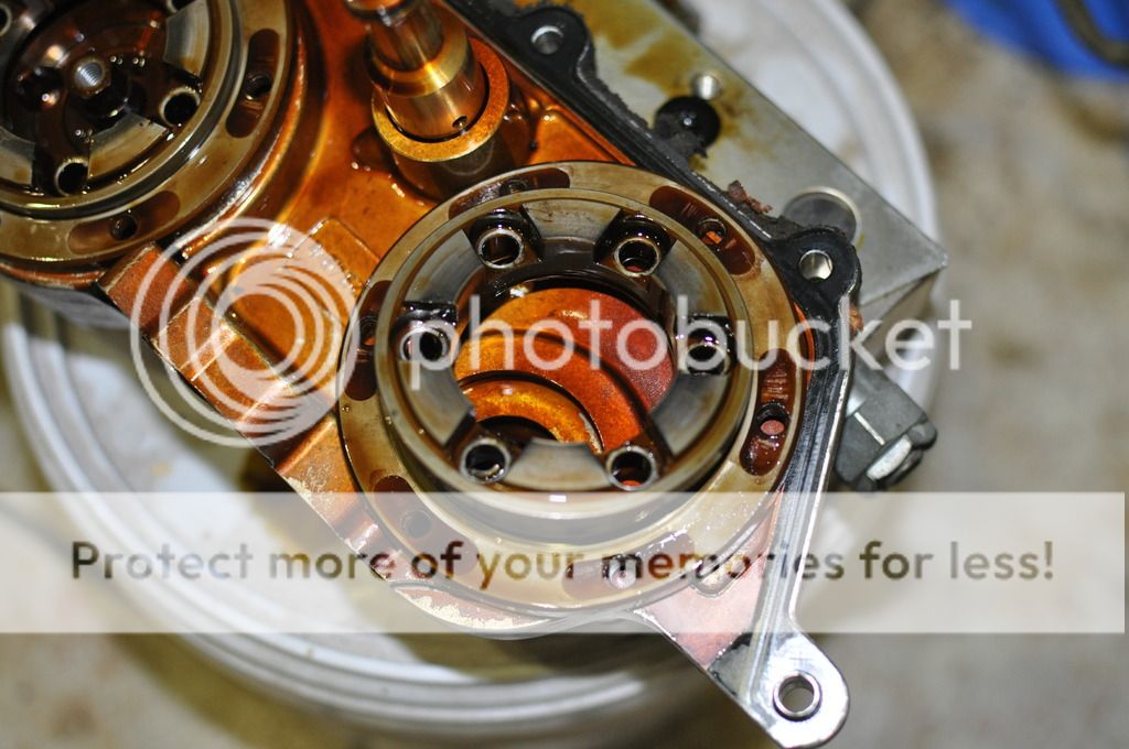

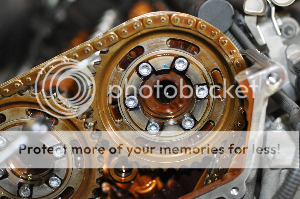

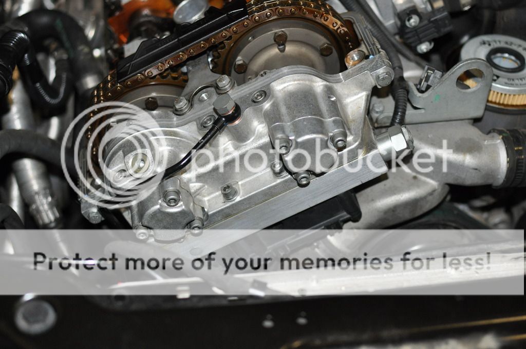

Vanos and clearances to be done.
The older models have a weakness in the can hub backplate coning loose as the factory did not use locktite so I was asked to change bolts.
Good thing.
Surprisingly at some stage of its life this car actually has had valve clearances adjusted before.....first one I have come across :)

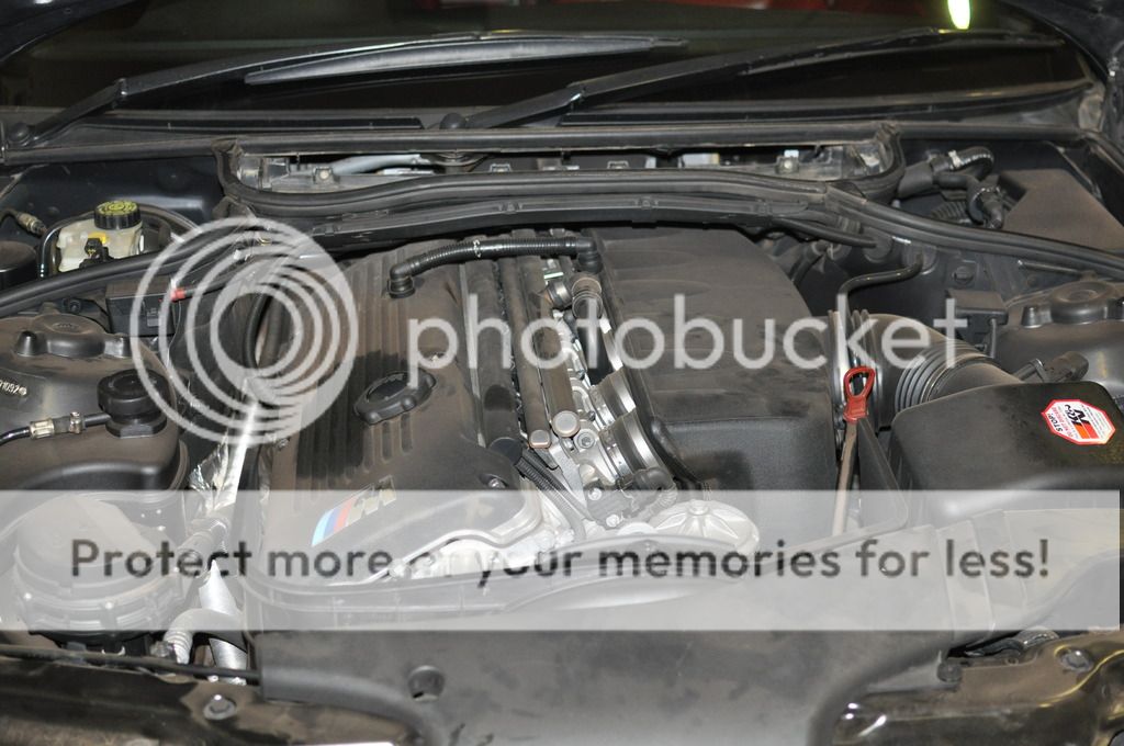

Quick question, I see the K&N sticker on the air filter box is it a pure paper or sponge type of filter and what are the results?
Peter@AEW
Gizmo said:
May I ask how many KM?
169600Km
Daaf Vader said:
Whoevers car this is, it is going to be well worth it.
Keep the good stuff coming
:clapper:
K&N
I prefer OE
Peter@AEW
Dean ///M said:
Would any of this work be required on a Z4M Coupe with 80 000km?
Clearances yes
Vanos yes
Oil pump drilling maybe
The short answer is yes.
