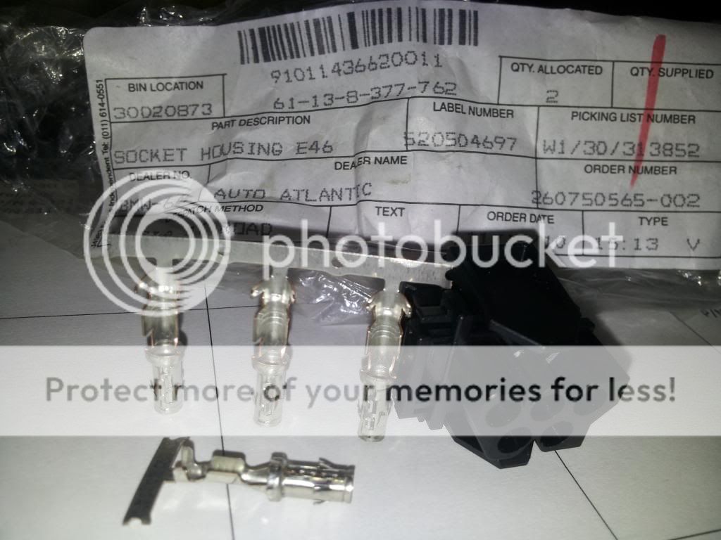

I have had a few e-mails in the past looking for the FSR plug housing
P/N: 61138377762
Part number for the pins that go in the resistor is
P/N: 61131376206 socket pin you will need X4
P/N: 61131376204 socket pin you will need X1
Remember after inserting the pins! although they lock in place you have to also push down the locking clip on the housing that further locks the pins in place.
Remember if the conector shows sings of melting then its safer to replace it or your resister will fail much quicker dew to the heat transfer from the bad conection into the resistor.
