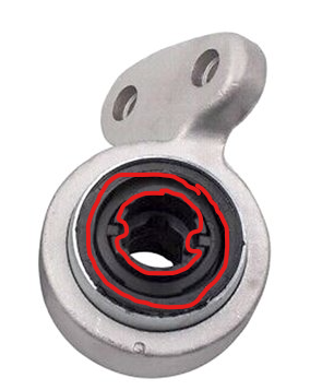

i had ny car at best drive On Beyers, had a look underneath, seems like the problem is with the Rear Control Arm bushes, i replaced these not a month ago with Febi units from Goldwagen. you are able to move them quite easily with a pry tool they are quite soft aswell.
i dropped in at Goldwagen and spoke with them there about this issue, they can only sell me a new pair and send these i have on my car for "Assessment" and wait to hear what there HO has to say , if they are defective the will reimburse me.
Tie rods and the steering rack are in good condition, ball joints on the control arms are also fine.
while i was under the car i noticed that there is a ring that has come off of the Rear Mount i did not take a photo, when i saw the new ones at Goldwagen i realised that they should not be off but actually be around the rubber bushing.
the circled ring is off and is just around the control arm part that enters into the bushing
also when removing the OEM bushes i needed to use a puller, when putting the new ones on they went on very easily minimal effort.
