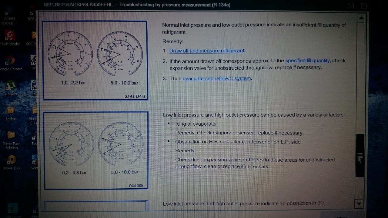

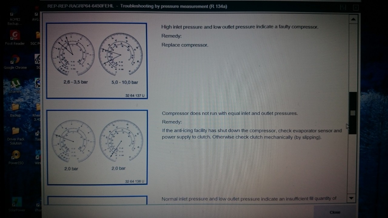

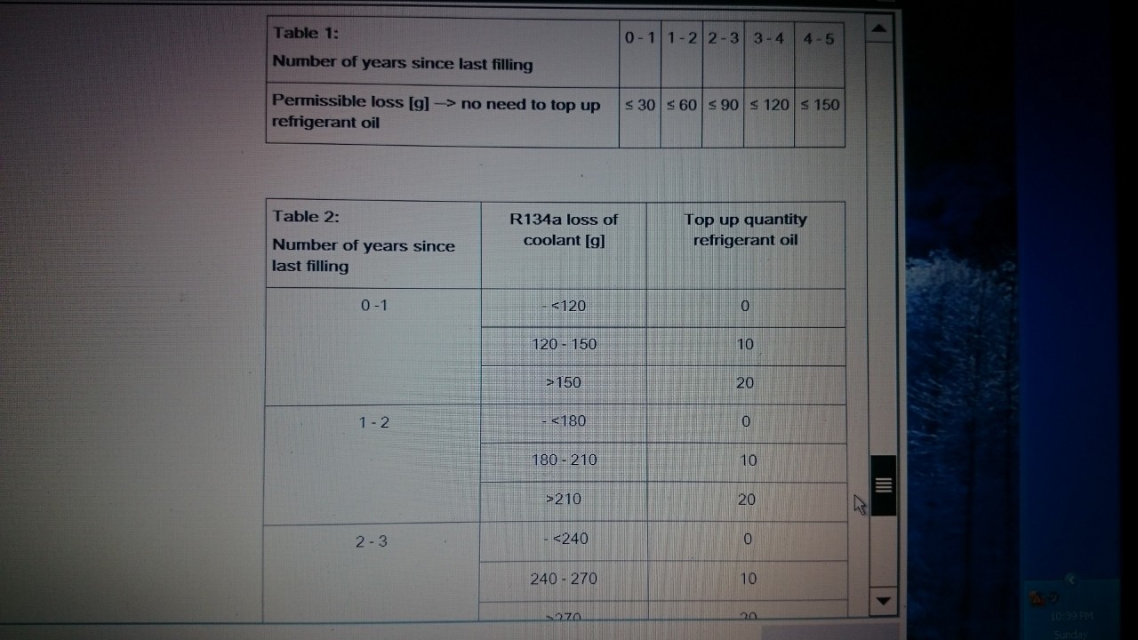

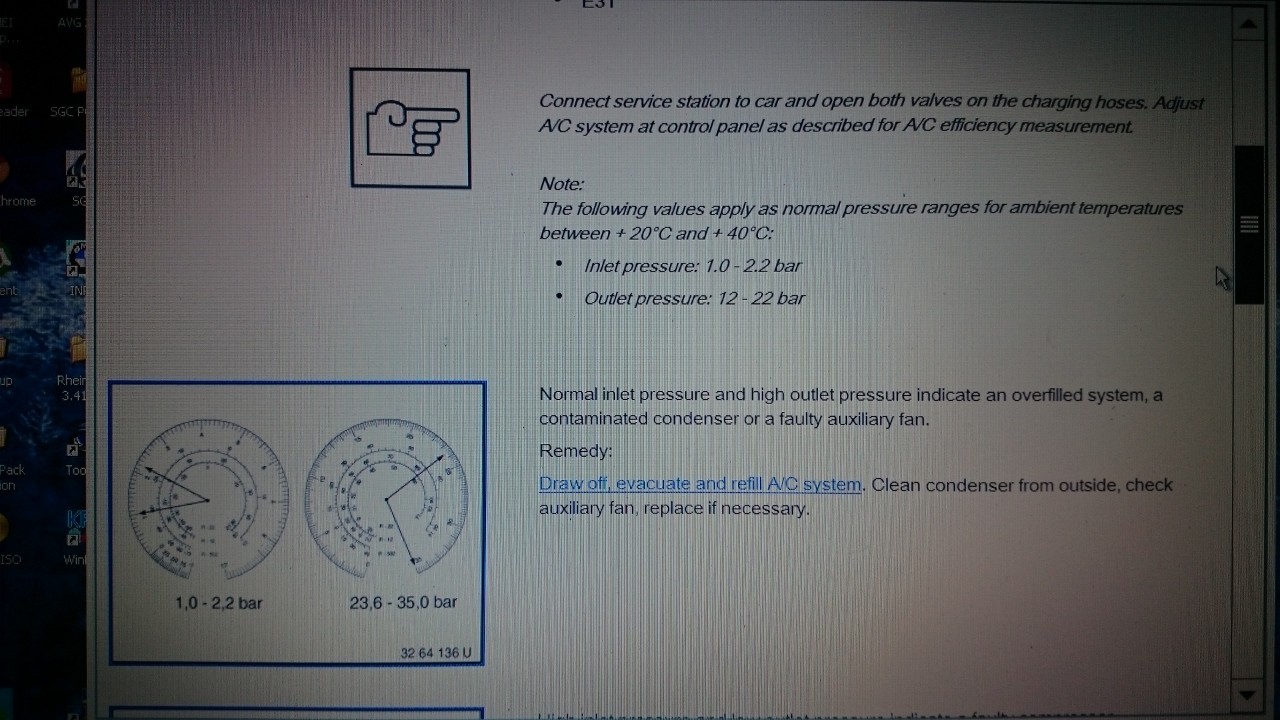

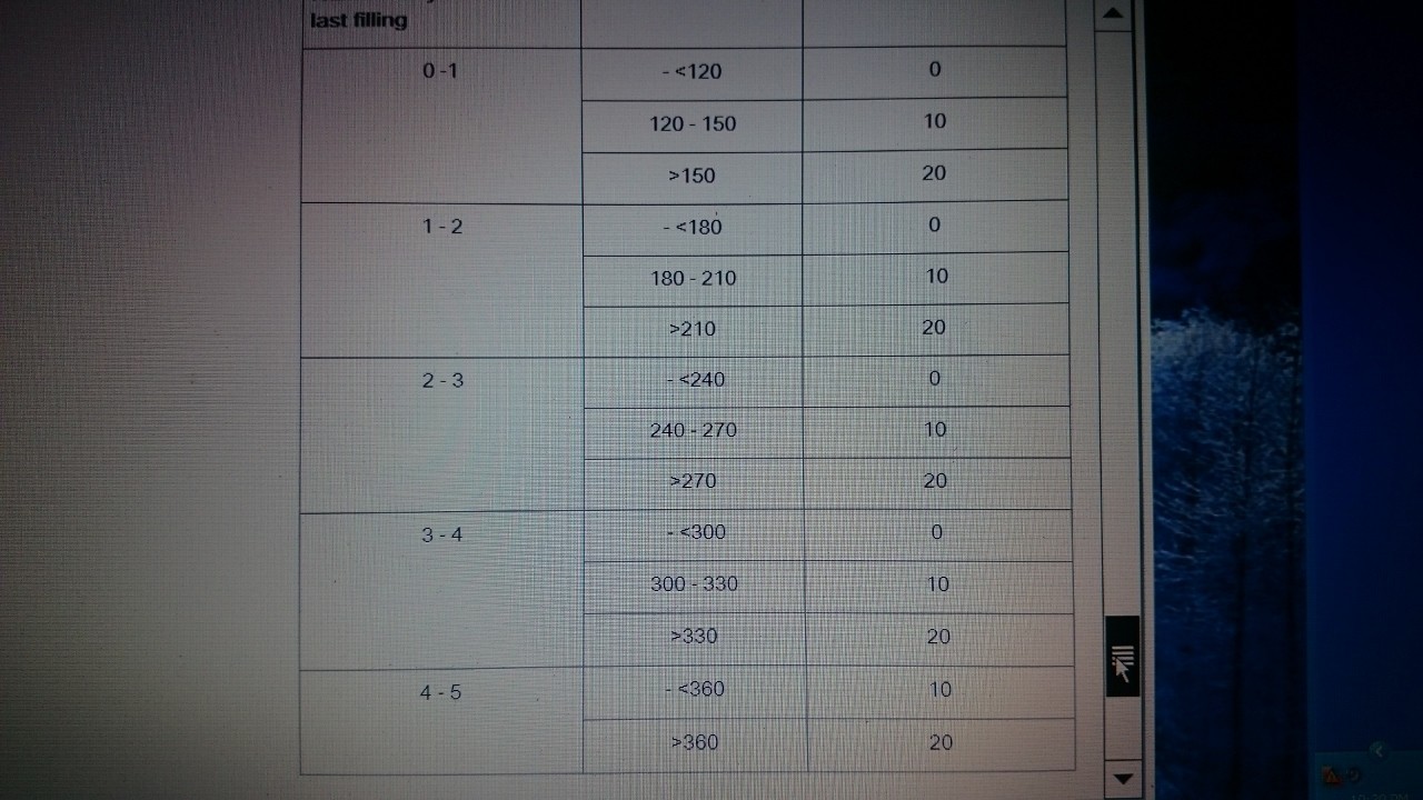

Here are some pics from Rheingold regarding pressure testing the AC system and interpreting the results as well as suggested refill quantities for the AC system. This is information provided for my E46 2001 330i (M54B30) and I am not sure which other cars this applies to, however I would believe that this covers the entire E46 range. Use at your own discretion/risk.
