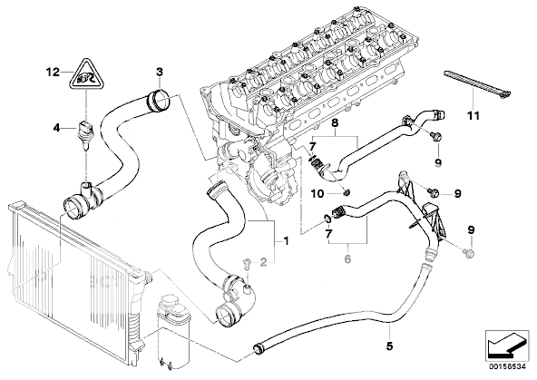

e46jase
i was leaking on my heater inlet pipe (no 8 on pic) hate coolent leaks :cursin: the plastic was brittle on the pipe wer it connected to the head it perished from the heat and o ring was gone
San
Lekker diagram, whats no. 12 & 4 all about ? mine has some dry coolant arount it, but i cant see it leaking...
