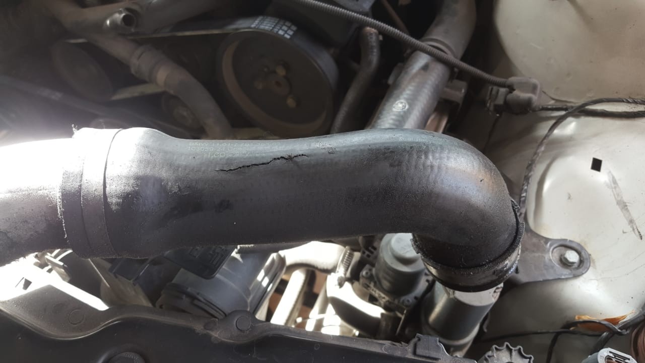

The big day is here - damper pulley is badly cracked, so thank heaven that is being replaced.
Intercooler has a sizeable hole - replaced.
And the one bit of news I didn't want to hear - the boost pipe from the EGR to the intercooler has a hole (explains the massive boost leak)...
These are crazy money and only available from the agents. Would rather spend R9k on a new turbo than +/- R7k on a pipe :hammerhead:

Howzit man - it's the lower part of the pipe (there's the rubber section from the EGR to the metal section, then the rubber section again down to the intercooler). I believe the build date is 09/2003. Pic below:

Eish bru.. That one i had from the Black 320d Donar car i had. That i sold for 1k.
I only have the pipe from the 10/2002 Build M47N
They had different intercooler/piping setup
pipe i have is like this
I will keep an eye out for one like you have and PM u if i find sumone who has

Ah that would have been perfect - my mech mentioned that the setup changed between the years.
At the moment we're working on an interim solution - cutting the pipe and using an aluminium section with hose clamps to join the two "untorn" parts, just to hold boost for the time being while I source another pipe. Will have to drive gently because the first time I ask for too much boost, that will shoot loose.

You can weld two "lips" on the connector piece so the clamps dont slide off
