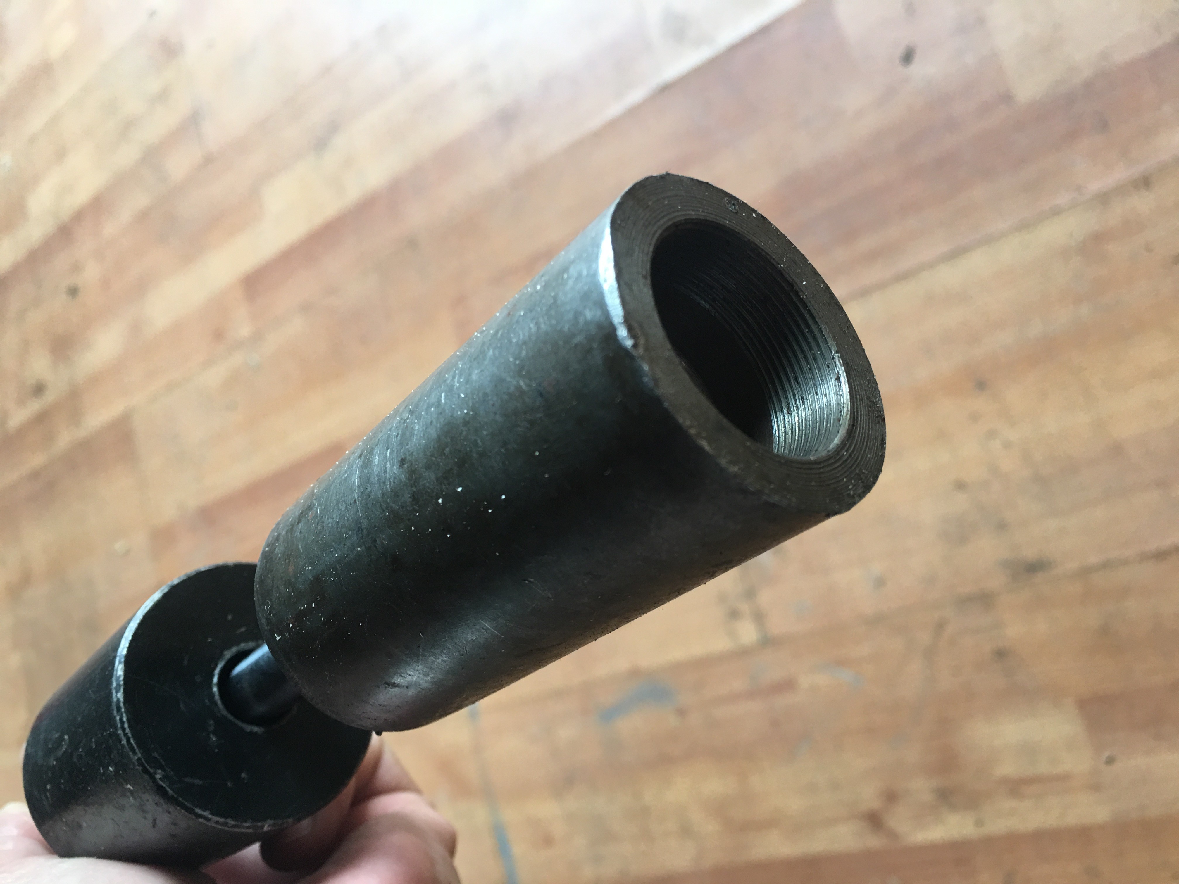

Hi guys
Quick update, eventually decided to remove the solenoid part from the top of the injector and basically destroy it to get the nut from it. Built a sliding hammer using the nut at the end of it, and after 3 weeks of brake cleaner, loads of very difficult patience (and swearing), the injector came free this weekend. Got a second hand injector for a good price, installed it and recoded using INPA. My Beemer is alive again and running like a dream :smilebounce: . Next up.... to the car wash we go hehehe
I'll upload some pics of the tool later today.

Thats Good News bud. Glad you got it sorted..:thumbs:
