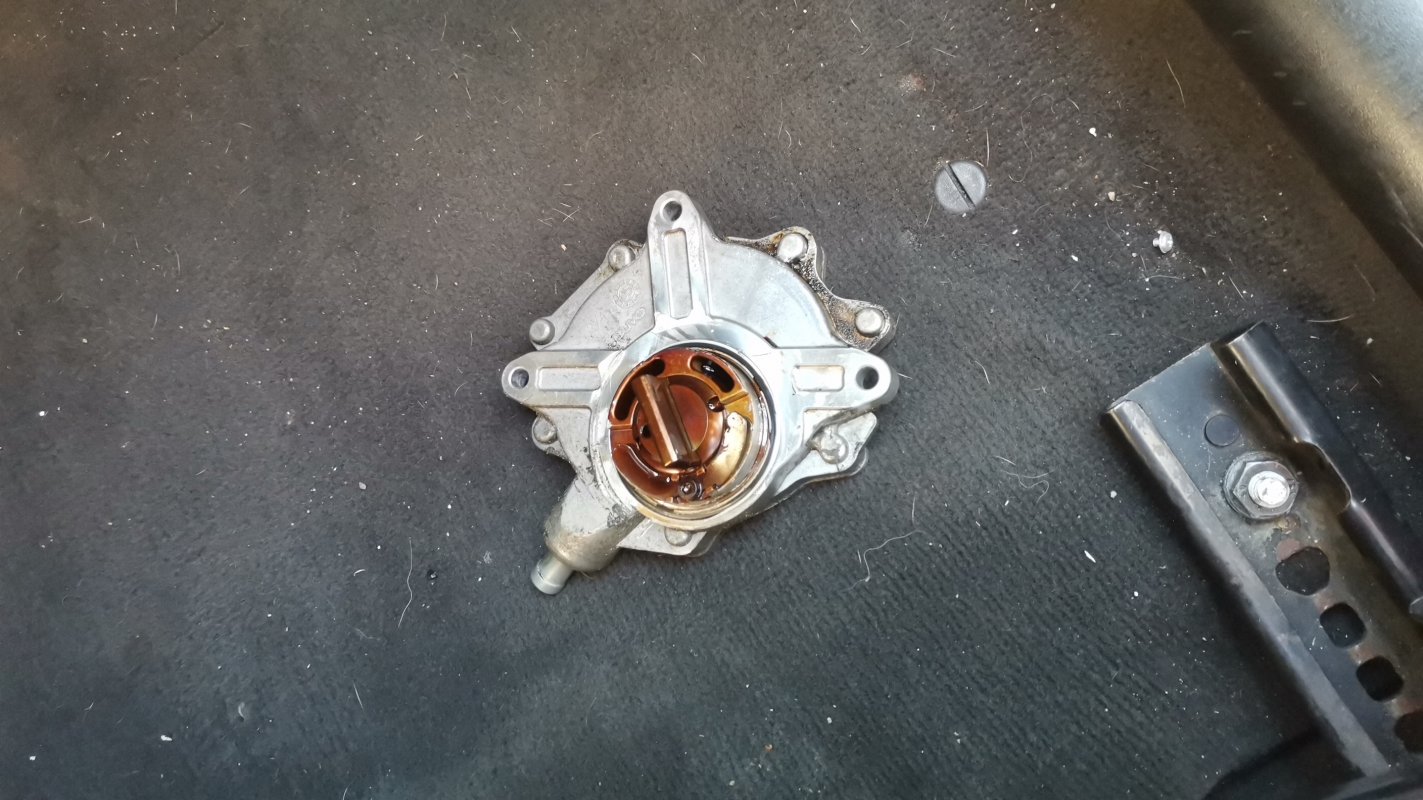

Hi. Thanks for the info. I removed the vaccum pump. A bit tricky as there is very limited space to work in. There was oil in the pump. So we cleaned it and replaced the orings. Got this from bmw . Fitted everything but still the same. It seems like there is air coming from the brake pedal side of the booster. Makes a swooshing sound when the car is idling and the pedal is pressed. So I will have to see for another booster.
