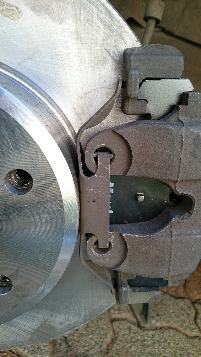

However after fitting the disc and assembling everything it was obvious that the hub was rubbing up against the retaining clip:
Everything else was 100% (wheel nut holes / disc outer diameter / hole for small screw that hold disc in place), so I decided to leave it and see if it would cause a problem.
Of course there is a problem. The grinding noise is horrendous!
I am taking the discs back, but before I do I would like to know I am correct in assuming that the discs are at fault, and that maybe I don't need a new retaining clip instead?
spawn616
discs are at fault
the reason is that there are different models and specs and what we get in sa is not always what is specced on the parts broker pc,
ate pads are also slightly longer on some of our models so they metal frame hits the brake disc at about 35 percent life left,which isn't really an inconvenience but you don't get full life of the pad
i have ate brakes(discs and pads) and the retaining clip doesn't touch

Yup. I went back to Midas today. We re-checked it and they said they will look for a replacement. In the meantime I will put my old discs back.

so guess what
yip my discs are wrong my feb discs and very badly used ate discs are 324 mm my new ate are 324 apparently but the disc is cutting into the caliper,its like a mm to big
this has to stop .pay back the money oh wait wrong complaint haha
but still :smashScreen:
atleast i have a spare car while this gets fixed don't know what the solution would be

spawn616
it was a quick fix, part numbers match but disk was indeed wrong,
have no idea what other car has the same brakes as the e39 but what ever ,all sorted now
