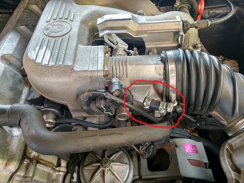

Hi
I have 1994 E36 318i (M42B18), I have a blocked off pipe in what I think is the throttle body? Have attached a pic.
Does anyone know why this was blocked off, and what it does? I'm assuming it's a vacuum hose?
I have seen other pics of this engine so I know that it's supposed to go somewhere. Not too familiar with the car, it's a family members old car, only major work that I'm aware of was the head gasket getting done a few years ago.

hi, it goes to air filter box,just remove air filter box you will find the connector,its a vacuum pipe....

Thanks, do you know why it may it have been disconnected? Should I be worried?

the reason why mine was disconnected is the connector down there at air filter box was broken so my mechanic just cancelled it,but doesn't affect the performance...

Thank you, will take a look
