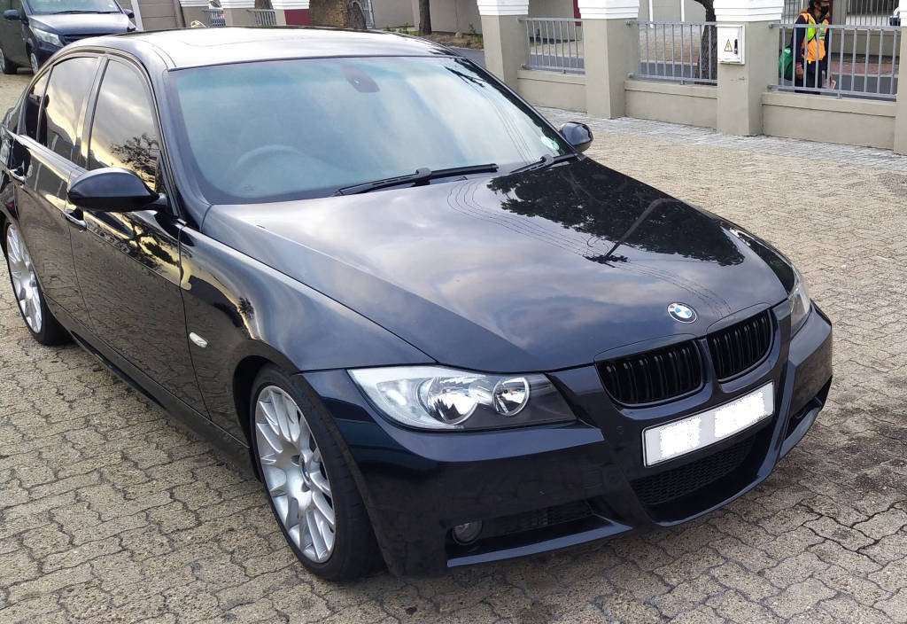

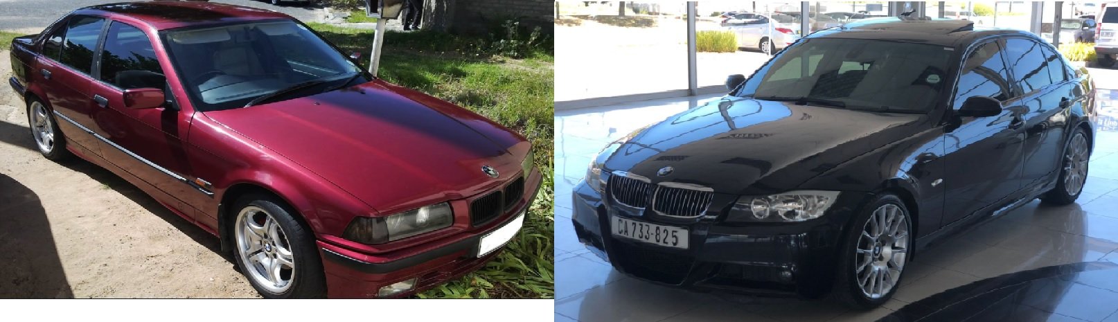

I have been driving my E36 318i a/t for about 12 years now. She is old, sick, tired etc. I figured the only way to get her sorted would be to leave her with Fritz to sort out the mechanical stuff and then my cousin who is a panel beater to sort out the paint, interior etc. My delay were mostly funds and I would need a ride to be mobile. So yesterday I bought a E90 323i a/t. It is the individual I think and has the sports package I also think. The selling points for me were the spotless condition, low mileage 65k, some other things and yes the start button. Never had one of those before. O yes it has full service history and were services 2000 km`s ago.
My question is for now, as a new E90 owner... what are the first things I should do? O yes I were thinking of swopping my wheels, but not sure if it is a good / bad idea?

Congrats on the new wheels. I also went from a E36 (1994 318i) to a pre LCI E90.
Honest opinion, i would keep the wheels, they look great

Congrats on the new wheels, if memory serves me right, that kinda looks like Style 216, which if it is the case, is a BBS wheel
nazzeem
Ok. Yes I saw BBS I think on Google, but thought since it had the sports package maybe it is something else.

Congrats on your new ride, wish you many safe miles! Like everyone else said, keep the wheels they look good.
