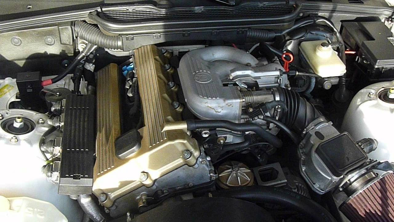

Hi guys,
i recently did an engine swap on my e36. i replaced my m43 with and m42. i am using my old ECU and the car starts and gives on erratic rev and then cuts out... if i try and give petrol it tries to idle but smothers out
Any idea what it could be?

You need to run the M42 with the M42 ecu. What issue you are probably running into is the M43 probably has EWS and the M42 does not. Did you get the M42 with its "barn-door" air flow meter?

Motor came with its own MAF and ecu - but would not start. When i changed to the cars's original ecu it started up and im able to rev but then cuts out. I take it this is due to the ews...

Barn Door style MAF/AFM
Bottom right corner, behind the cone filter

Yes it came with one like that...
As gizmo said, run the M42 with the M42 ECU.
It's kinda like asking an 325i ECU to know how to run an M3 motor... not going to end well

Okay, but i tried that and it would not turn... i have a feeling its coz of the EWS - should i have this bypassed? First of all can it even be done??

M43 ecu is not designed to run the M42 as the AFM, ICV and a few other sensors are completely different with different resistance values. The fact that the M42 started on the M43 ecu is amazing.
Perhaps a wiring difference in the body harness or something, can't help more without seeing the car unfortunately.
