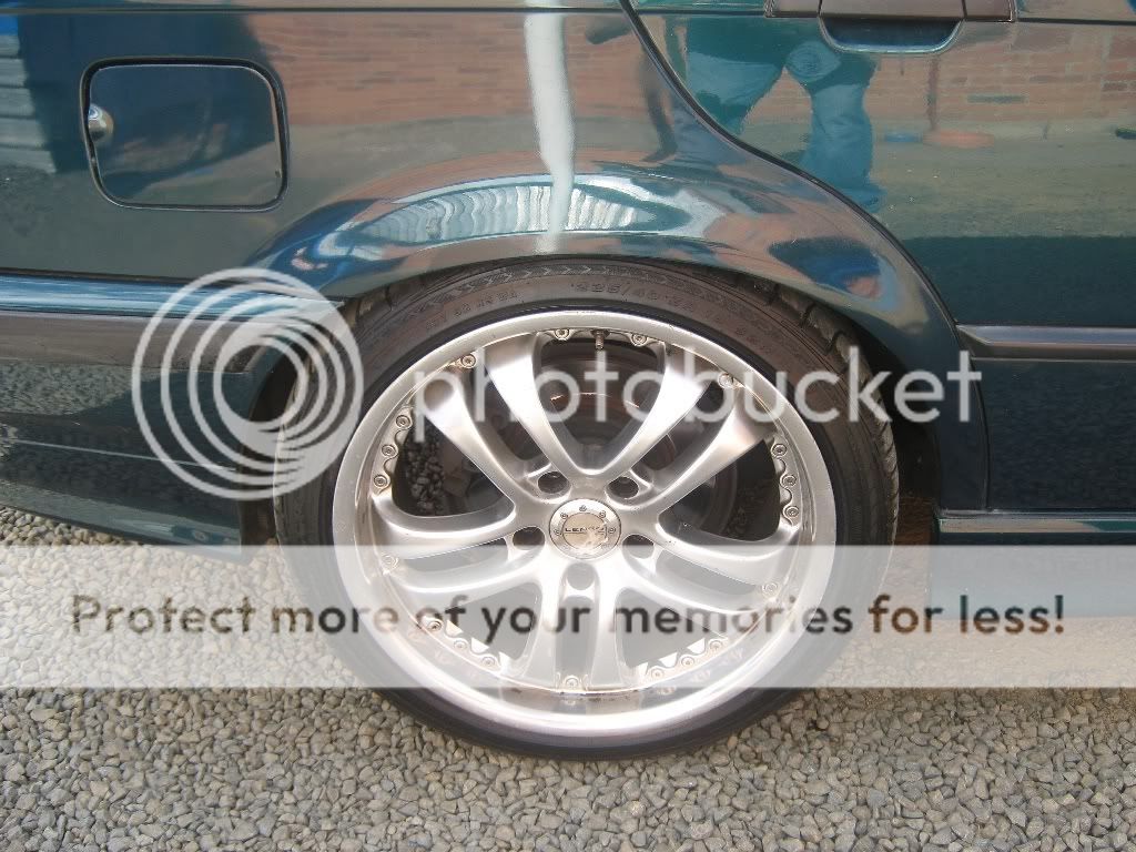

18inch Lenso Rims

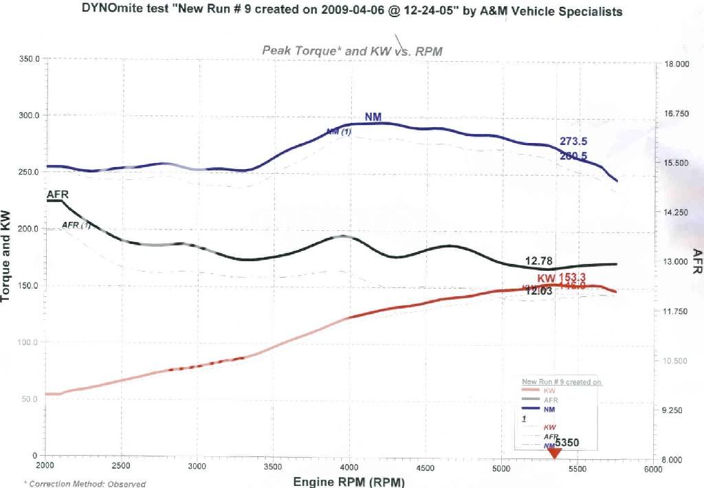

here is my before and after with cams and free flow alone

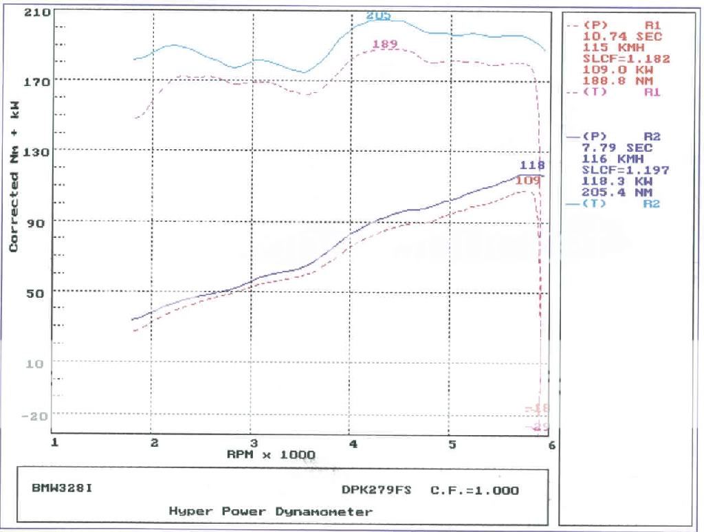

heres my before and after with uni Q remap

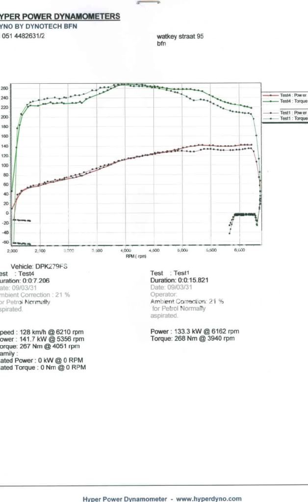

and here my before and after remap with the m50 manifold
at the moment my car is putting out 118kw at the wheels and 205nm at the wheels.This was done at the reef.

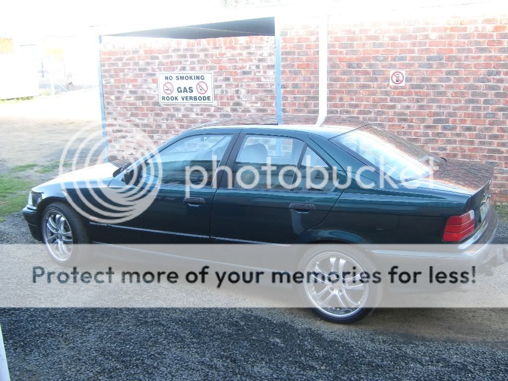

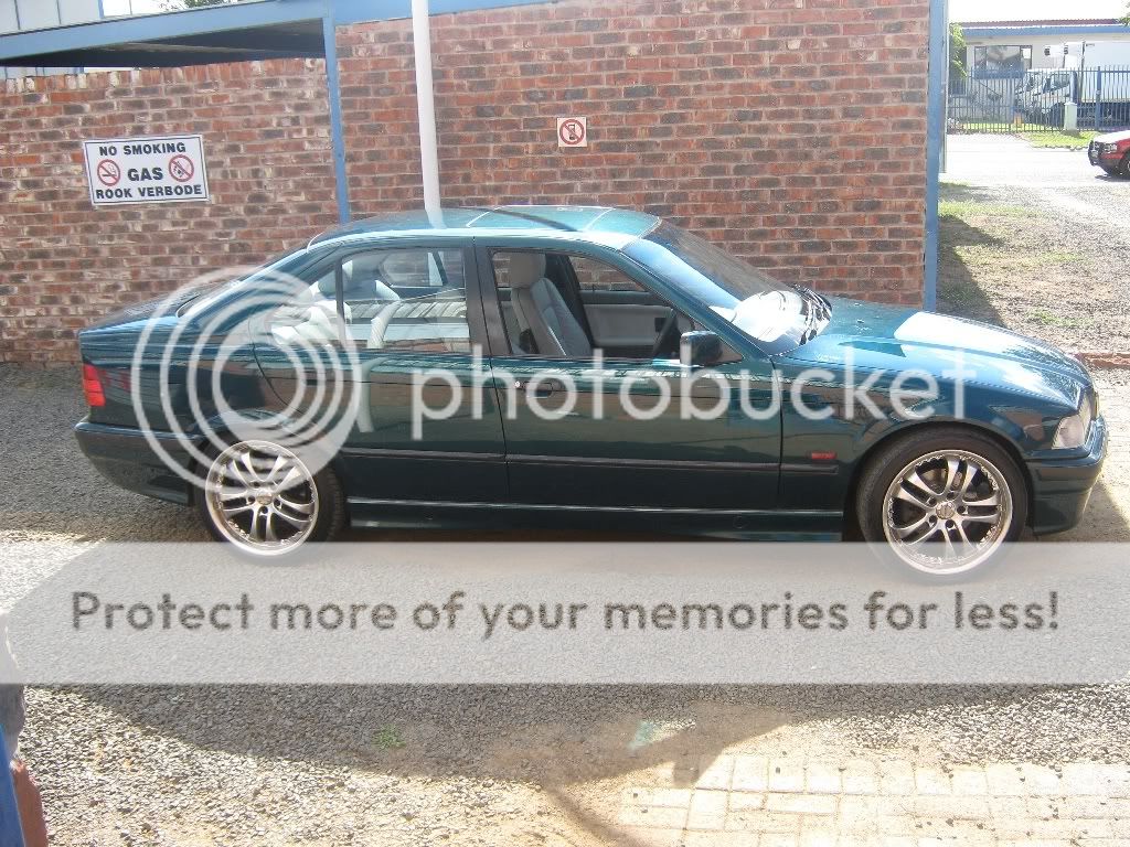

here are some random pics of my car

yes,ive done the manifold install.lekka power on top but you loose some bottom end torque though.I had the unichip done at a&m here in bloemfontein.i installed the manifold afterwards and before remap got 109kw atw then after got 118atw...so yes,nice gain.iam just waiting for my bigbore throttle body ordered from uk....its laying at customs awaiting a permit from me,which i was not aware of because there is some clause about second hand parts...now ive got to wait about another week...k@k hey.
