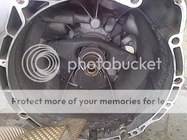

Hi Bud, it does sound like your thrust bearing. You will only hear it in first gear when you take off cause there is no road noise etc. Mine is having the clutch and bearing replaced now for the same reason. Just started one day with a rattling Grrrr sound when pushing the cluth in and releasing. Take a look at the pics and you will see my bearing has completely split apart!
Not a cheap excercise either im afraid, depending on what you change
