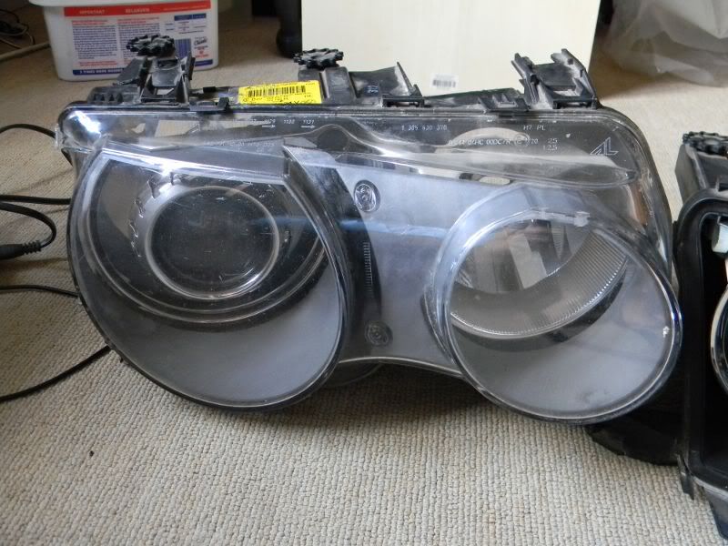

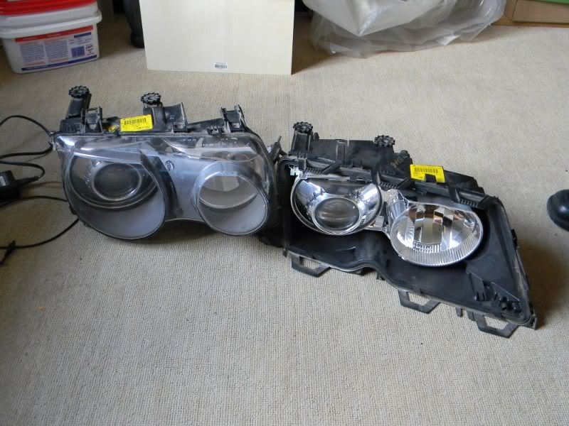

The visit to the scrap yards was pretty awesome and fruitful as I came back with this:
Yup that's right, that's a xenon headlight from a e46 ti
I am pretty chuffed with my find :) (Now it is onward with with my super-awesome headlight project)

Looking forward to the results of this one, so keep the results coming Sankekur..
The E34 also wants dual projectors :)
