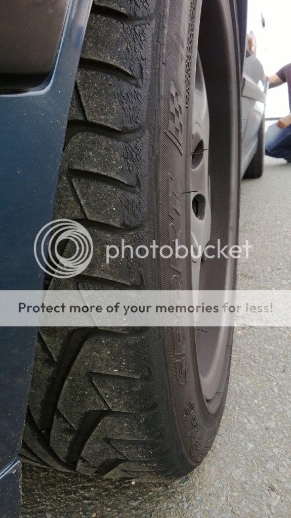

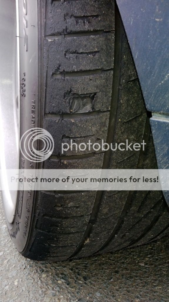

I am personally not a fan of coilovers on an e34 specifically, because of the cutting and welding you just mentioned. Too much of a risk. If it was a bolt in setup, then sure, but I simply dont trust SA people to weld anything on my suspension.
I like the B8 bilstein more than the Koni, but they are substantially more expensive than the Koni, and I dont think the extra cost is justifiable.
The M5 rear subframe + trailing arms only give you a little adjustment range on toe/camber, where all the others are fixed
The vague feel in the centre is a horrible feature of the steering box. No amount of effort or money will ever solve it. The shimmy will probably disappear when you replace the upper control arms.
If you do get your style-5 17" wheels in time, go for 235/45/17 setup all round.
It will improve the feel a lot, because the standard balloon tyres are for comfort only.
Remember that these cars will chew through tyres and brakes when it comes as much as close to track abuse, because of the weight.
This was after 1 day at the track

thats hectic the tyre wear in you pictures:skit::skit:
hectic, is that on the 540i? im sure that power/torque also has something to do with that, but damn..
