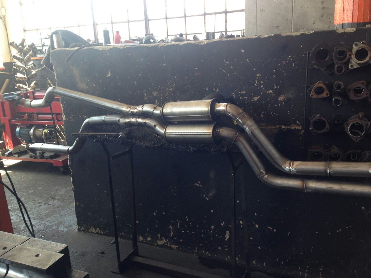

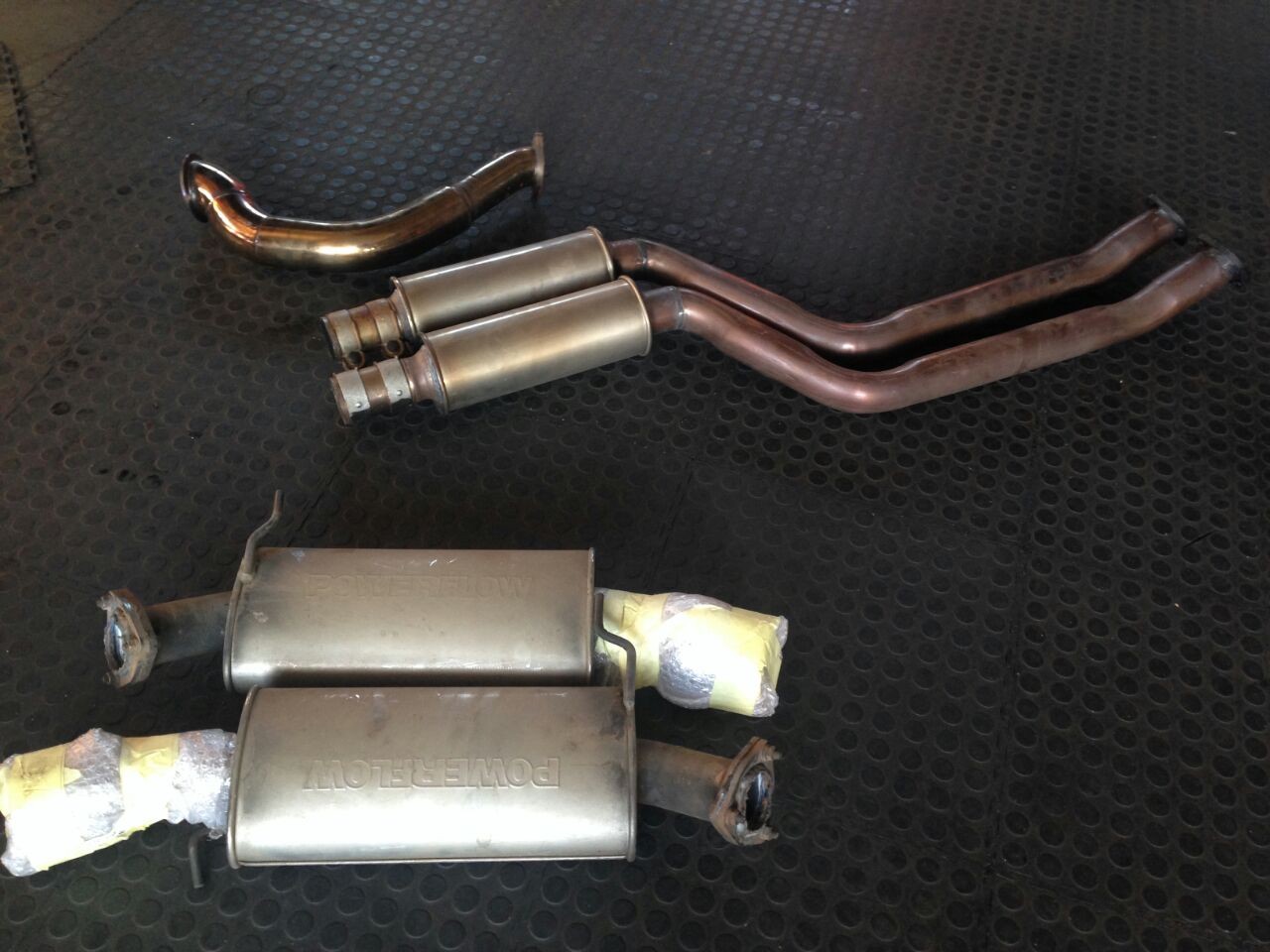

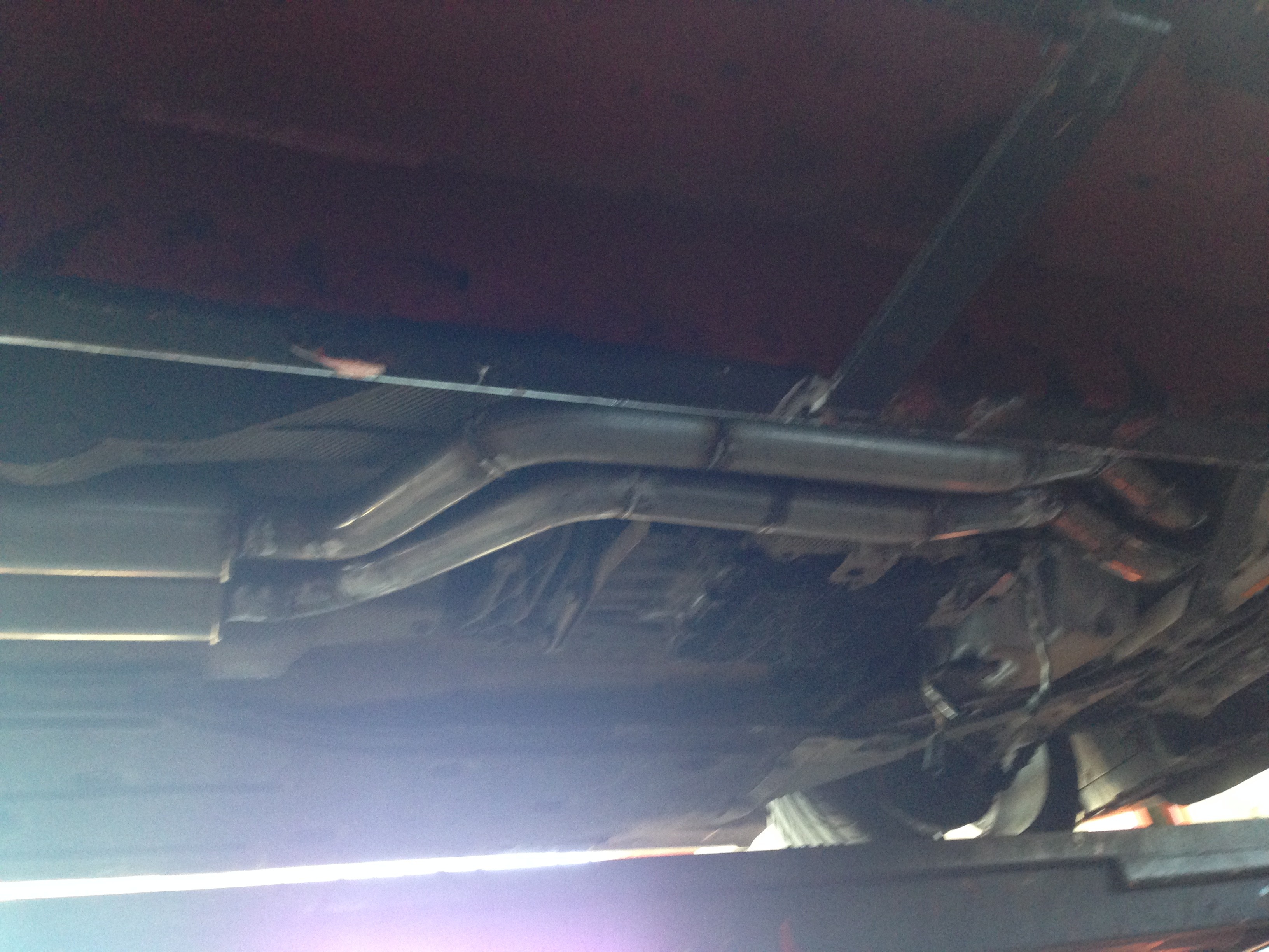

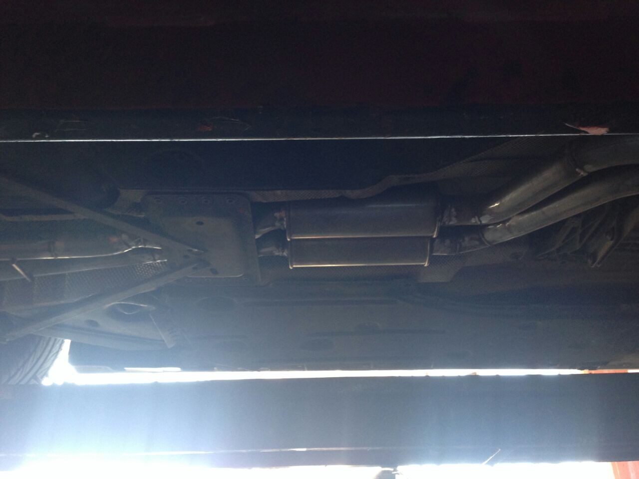

I have a complete exhaust , downpipe to back box installation done on my n54. As mentioned above, there is little to no performance increase with the mid and rear section but it does have a much deeper tone and sounds really nice with the dct box.

No drone, but my rear seat rattles at exactly 2450-2500 rpm...I am actually fitting new tailpieces and going to fit larger rear boxes next Tuesday, I am hoping the larger boxes get rid of that particular resonate frequency that causes the vibration completely.
