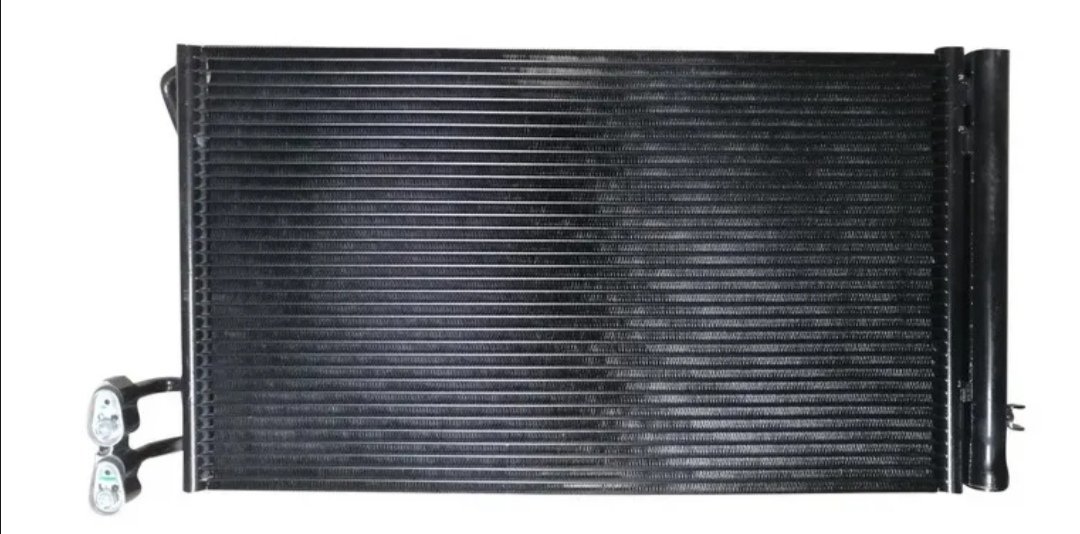

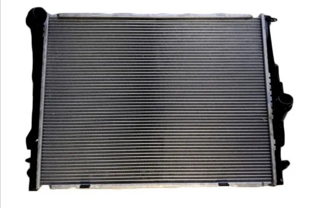

Just remember you have your radiator for engine cooling in front, this is the large one. Behind that is a smaller radiator that your aircon fluid runs through.
Radiator:
Aircon Radiator:
