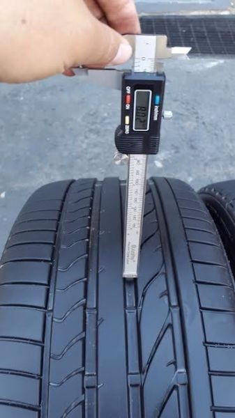

When i traded my OEM 18's with bridgestones with about 70% tread left, he insisted it was 40%, but here he is claiming 95%

Tyre tread:95% left see pic of tyre tread measured

His pic, measured at 8mm tread, no way that can be 95%

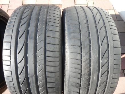

Some pics i found of the same tyre with considerably more tread

While R2k might be a steal for those tyres, i have no clue, why lie about the life left, 95%? That looks more like 40% to me
moranor@axis
if you look in the tread groove it looks like he has removed the 'depth rod' on the verier this is how he is getting his reading
this is open fraud and should be reported so he is removed from the gum
Yep, and look as the tread depth versus the verier's internal measuring points - looks very different, plus even if this was a valid measurement, he's hold the verier at an angle, so it would show a larger measurement than reality, it's almost at a 45 degree angle, or more! LOL

he's being doing this for years .. i know his ads all to well .. gives u kak trade in aswell .. tyre thread should be measured to the marker as once uve hit the marker u liable for a fine ..
as for the vernier .. what he's done is move it a certain distance .. clear the reading ( with vernier still opened ) and moved it more .. its digital so its easy to manipulate the readings .. i work with them daily ...
i would rate those tyres at 2mm max thread ... and on that note .. i would never support the mentioned seller ... our hard earned money deserves better
there is not even a depth rod on the vernier he can just roll it out to read whatever he wants :skit:

i am also of the opinion that thread needs to be measured from the indicator, since it becomes illegal after that....
