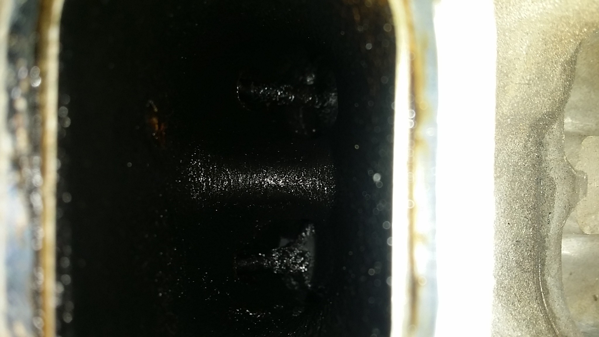

hi all. so i did my Carbon Clean yesterday with Marchand. arrived nice and early, and began stripping, i told him a concern of mine that i believed the Charge Pipe might be cracked, as the night before i got a EML light, and on his reader it showed an underboost error.
During stripping we came across the clamp that connects the charge pipe to the Intercooler was loose, and sweating oil. so a large boost leak was found. Marchand said he will get it tightened once all gets reconnected.
