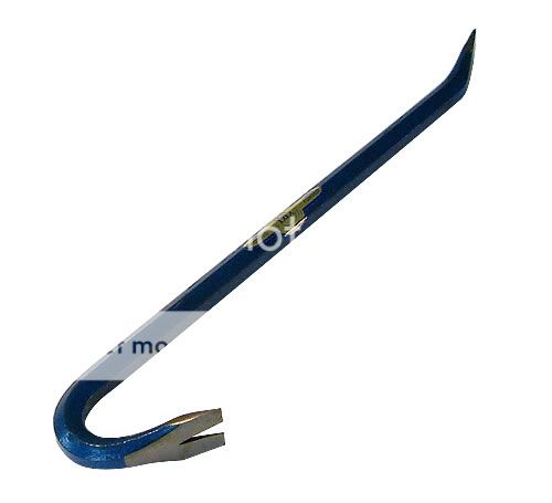

gazza
Spy007
Am not sure if yours have side airbags but I had to take mine out to get enough space to fit my Paw in. Also re clips: I broke 2 but with that sticky black stuff did not tneed to buy. Make sure you have blade for that. Also before you pull it out all the way be carefull of the speaker connection. You need to unclip that as soon as there is enough gap between panel and door.
