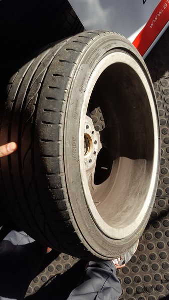

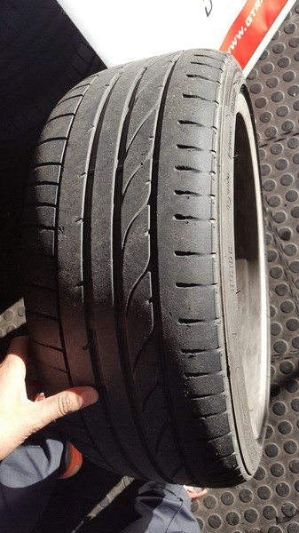

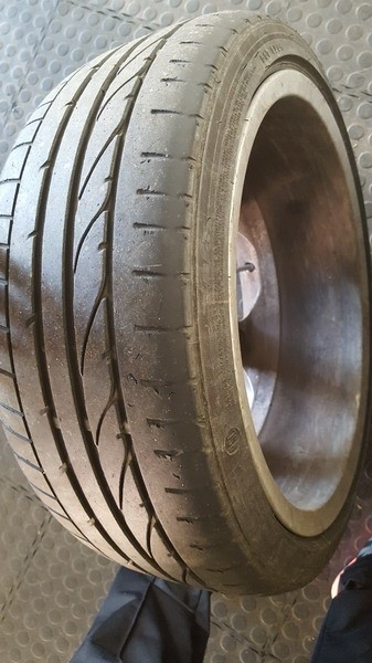

Reason why I am asking is that I have had the same issue with my 135i over the past 4 years. Vehicle has been into BMW multiple times for alignment, they also advised that I must claim through insurance for accident damage, however there was no visible accident damage and no problems with my top shock mount towers. They sent my vehicle to the body shop on a number of occasions, but the vehicle always came back the same, however they advised that it was sorted or there is nothing wrong. I've even sent it to various alignment places, but still no luck. I changed the tyres on the vehicle last weekend and noticed mainly wear on the shoulders of the old tyres, the centre of the tyres still had 4.5mm thread, where as the shoulder had 0mm:thumbdo:
Supaquick (Observatory) advised me that to correct my toe and camber, the vehicle needs to be put on a hydraulic jig at Gibsons Tyres & Alignment to get a more negative camber and to correct the toe. currently my front camber is (R: -0,23deg and L: -0,53deg).
Now that I've replaced the tyres, I'm determined to get it corrected at least to -1deg both sides and 0deg toe with out having to fit camber plates or coilovers.

Here's what my old front tyres looked like after 2 years.
