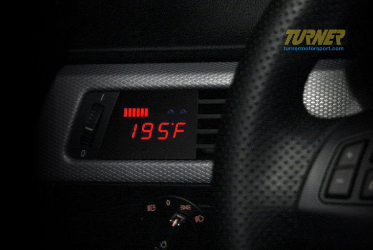

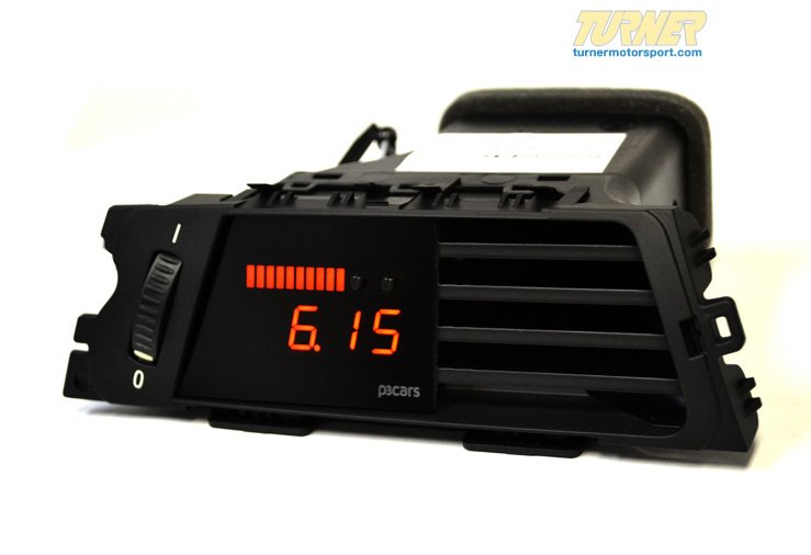

I wouldn’t fit a unit that you thinking off. As you have to tap into your boost pipes which may become costly if something were to go wrong. Rather go for a P3 vent or similar where it taps into your obd port to get all the readings. That way nothing gets hacked up and you have an oem + look . you also don’t look like a boy racer with a random aftermarket gauge chilling on your dash

PLX also do nice OBD gauges I would do that route you will also be able to see more than just boost :)
Nikhil
Exactly. There are a lot better options out there than your traditional style gauges. It costs a bit more but it is worth it. :thumbs:
This is awesome! How many randelas would something like this cost? Obviously motorplan would be affected??
