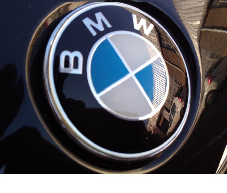

The bonnet badge on my recently purchased 3.0i Coupe was just an alluminium blob. All the paint was gone. It saddens me that BMW cannot provide a badge that can stand the test of time.

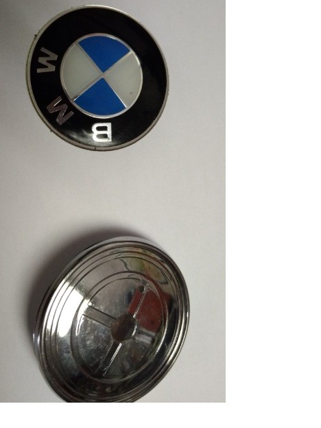

By chance I walked into the China Mall shop where I know that they stock many car badges and the guy sold me this for R150-00.
It is a thin plastic badge cap with self adhesive tape at the back that fits onto the other plastic roundel that you would normally fit onto a E46 bonnet with the two rubber grommets.
The problem is that the plastic roundel is 74 mm and does not fit on a Z4. It will sit proud ..standing out from the bonnet surface.
The thin plastic badge cap (by chance) fits perfectly over the existing badge.

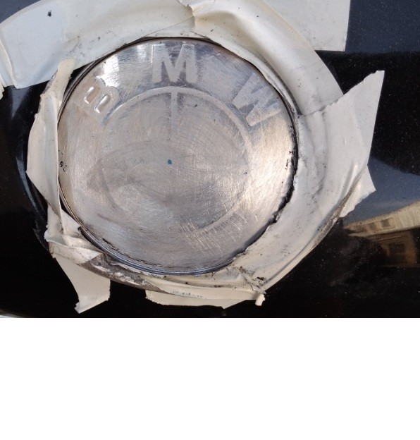

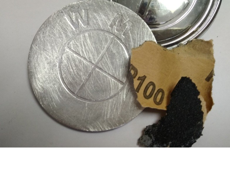

I cleaned the self adhesive glue from this badge cap I then roughened the back end of the badge cap and the existing badge on my car's bonnet with some 100 grit sandpaper.

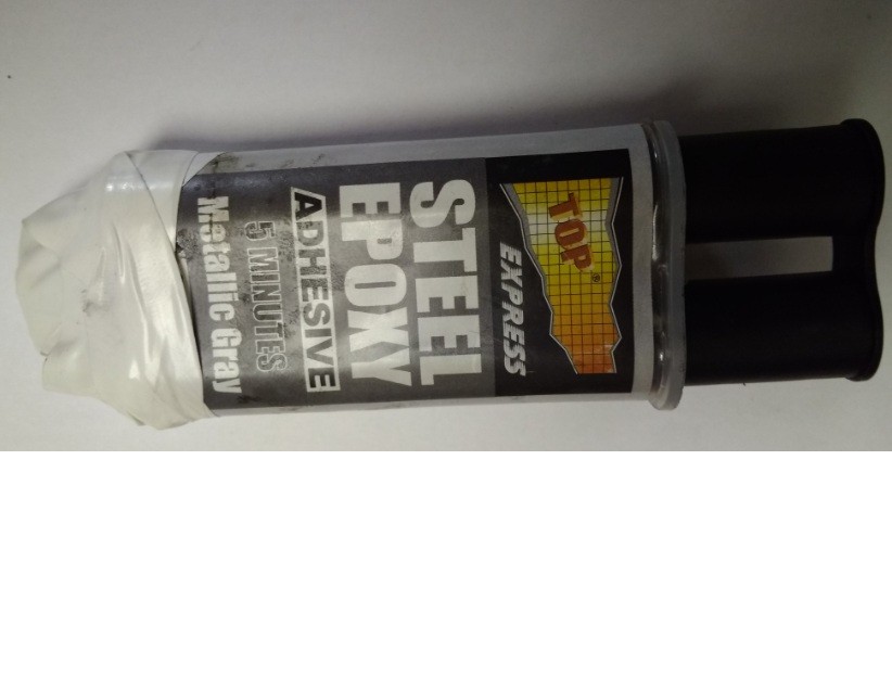

I mixed some epoxy and glued the thin badge cap over my car's existing badge.

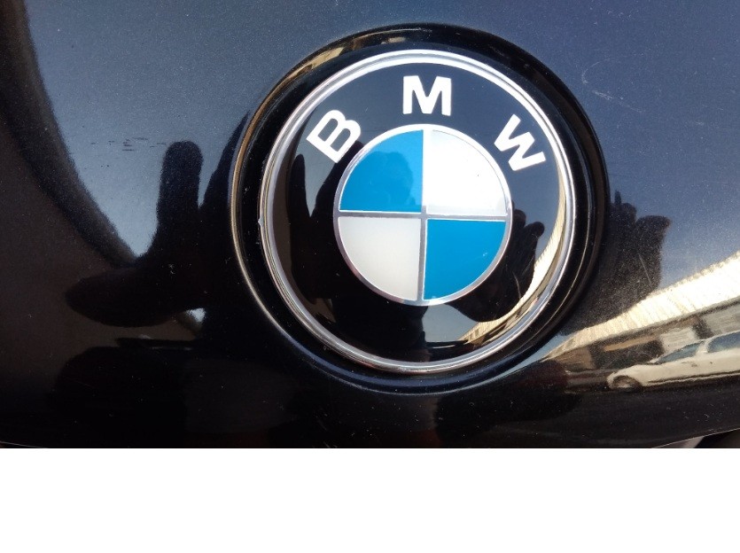

The visual result was close to perfect. I have an Independent BMW Repair Shop as a neighbour and he could not spot that it was not an original badge.
I cannot tell how long it will last , but for R150-00 rand , a blob of glue and half an hour of PT , I am willing to take the change and feel happy that I deprived the dealer of R899-00.
