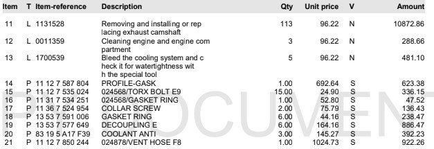

I unfortunately experienced this on my S55 and also thought it to be normal, but my car went in for a service recently and thought i would ask them to look at this noise as well, without giving any more than what i hear during cold start.
Well they kept the car overnight, started it the next morning and the Tech confirmed that he can definitely hear the sound and it is not normal.
Long story short, they stripped the top of the motor, took photos, sent it to BMW SA. Confirmed that it was the Exhaust cam. Replaced some parts and torqued to the correct setting.
Buttoned everything up and confirmed that the sound is no longer there the next morning @ cold start.
