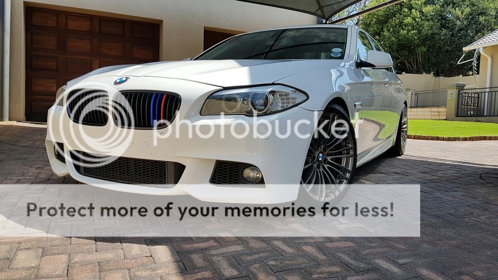

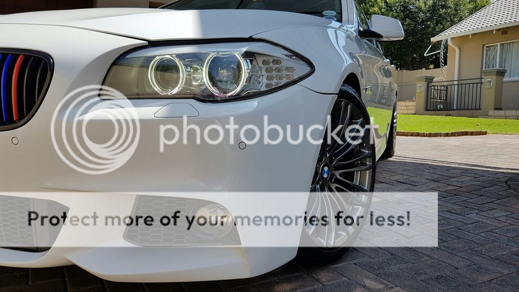

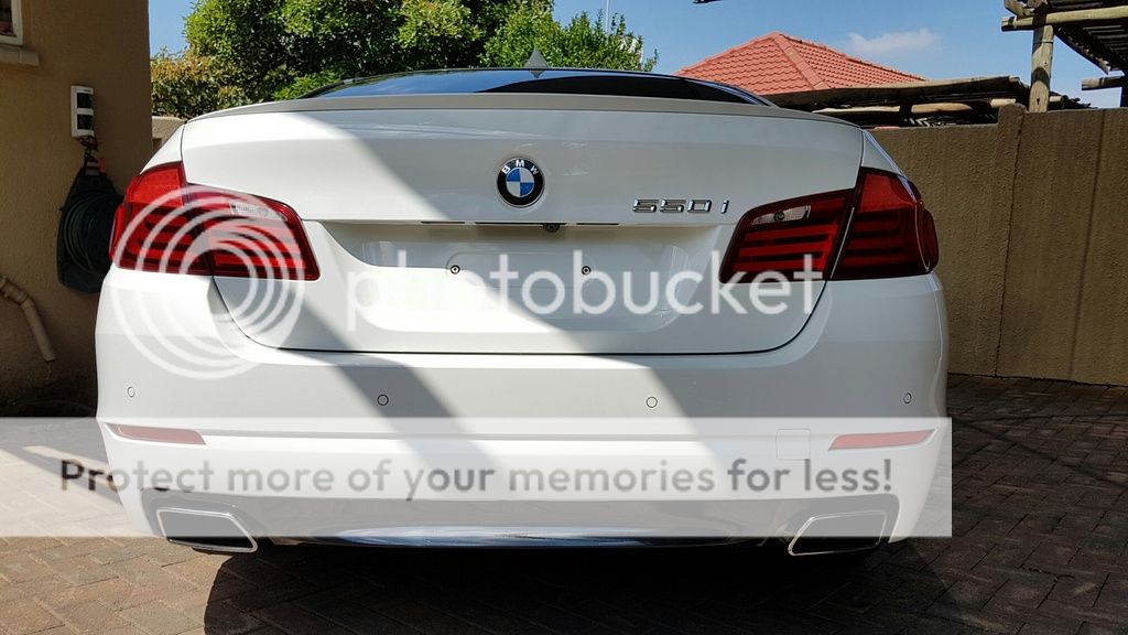

So I have decided to add some detail and pics of what I have done on the car since I purchased. From the original pics I posted, I neglected to mention that the rear bumper was all white and I had the bottom section wrapped in a piano black vinyl.

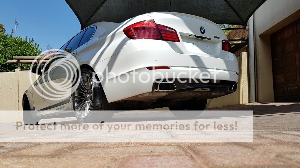

In the middle of all this exhaust tunes, I decided to lower the ride height and purchased a set of H&R springs from Sean (AXIS) which was fitted at Koni SA. Upon removal of the old shocks, it was clearly evident that the OEM shocks had its days and required replacement. Fortunately Ashley from Koni in Boksburg had a set of Koni Sports in stock for my car. I was thrilled because the 550i is always a mission with it being a fairly rare choice.
This is what it looked like:
Handling was drastically improved and the F10 was starting to feel close to my E60 550i handling which I missed dearly. Having said that, my E60 was running on Koni FSDs which are phenomenal.

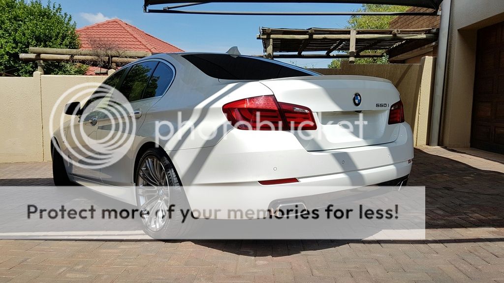

Some pics after the drop. The right rear for some odd reason sits with quite some gap but this was the extremely bad before the drop so I have chosen to live with it.
Decided to wrap the boot spoiler in black vinyl too. No idea why I didn't get it done at the same time that I did the bumper LOL
