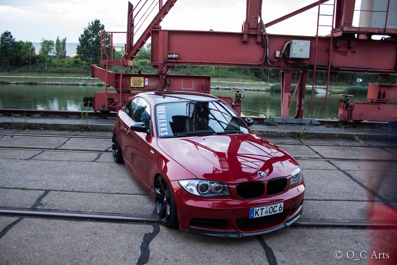

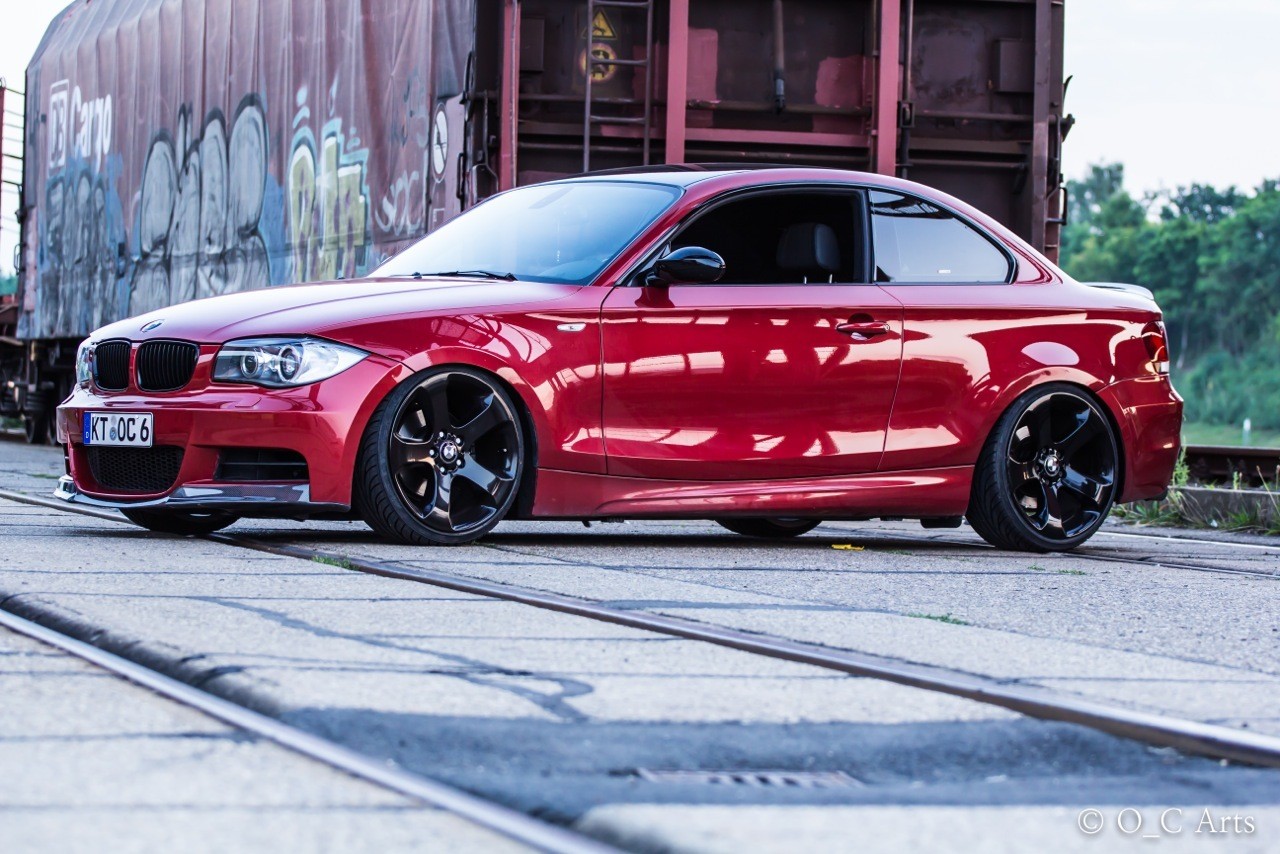

Thank you Mike r for that insight . just to clear i currently run 225/40/18 in front with 7.5 or 8j wheels. and 255/35/18 rear with 8.5j wheels . car is lowered and flush . current offset calc is front et44 and rear e47.(these are of course with spacers) car does not touch nor rub with or without passengers . turning circle is fine .
i want to run 9j in front and 9j in rear . i have seen 9j work in front .See picture below is 9j and 10j rear - fronts 215/35/19 and rear 245/30/19 . et 47mm+5 spacer = 42mm and rear et45 .
my question is . with my set up can i run a 215 tire on a 9j wheel . is this what guys call a stretch and will this be feasible for a daily runner ? i am understanding that 225/35/19 will be appropriate for a 9j wheel up front with et 48+5mm spacer . and rear 245/30/19 or 255//30/19 with 9j wheel and et 48 .
will these rolling diameters be the exact same the 18 inch set up ? i do know that i probably will have to roll fenders slightly to accommodate the 9 j wheel .i should be fine if offsets are within or close to oem spec right ?

FerdiBotha said:
Have a look at the recommended tyre sizes according to rim widths. 215 on a 9J is a big stretch and I wouldn’t even consider it.
http://www.tyresizecalculator.com/charts/tire-width-for-a-wheel-rim-size-chart
i agree 215 is way to small .
http://www.tyresizecalculator.com/tyre-wheel-calculators/tire-size-calculator-tire-dimensions
255/30/19 or 245/30/19 are almost identical to 255/35/18 wrt tire diameter, circumference and revolutions . with the height in sidewall lower on the 19s
225/35/19 are almost identical to 225/40/18
so if i was going to run these 19s i will use 225/35/19 (front) and 245 or 255/30/19 (r) to keep all in balance ?

Off topic I know but this setup looks gorgeous!
