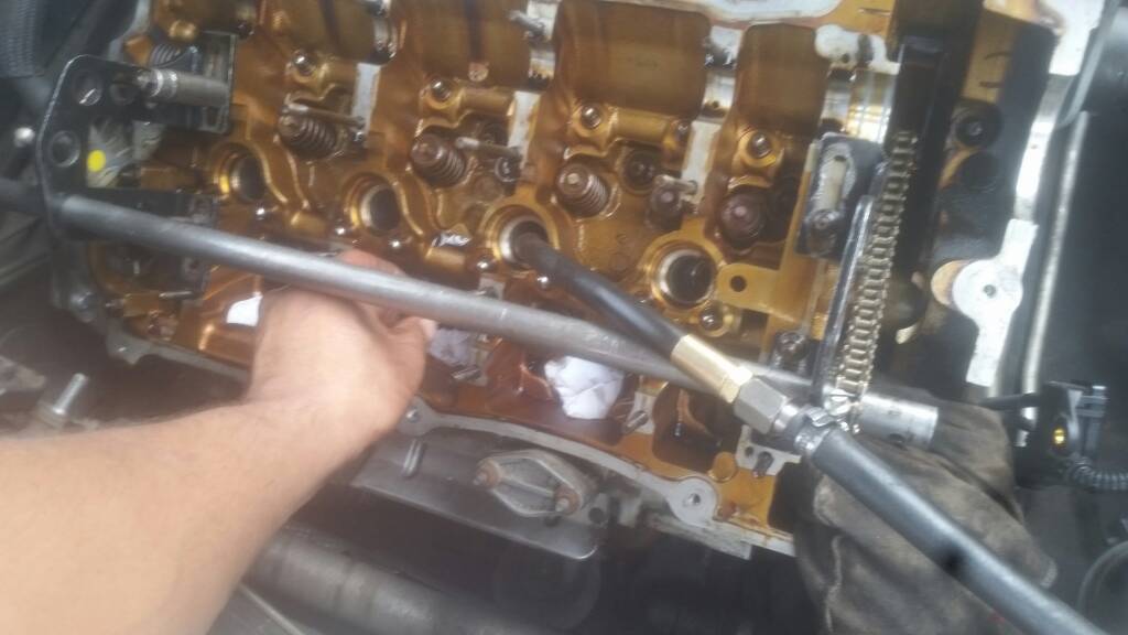

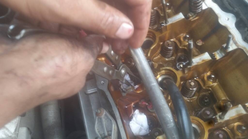

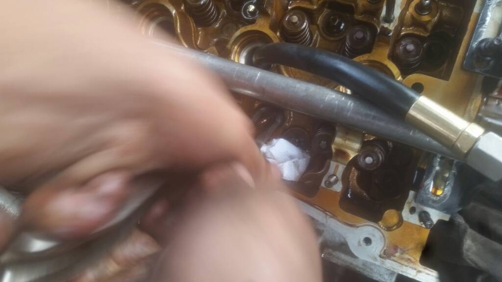

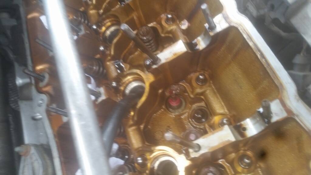

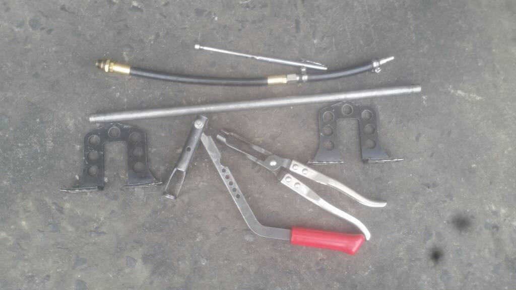

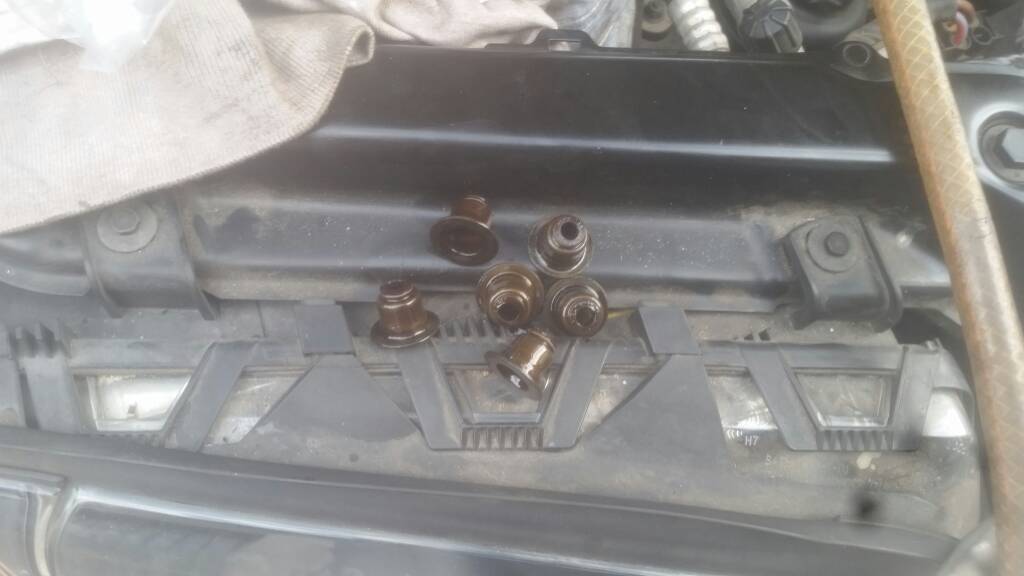

So my buddy came round and loaned me the tools seeing I had a stem seal job, removed the necessary and proceeded to which was quite an 'easy' job to do, with the right tools of course lol.
labour took me about 4 hrs but way better than removing the cylinder head, end result, no more white smoke, just thought I'd share some pics

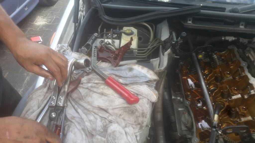

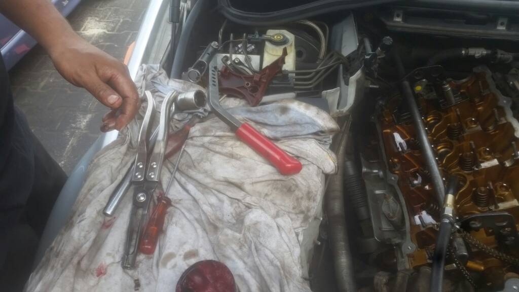

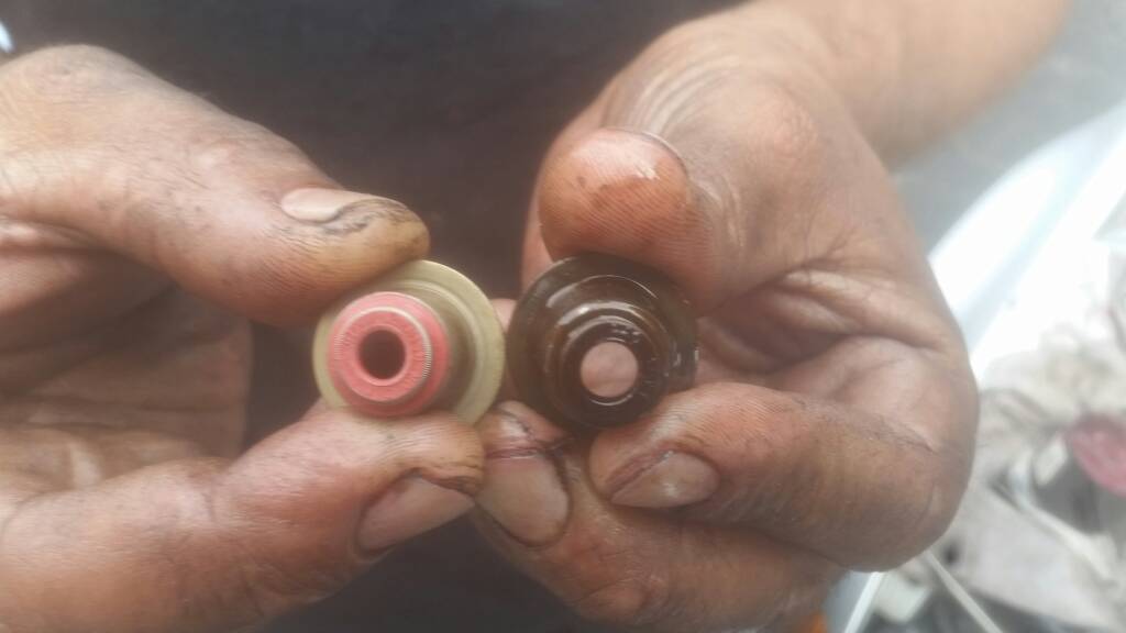

couple more, one of the kit and another to see the difference between old and new seals.
