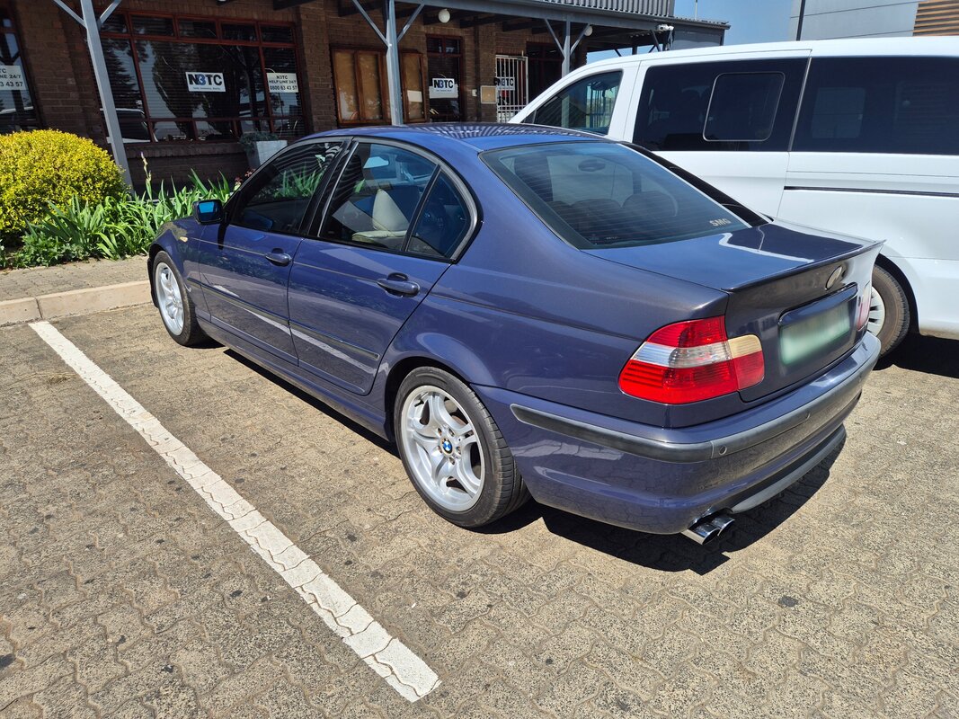

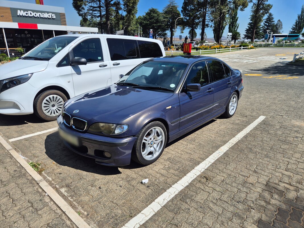

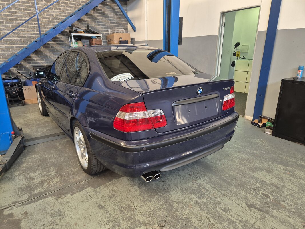

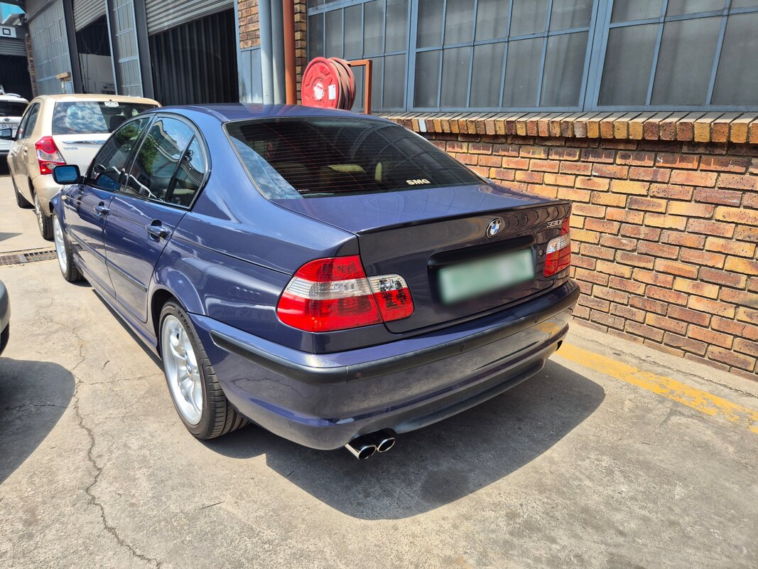

A couple of pics on the way back from PMB to JHB.

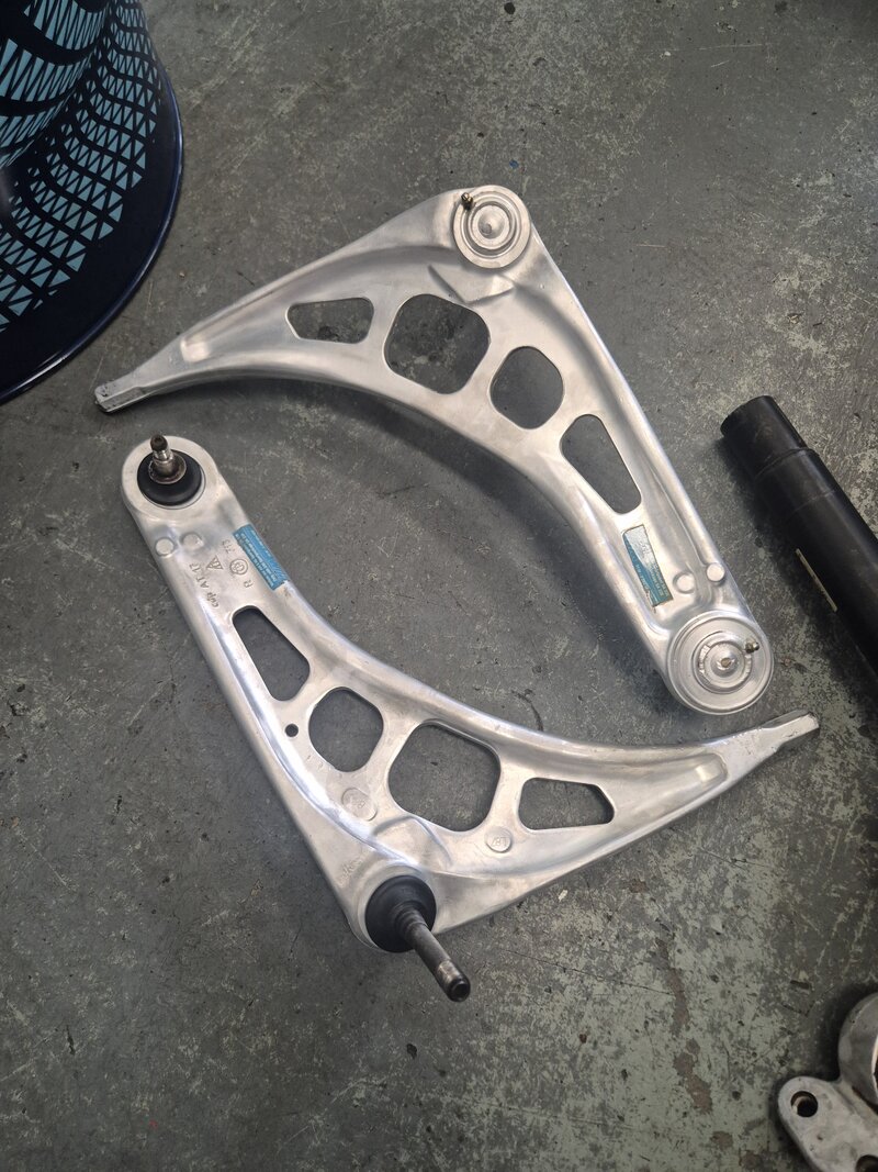

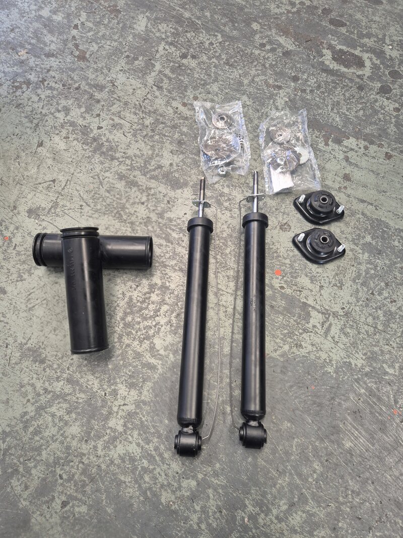

Suspension stripped, replaced the rear shocks and shock mounts.

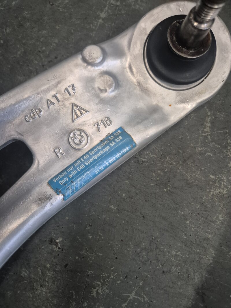

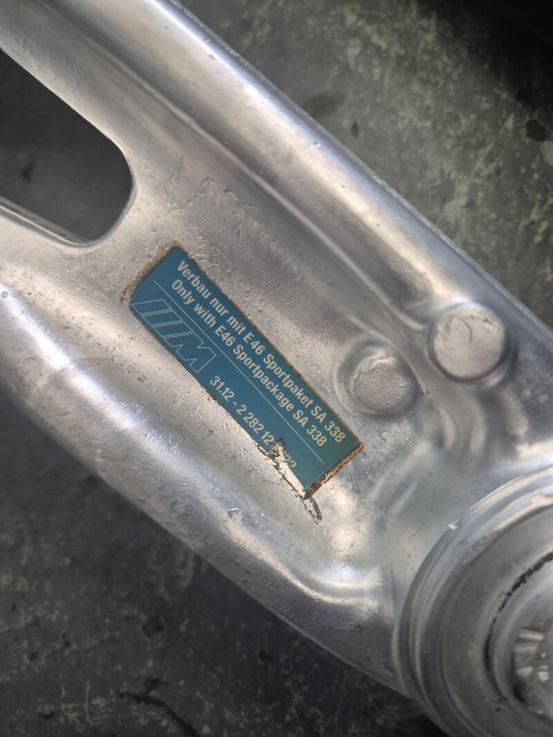

Note the control arms with there original part number stickers on them. This is something i wanted to try and preserve so opted to get the control arms reconditioned instead. Westrand balljoints did great work reconditioning them with grease nipples so that they can be serviced anually.

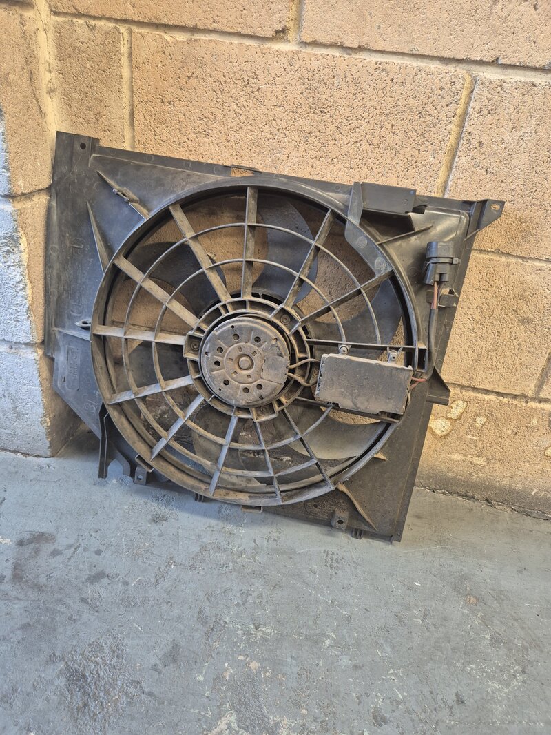

Replaced the electric coolant fan as it was working intermittently which caused the car to overheat while idling or in traffic.

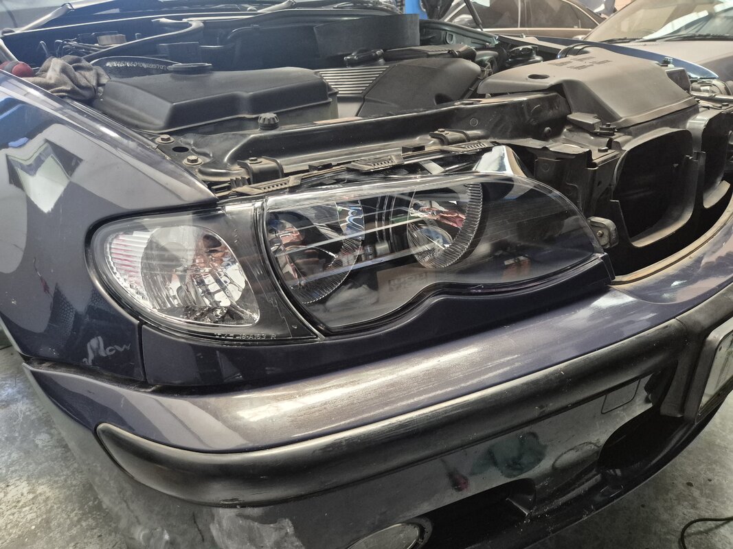

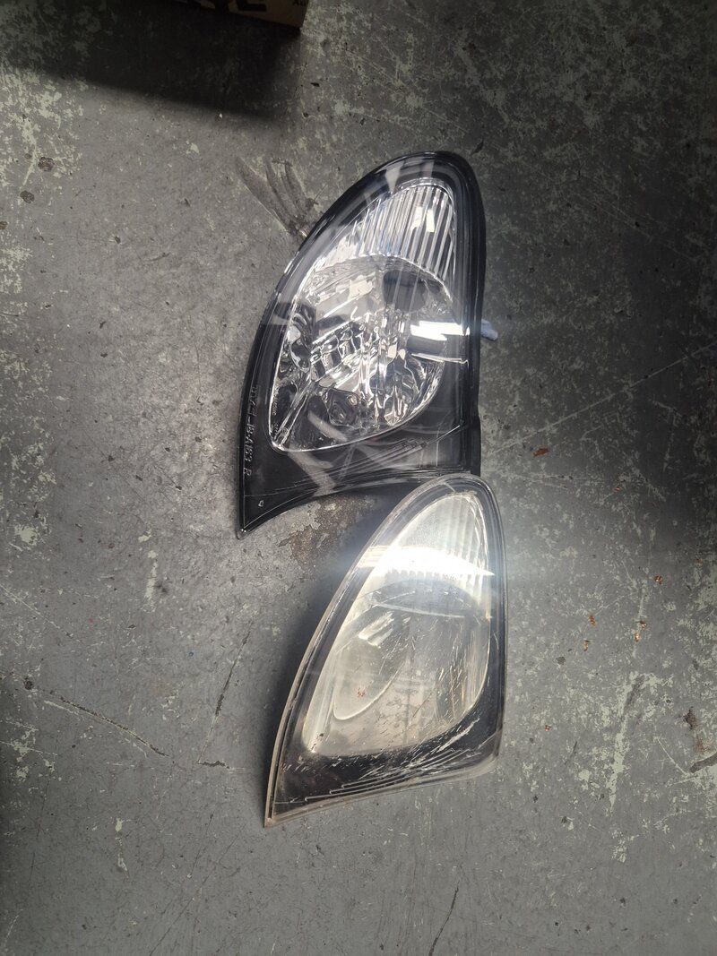

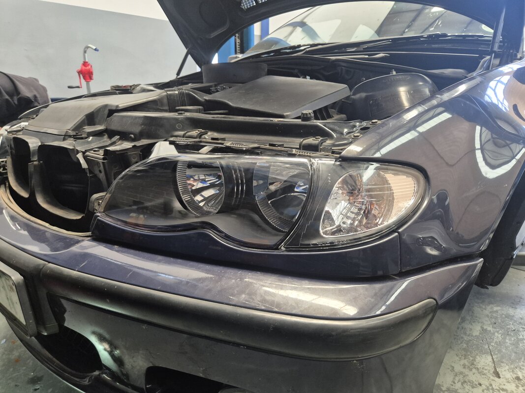

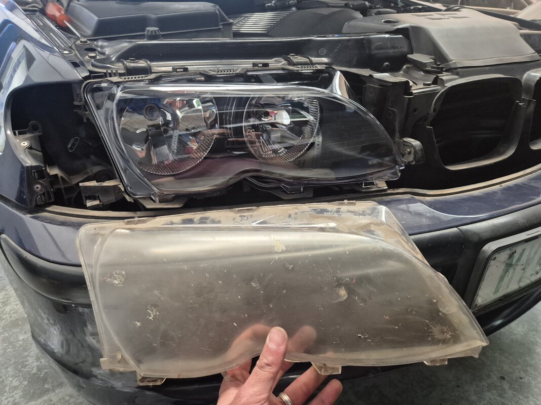

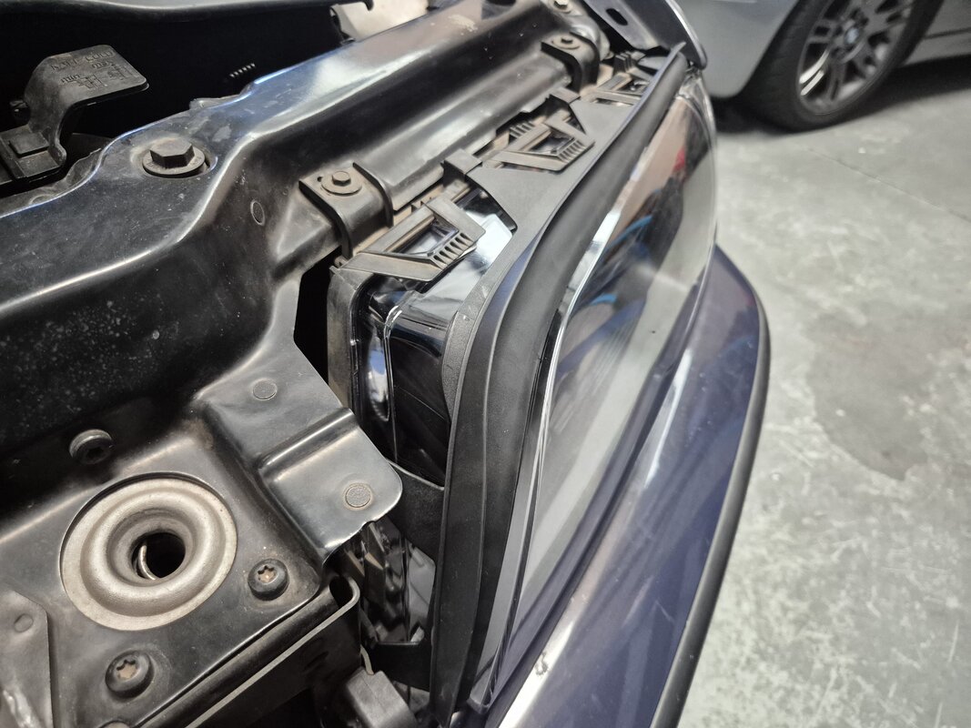

Replaced the headlight lenses and fitted a set of new indicators up front.

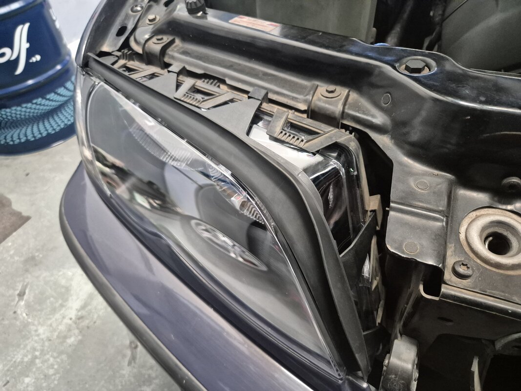

New headlight rubber sealing gaskets

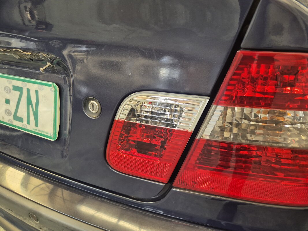

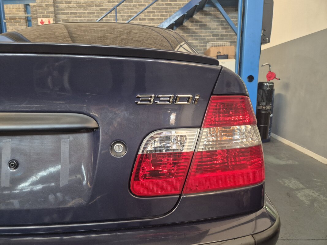

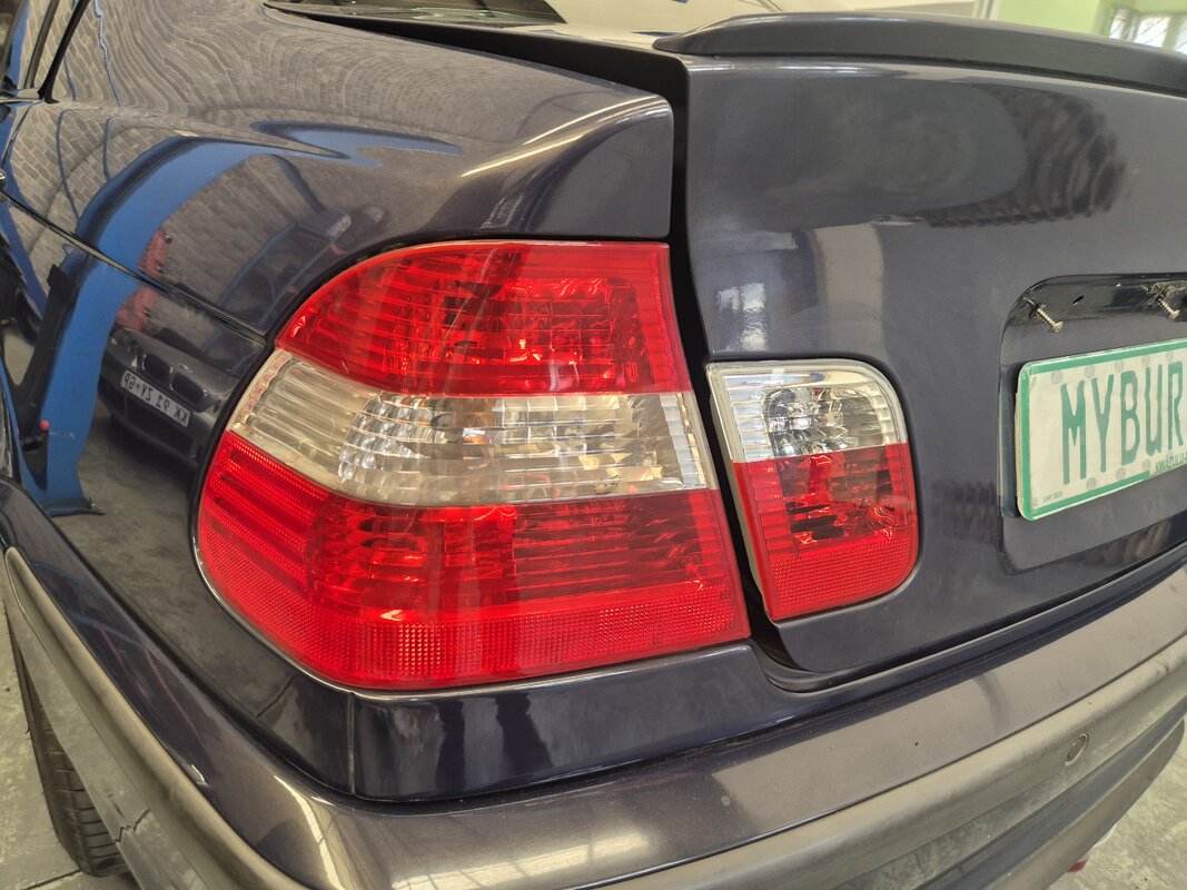

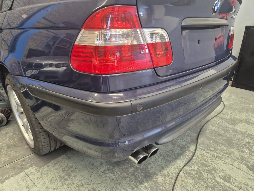

New inner taillights fitted

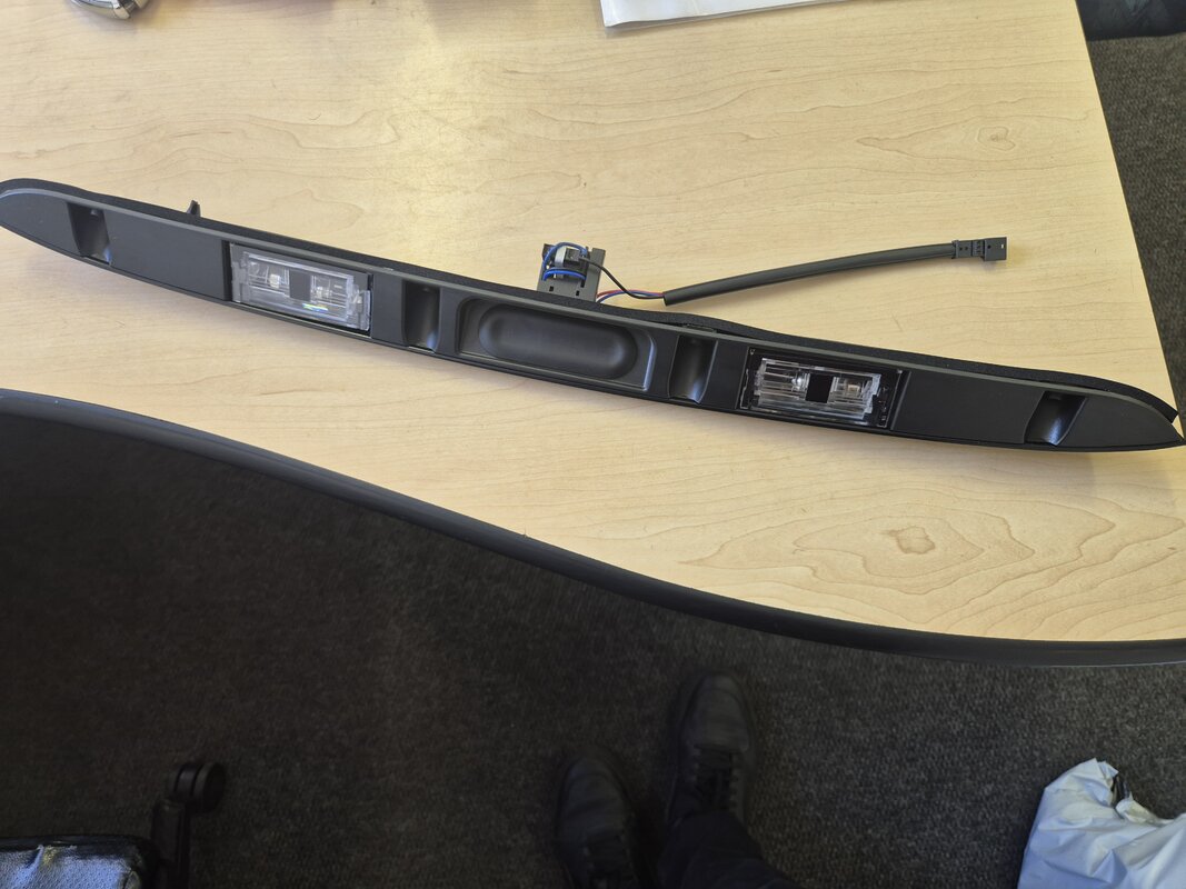

Rear boot latch button and trim replaced

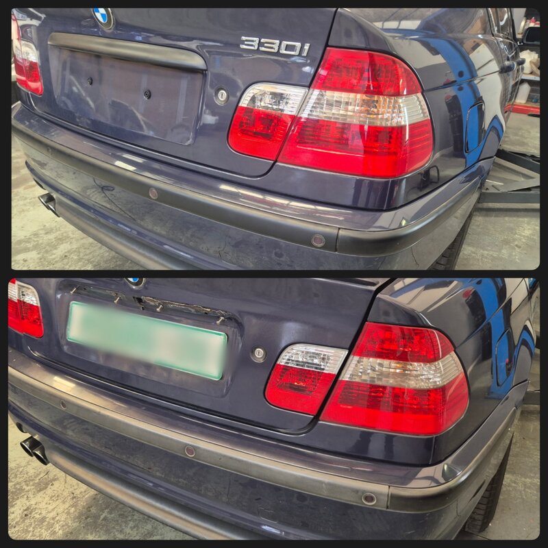

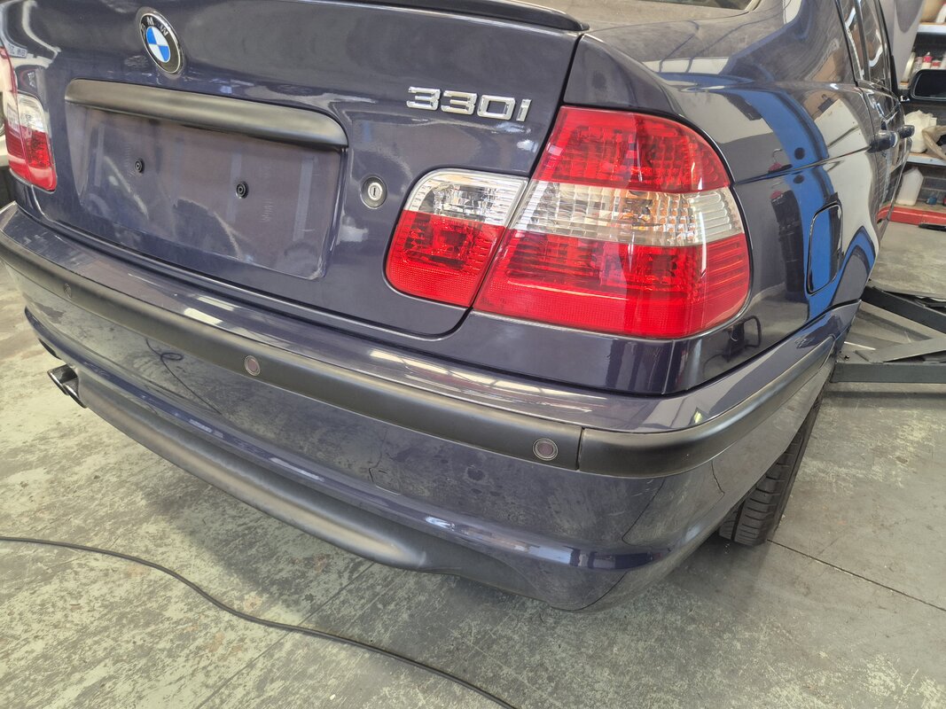

The 330i badging was missing so fitted a new one
The rear trims were also a bit faded so decided to use the old trick of using a heat gun on them and it worked a treat.
Before and after pic below

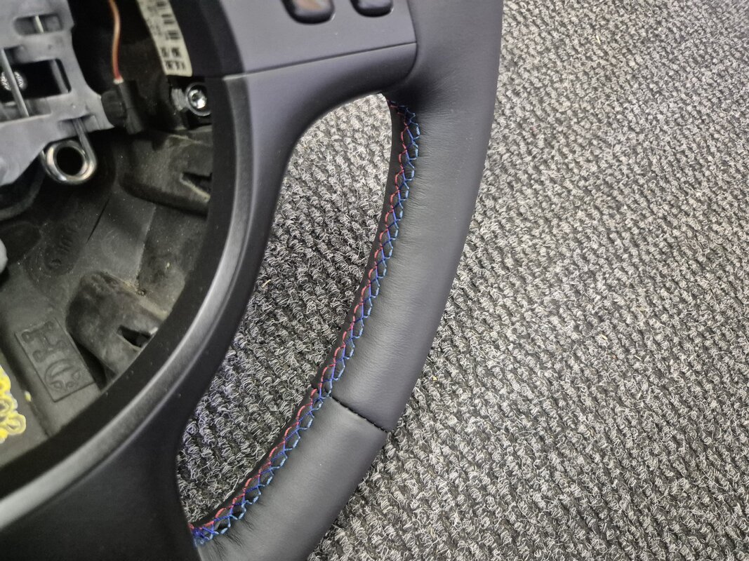

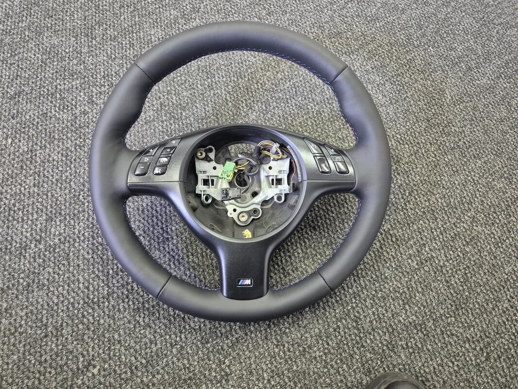

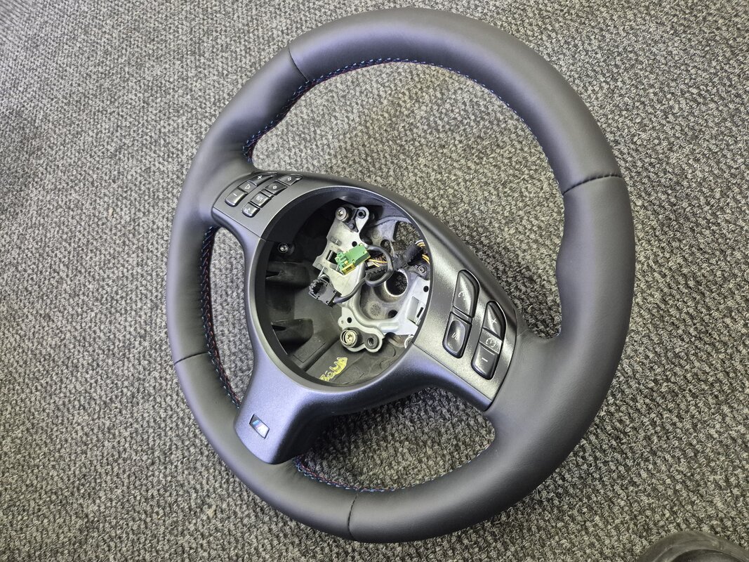

Steering wheel recovered and reconditioned with "M" stitching and also bought a new ZHP gearknob for the car.

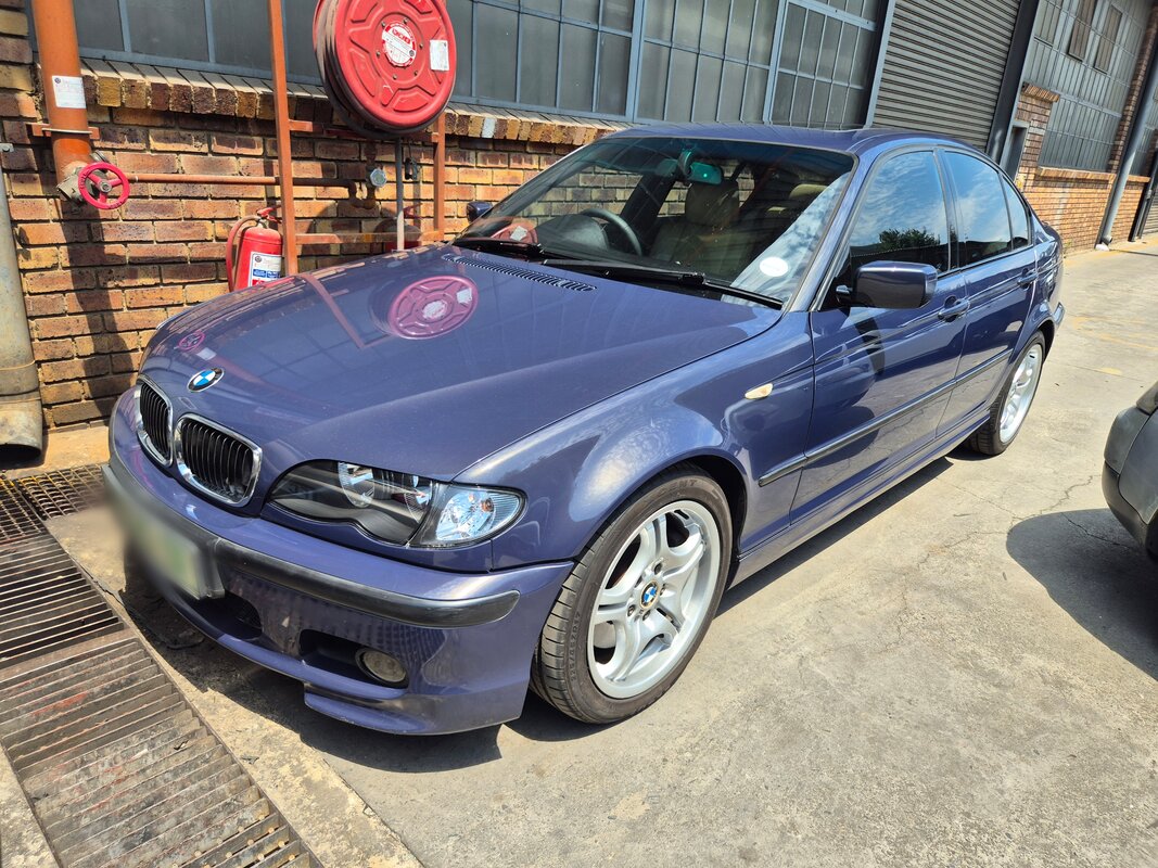

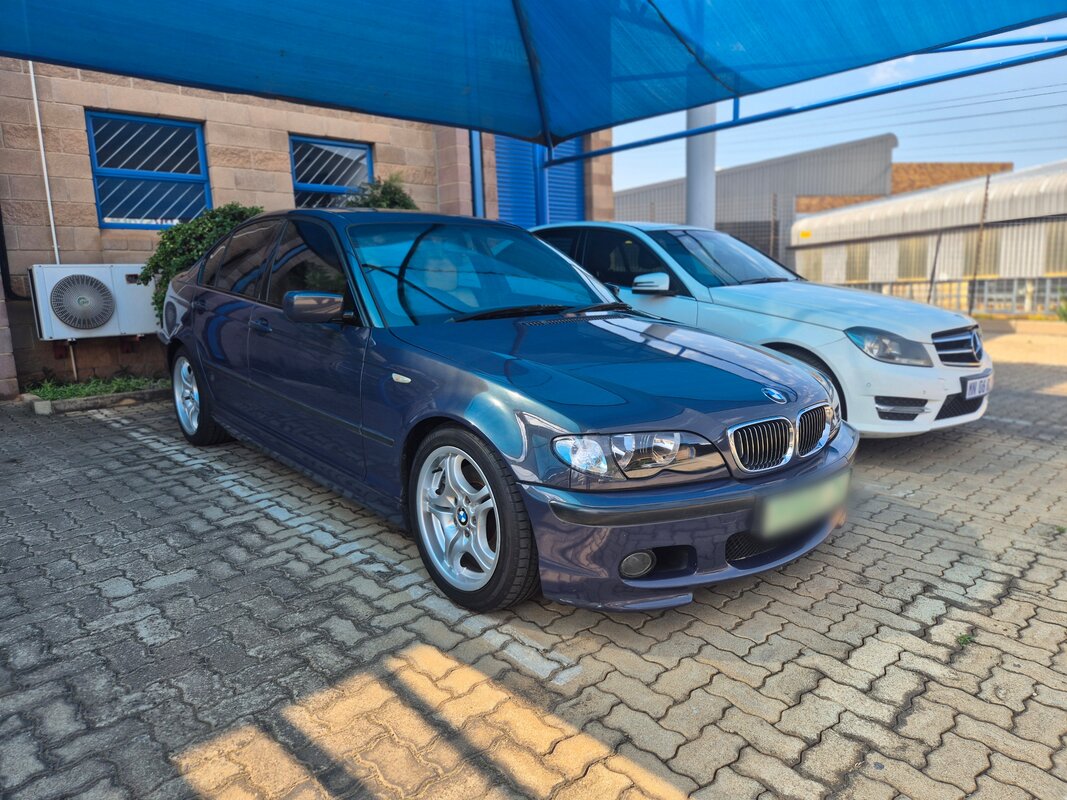

Just a few pics before sending the car off for the interior. Just gave it a wash. Hoping to get it back next week
While its there they will do the boot latch trim as it needs to be colour coded and the plastic roof rails as they were a bit faded and finally a full cut and polish.
