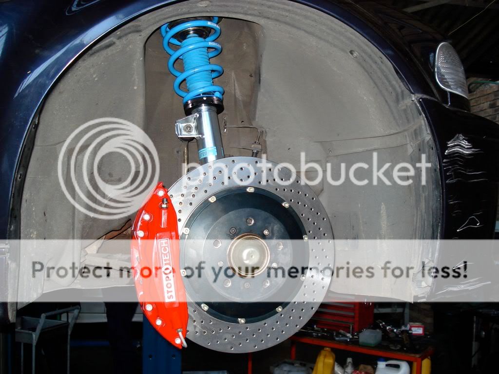

1st things 1st the brakes Any one Know Where to find these brakes from? Pic Attached

The Pic Attached Is from AN Already Converted 328.
Owner To Shy To give details.
So any suggestions where to get this from.
At A reasonable price ofcoz

I cant make out what brakes they are, but Powerbrake can give ou a decent setup. Google them for contact details...based in Jhb

They look similar to my Stoptech Big brake setup... but these have no naming on them... so definitely not stoptech or Brembo.
Here is a pic of the brakes I have on my car.
Crash_Nemesis
The ones I have posted only fit the e46 M3. Front and back is over R50 000. But I have found some that will fit your car. You will have to import them from USA. Stoptech.com is their official site, but they do not sell directly. You will need to go to turner motorsport or a similar shop.
For e36 328i, they sell front set for $2,195.00 -- R21 000.
http://www.turnermotorsport.com/p-395-stoptech-front-big-brake-kit-332mm-e36-e46-z3-z4.aspx
back set is $2,295.00 -- R22 000.
http://www.turnermotorsport.com/p-1326-stoptech-rear-big-brake-kit-e36-325328.aspx
For full set is about R43 000. excluding shipping.
I would look at only doing front set for now.
Here are your options from Stoptech's official site -- http://www.stoptech.com/search/search-results
