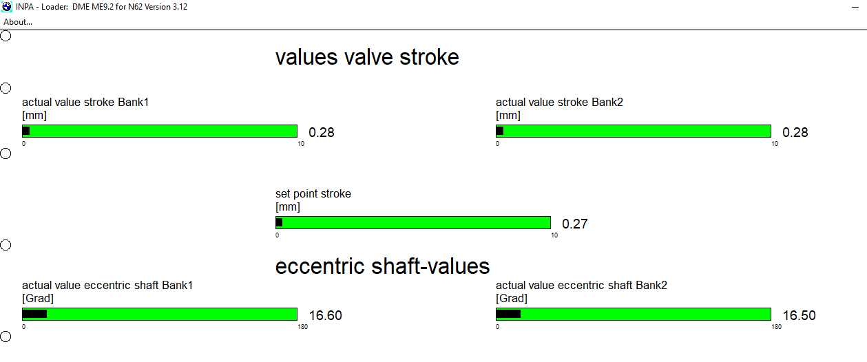

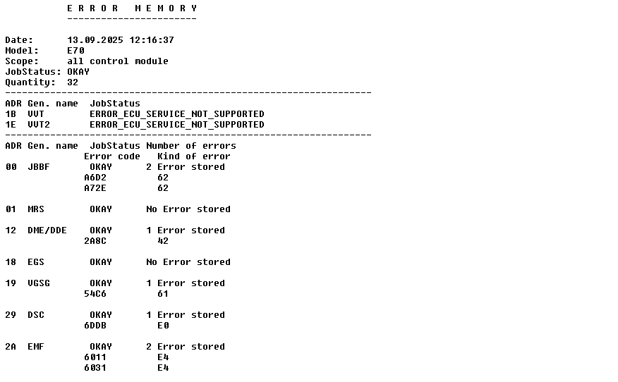

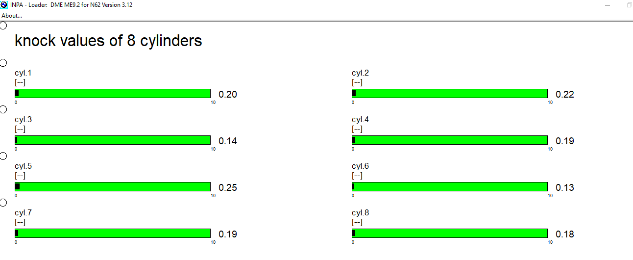

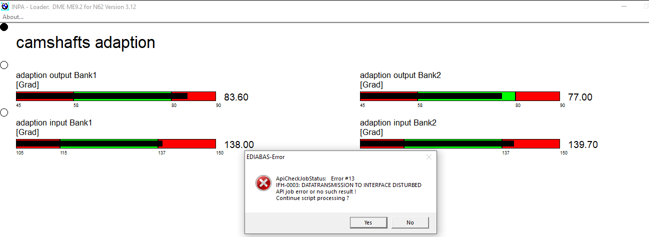

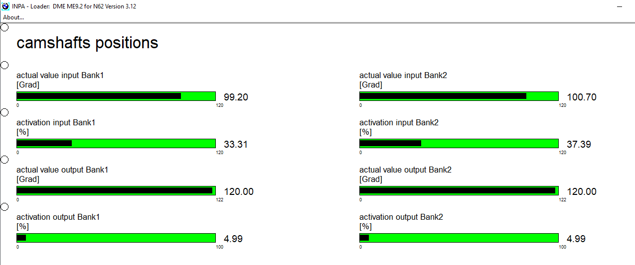

Anyone experienced this issue, all of a sudden I went to start my vehicle and it was running rough, plugged it into INPA and got an error code 2A8C, checked the camshaft adaptions, and all cam adaptions were out, except Output bank 2. So I took solenoids out, cleaned them and tested (all working) and put them back. Got the same error. Any ideas as what could be the problem here.
