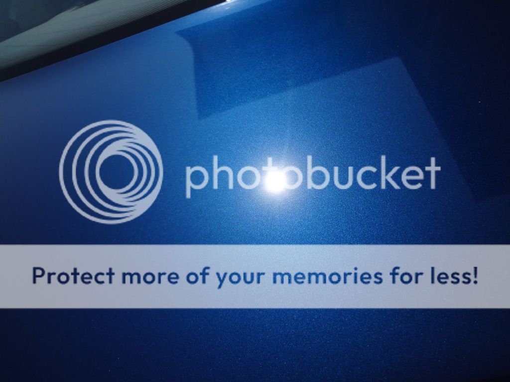

So with the car washed:

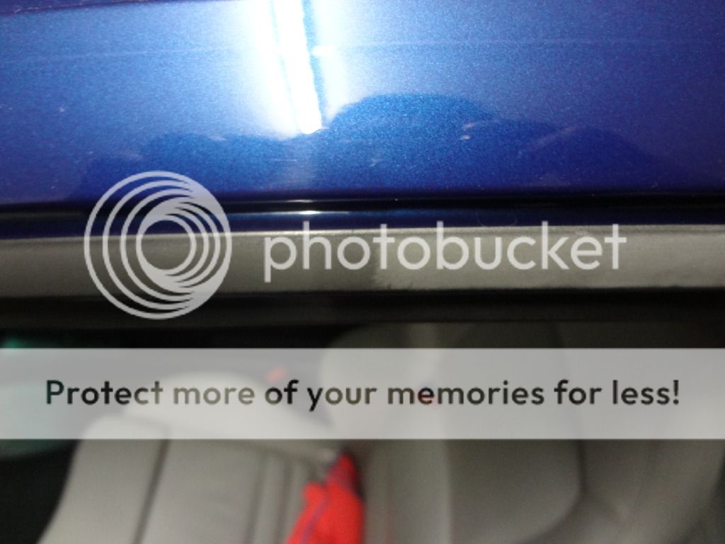

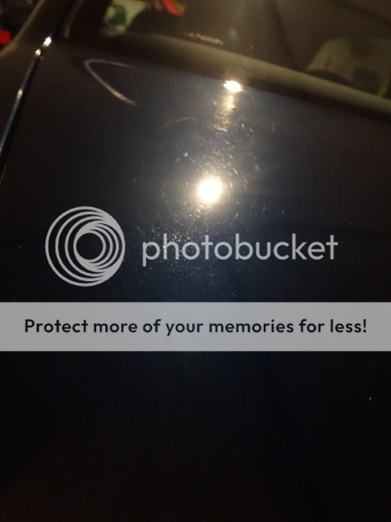

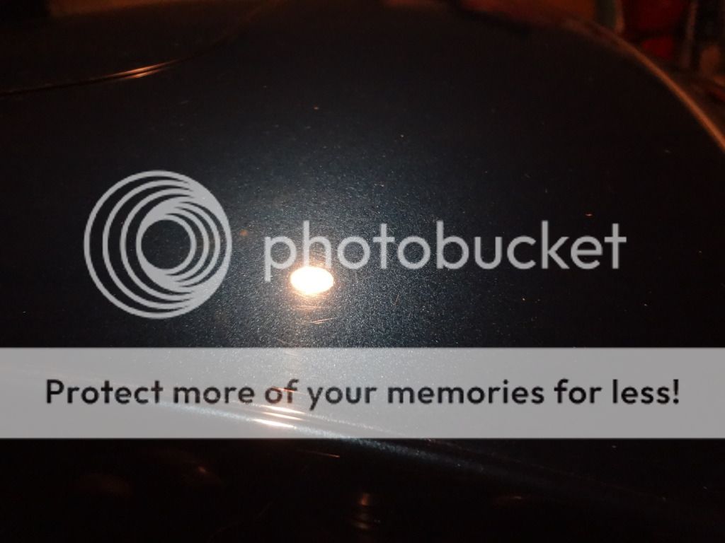

I proceeded to inspect the paint, and found all sorts of nasty swirling and light to mild scratches in the paintwork:

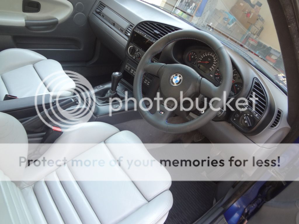

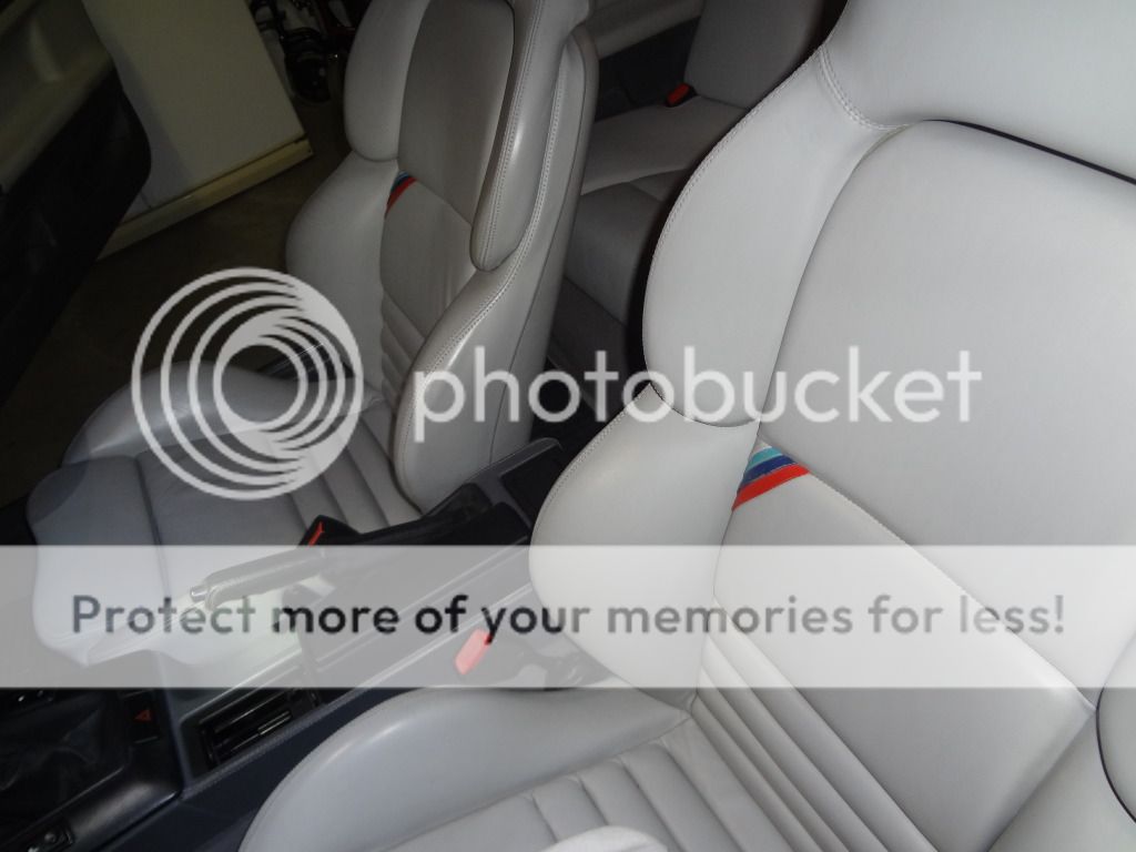

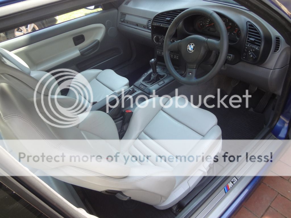

I was saving the polishing for Saturday, so I got stuck in with cleaning the wheels, and doing the interior of the car. I started off with wiping down the seats with a very MILD dilution of Cyclo APC, to get the deeper grime and dirt out. Once that was done, I immediately followed up with AF Hide Cleanser. This was probably a bit of over kill, but the smell of this stuff (Lime) is amazing, and I used it just as a base to go with the conditioner. With that done, the leather went from being shiny to that lovely matte sheen again. I then let the leather temper and dry off properly before I applied the AF Hide Conditioner. On my first application, the leather sucked it all up - so I went for a second, slightly thicker coat, which I left to cure overnight.
Here's a shot of the difference this treatment made - The passenger side being treated, and the driver's side untreated:
Note the matte and more 'white' finish on the passenger seat (the interior colour pack is Titan Grey)

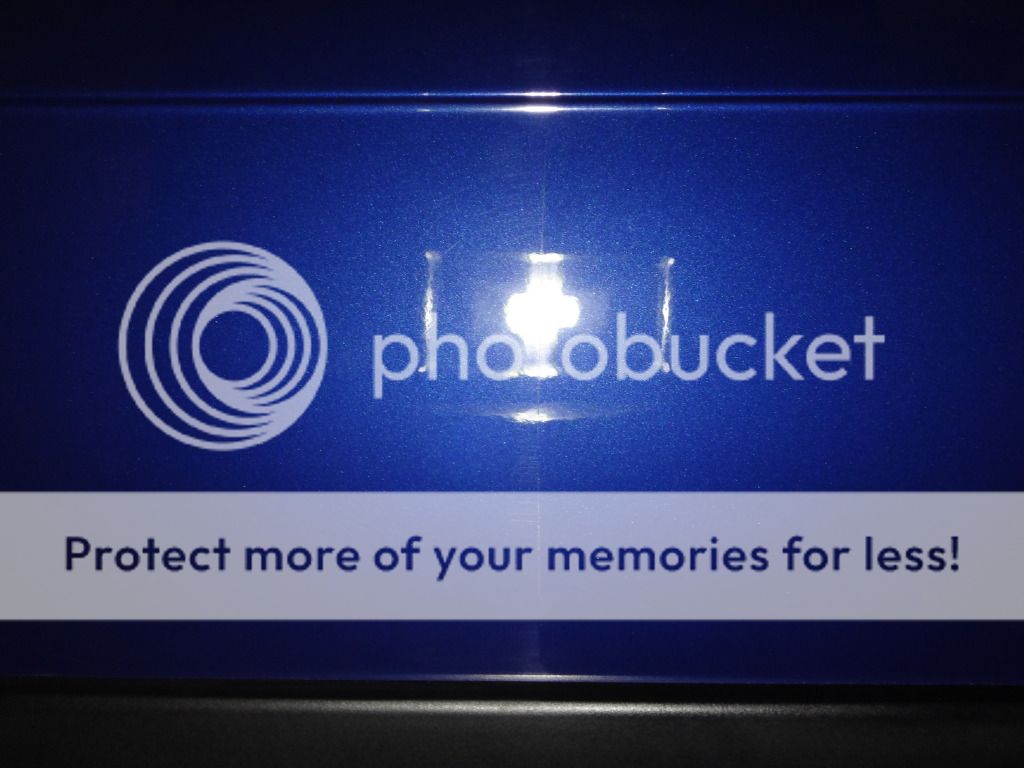

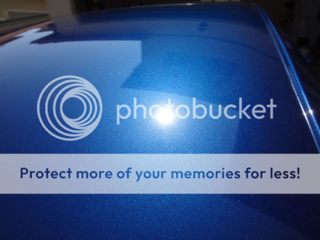

When it came to polishing, it was a dream! Along came a Spider Pad, and sorted my issues out. The only downside to this pad is that they arrived a week too late, or it'd have made my work a lot easier on Gareth's E46 M3. This pad polishes with ease when used with S3 Gold once it softens up (usually after a few passes) and you really don't need to exert any hectic pressure at all while polishing - you just let the pad to all the work!
Here's a 50/50 of a section, left unpolished, right polished:
It's also worth mention that for a compounding pad, it finished down the S3 really well, so I could do this car in one step, no mess, no dust, no fuss.

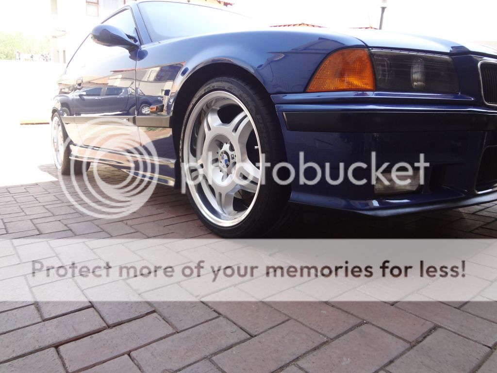

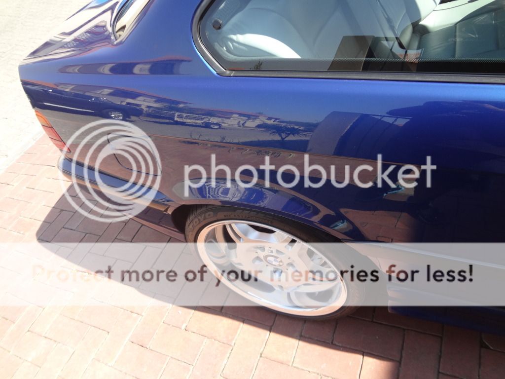

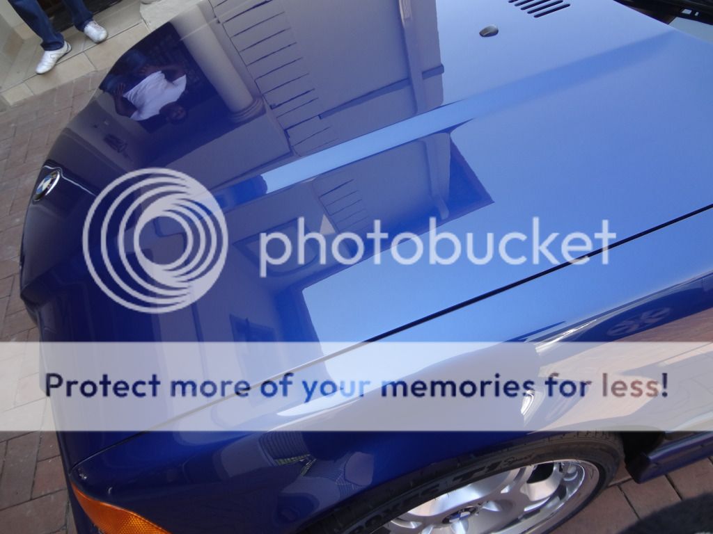

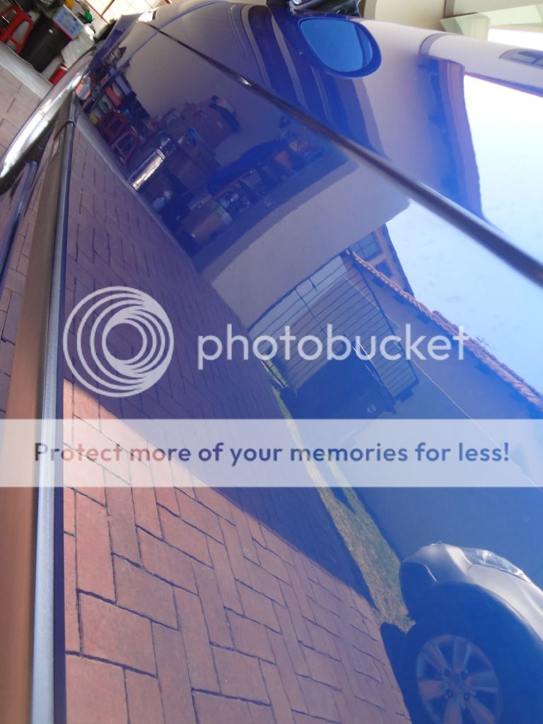

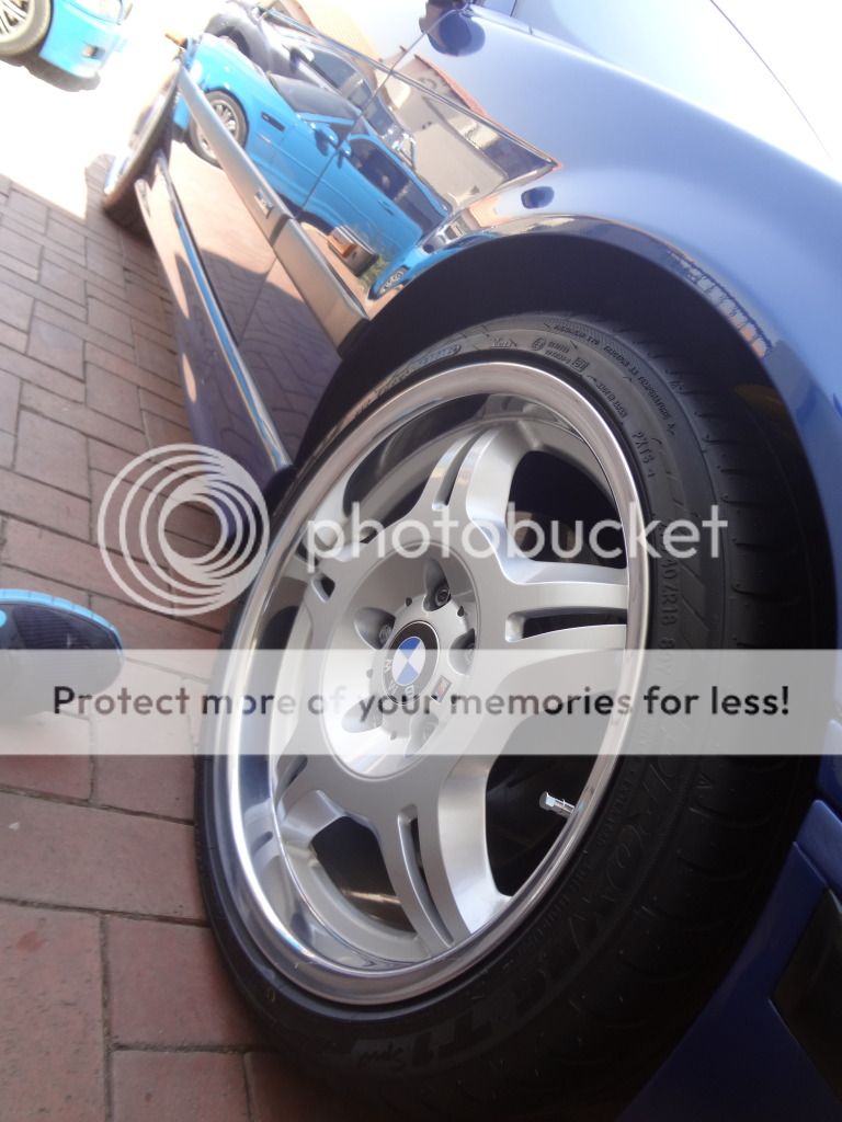

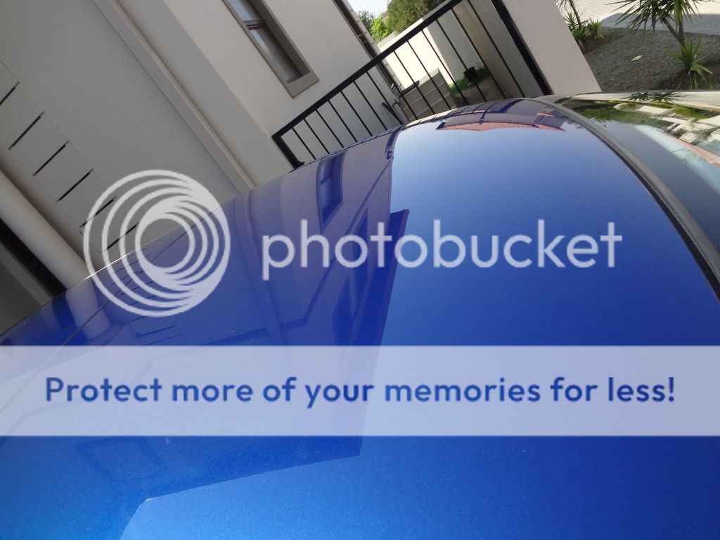

I then applied the BlackFire GEP with a White LC CCS Pad at low speed, then hand applied the BlackFire Wet Diamond. Here are the end results, with the car fully complete:
Exterior:
Interior:
