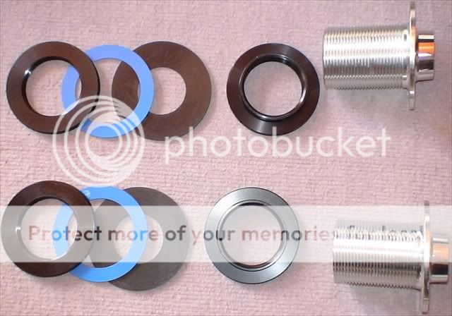

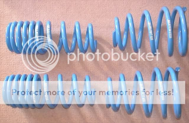

So, the package arrived and I was impressed with the quality of the springs, shocks and all the parts that came with it.

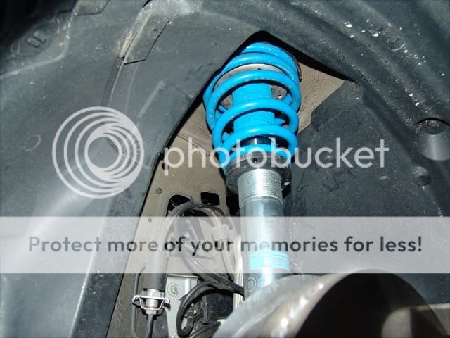

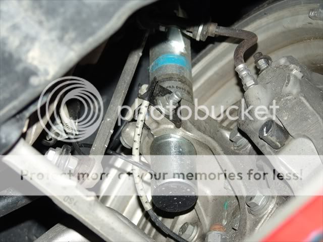

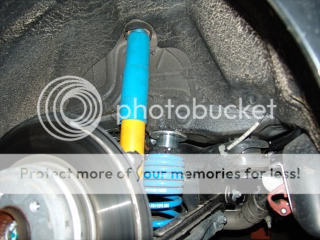

So, after 8 hours over two days the suspension was installed by the dealer. And what a great job they did especially with the wiring and the in cabin mounting of the control unit. The wiring is completely independent from the BMW car wiring and the only link is connecting the Bilstein wires to the battery terminal for powering up the Bilstein control unit. The wiring runs from the 4 shocks on the inside of the car (under the carpet on the sides) to the front of the car near the BMW ECU area where it plugs into its own Bilstein ECU control unit. The only difficulty we had with the wiring install was the fact that the wires of the front shocks come out at the bottom of the shocks which made it more difficult to guide safely upwards to the bonnet area without twisting and forming crinkles unlike the rear shock wires that come out at the top and was easily guided through the existing holes in the body of the car. We discussed the various heights-the kit is fully height adjustable - a 15mm drop was my preference but we settled for 20mm. On the 17' and 18 inch wheels I am sure one can go even lower.
The old suspension was the sport pack version. With the Bilstein kit installed the car had a lowered stance front and rear but not excessively low. I could push one finger and a bit between the rear tire and fender. But the embarrasing stock gap was gone - car appeared streamlined, low and aggressive. My test drive after the install before the wheel alignment was done was a nervous and tensed affair (right in the stomach) expecting to be surprised or experiencing the car to bottom out or to be dissapointed with a very expensive purchase. But the test drive was spoilt by the rubbing of the rear tires (225/35/19 front and 255/30/19 rear) against the fender walls whenever we hit a dip even a slight dip. So we put the standard wheels and tires back on (225/45/17 front and 255/40/17 rear) and yippee off we went!! No rubbing or thumping.

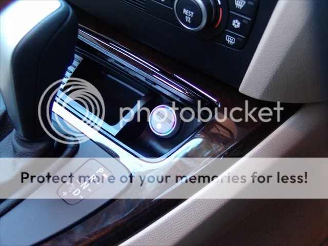

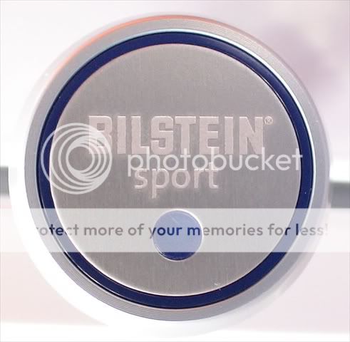

After a short drive the difference in improved handling and ride comfort could be felt immediately. It was a tad softer than the standard suspension. I pressed the sport switch or push-button and wow! That little switch/button was like hitting the G-spot of the car. :clap:
Okay, the description for this round switch/button is a misnomer. When the car is started the suspension is in normal mode (the default mode) but normal mode is actually sport mode, so I will refer to normal mode as sport mode. When you press the switch/button the car is in sport mode but it is actually race mode, so I will refer to it as race mode. Sport and race mode. Sport is the default mode and race mode is when you press the switch. Okay? The switch button emits a pretty blue light when the car is started and when pressed it "clicks" and a tiny spot in the middle of the round button also lits up in bright blue to tell you you are in race mode. I am glad the switch is hidden in the ashtray because at night the blue light is too intrusive and sharp on my eyes and better to close the ashtray lid at night - during the day it is pretty and perfect. The first few days I had to take my eyes of the road to find the switch but I am getting used to its location with less fiddling.

Back to that switch: the race mode is something else altogether - it is simply brilliant!
[color]"The kit features an electronic control unit that senses road characteristics and G-loads and makes shock valving changes in a millisecond!"[/color]
Race mode is an agressive and immediate dampening force selection that seriously tightens up the springs and shocks. It does NOT lower the car but gives the feeling and appearance of being further lowered. Some of the early reviews I read about the B16 system talks about the race mode being too soft for track use and others said it feels like the car was running "on rails" and I think the latter is an apt description for what happens in race mode. I think (my personal opinion) it eliminates the need for further under chassis braces and sway bars - the car is thoroughly glued to the road. No matter how hard you push it in the corners or bends. Look, I am not an expert in all this technical suspension jargon but the experience on the road is simply amazing. I had the opportunity to have fun driving through the challenging Bainskloof mountain pass and remain impressed with the capabilities of the system. You can switch from race to sport so quickly when the road surface worsens to get it back in comfort (sport) mode. I reckon the suspension will get even better over time once settled in...and it has.

4. Installation
