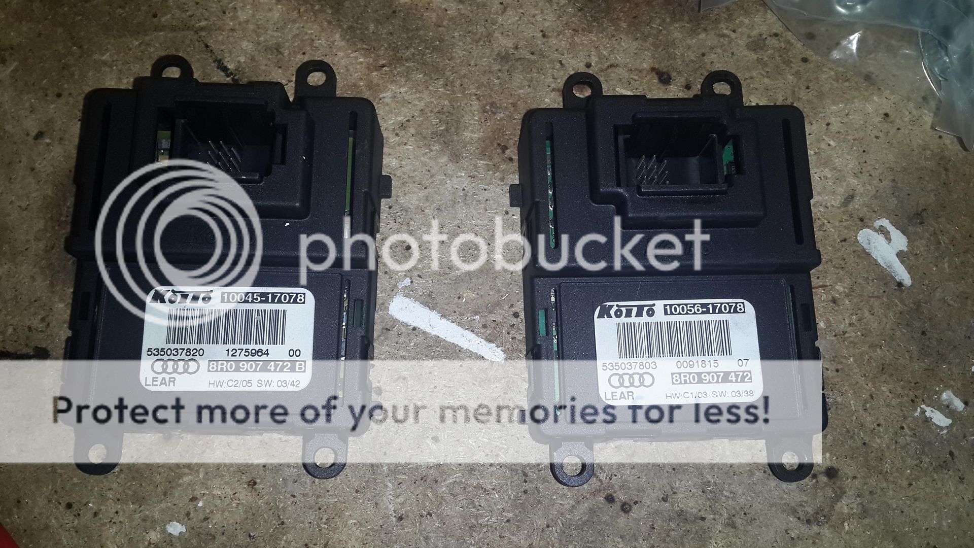

I then opened the unit up to have a look if it's at all serviceable and it looked like the kind of thing I can fix, being an electronics guy. In order to make my life easier, I remove the other DRL as well so that I can compare the two on my bench when fault finding. And guess what, the other side has already been replaced
I know this because it was only held on with one screw (not two like it should be) and it had a 'B' suffix after the part code.
Here we go with the two units next to each other, new one on the left.

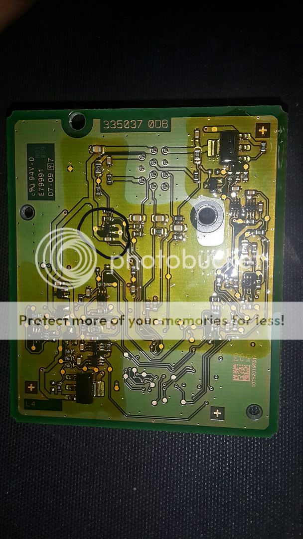

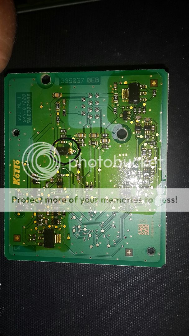

I believe that the revised module had a fix applied to it in order to make it more reliable. Well, to be honest, they only made one fix and that was changing one diode to a larger one. See below, with the only change made between the boards marked with a black circle.

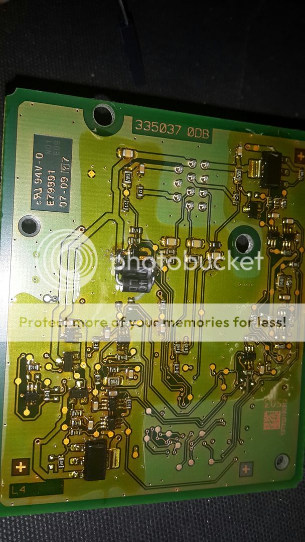

And
I didn't even bother doing any further fault finding, I simply powered the faulty one up on the bench and sure enough, the SOT23 diode was blown. I'd hazard a guess that this diode is rated for around a 1A and the new one for 3A. I didn't have any 3A diodes in my bin and with some testing on the new module I determine there's nothing fancy about the new diode (it's not a Shottky type), it's just a plain general purpose 3A power diode. I had a handful of 1N4007's here, that are rated for only 1A but I connected two in parallel in order to improve power handling. There's nothing further down the chain that needs more power than that so I just went with it. If it does break again (which I seriously doubt) then I'll get the correct type.
Anyway, here's the fix applied. I didn't remove the faulty diode as it simply went open circuit so wouldn't interfere with the fix. These modules are so covered in conformal coating, trying to remove the old diode would just make a mess.

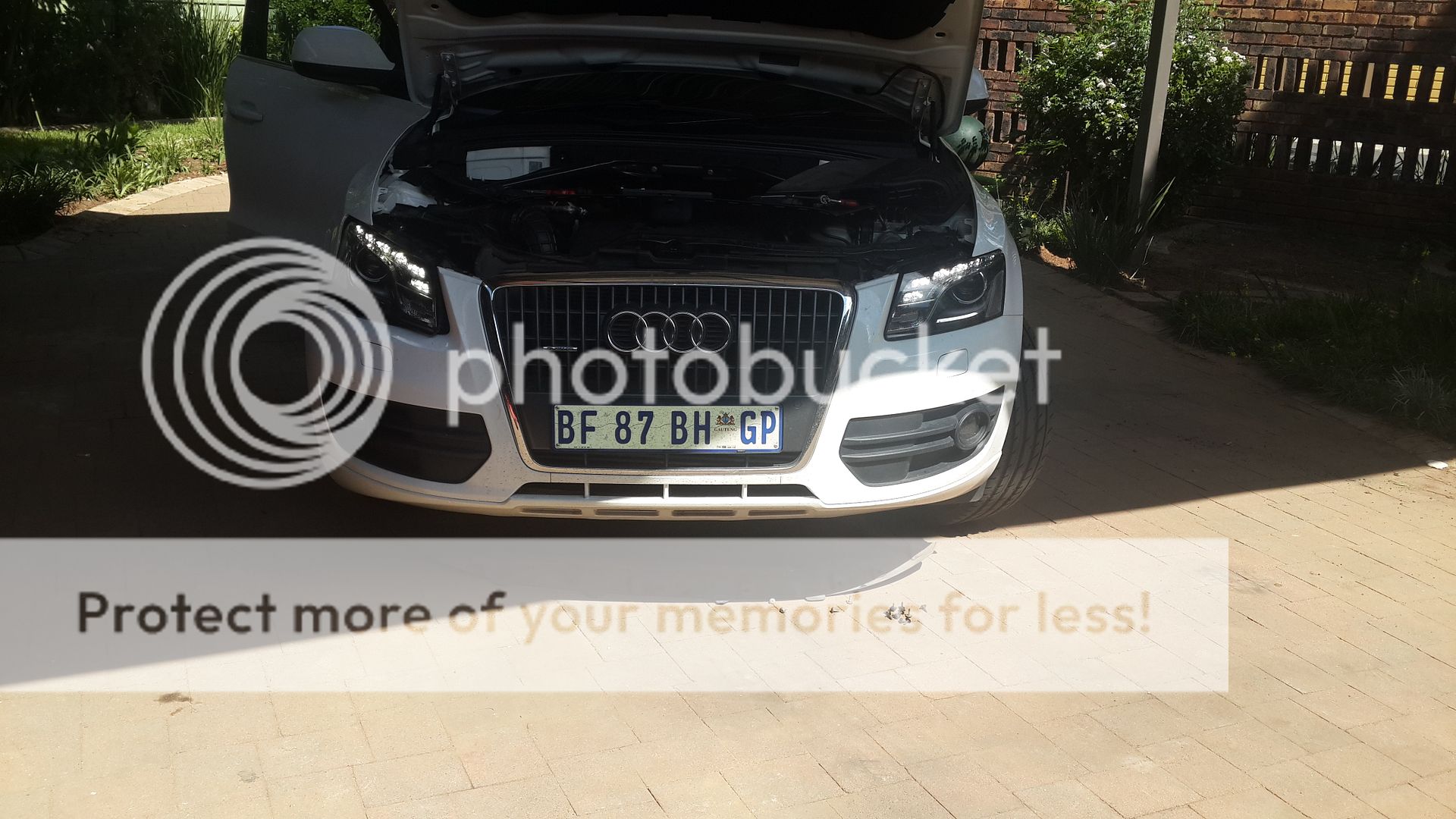

After the repair, I quickly connected the Right headlight again to test and, Voila!
