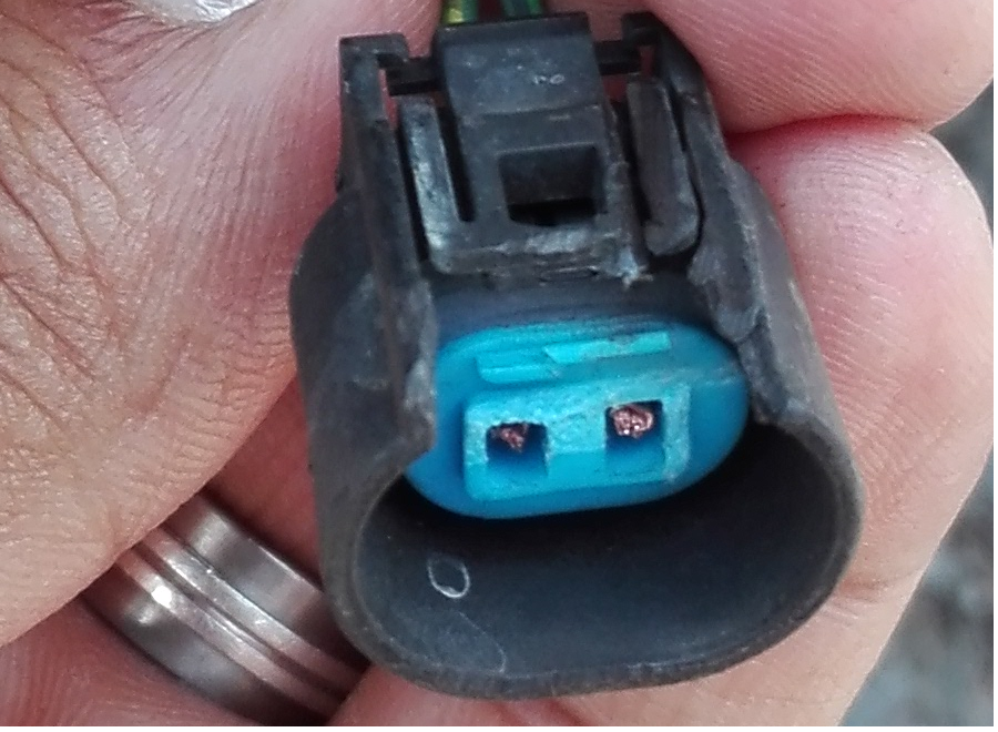

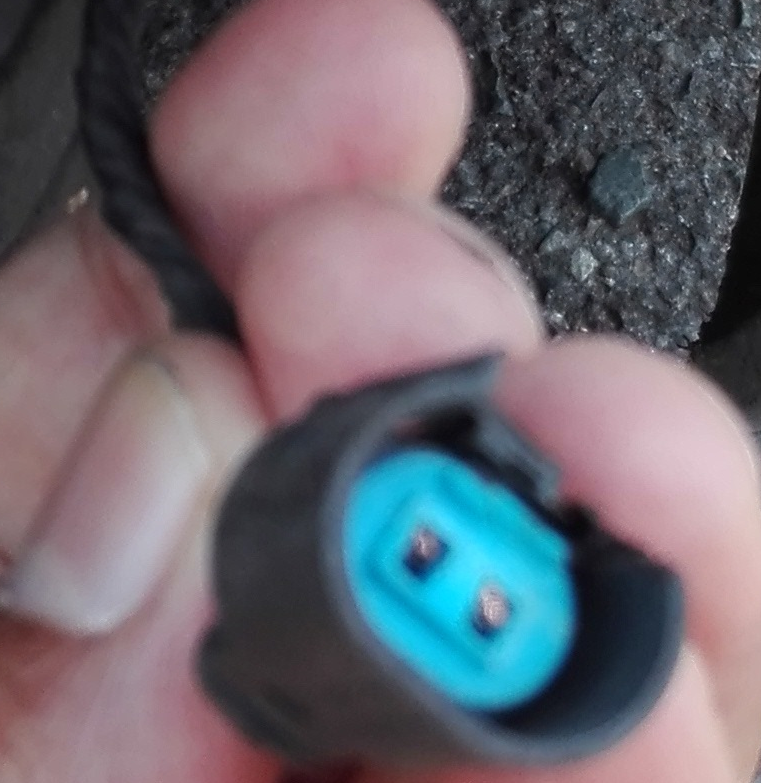

Anyone know what this is?
DXXL
The car in question is a 2003 E46 325i. This "plug" is at the front right side. It's next to the cable for the front right fog light.
What is this supposed to plug into? Or what plugs into this?[/align]
DieselFan
Is it just me or does it look like a plugs broken off inside there and the wires cut? Looks like individual copper strands.
Sent from my SM-G900F using Tapatalk
ChefDJ
Definitely does look like it was ripped out of wherever it belongs. The clip to secure the female plug in place is still holding onto the male counterpart.

I checked this and nothing seems to be missing from behind the headlight. The headlights still adjusts up and down properly.
It's very possible that it's been ripped out from somewhere. A couple weeks ago a taxi clipped my front bumper and literally ripped it out. See this thread:
http://www.bmwfanatics.co.za/showthread.php?tid=71986
DXXL
Gizmo said:
It goes to the thermostat switch for the heated windshield washer nozzles.
Part number 4. http://www.realoem.com/bmw/enUS/showparts?id=ET36-EUR-02-2004-E46-BMW-325i&diagId=61_1059
You're welcome! ;)
Looks like that is the part!!! Thank you!!!
