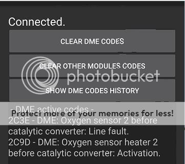

Not sure if my O2 sensor is on its way out, I keep getting this error when I scan with MHD
can anyone assist with some advice, starting to get real annoying, cause the JB4 keeps going back to Map 4 when this happens, but car still drives okay, just with stock power
A pre cat sensor with a heater error code is definately a goner... This is on bank 2 (cylinder 4/5/6)
Replace the sensor and all will be well...

Kish2604 said:
You maneer are a genius, got misfires this morning on cylinder 4/5 and 6 cleared codes and she going again, made it to work, now just need to make it back home.

Kish2604
Administrator
bank 2 is cylinders 4-5-6, thats the rear turbo closest to the gearbox.
Simple way to reassure yourself before you outlay cash is log via the jb4 app or interface the Afr and Afr2 values... the bank 2 (afr2) will be running leaner. :coolShake:

Sorry Kish,
I'm going to go ahead and just replace the thing, but need your guidance and for my sanity, can you show me witch one I need to replace as per the pic below
Kish2604
Administrator
Your looking for sensor number 2... Just as an aside.. Both sensors are physically the same, it's just the length and colour of the cable that's different.

So if my Understanding is correct I'm looking for the following
02 REGULATING LAMBDA PROBEL= 1200MM 111787558087
Iceman12596
Kish2604 said:
That's correct
Kish, replaced sensor i got from hubbly and all is working as you said.
