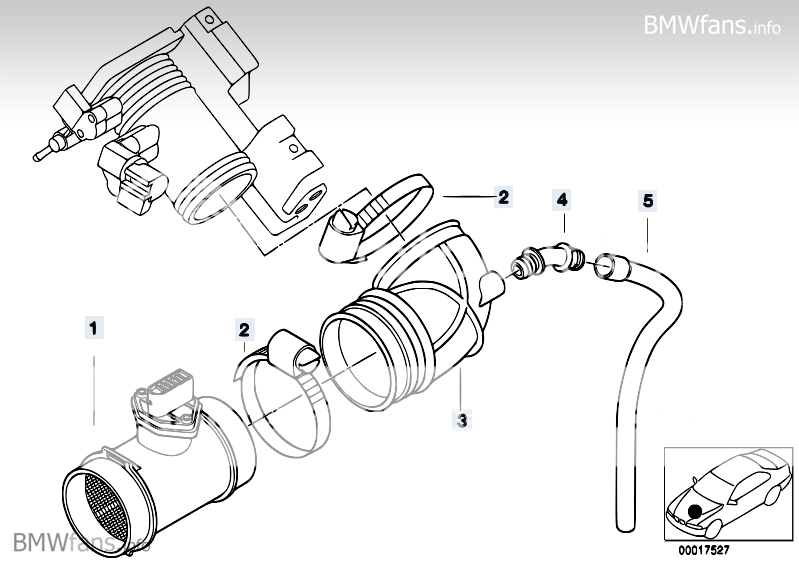

Heya all,
Ive been having a problem with a rough idle and my car also revs its self to about 1800rpm.
So took apart my maf to clean the sensor which helped a bit...but at the same time i noticed that the pipe (no 4 and 5 in the diag) that was ment to be connected to the boot (no 3 in diag) was not connected and hanging free
It looks like it has been glued back once or twice, most likely broken during a service.
So im going to replace all the damaged pieces, but my question is does anyone know where this little pipe leads and what its for?
thanks in advance

thanks for the quick response...im gonna have to change the boot and pipe cuz its clogged with glue thanks to a dodge fix during my last service
