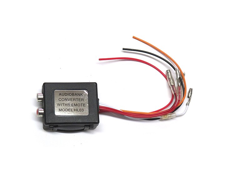

I have this one but i don't have the wiring diagram? how does this work?

Normally the orange is remote. The other colors are pretty straight forward...

So what is the red and black wire for?
:dunnoanymore:
Spiro
ok so...
red and black wire you attach to a normal always online power source, then you feed to orange to your amp
once there is an audio signal present, the Amp will turn on

No no.... normally you tap into a spare constant 12V..
Remember
Red - Constant 12+ (input )
Black - Negative - Ground from Car (input )
Orange - Output to remote on your amp
then you have
Speaker Input - These you feed or tap from rear speakers ( depending on which signal Freq you want )
Pair for Left Input
Pair for right input
then run the RCA cables to your amp
Done

The factory head unit has a built in crossover. Even the standard head units. It only sends mid/high range frequencies to the rear shelf speakers. Dont tap there it will sound horrific. I tapped from the subs under the seat.
