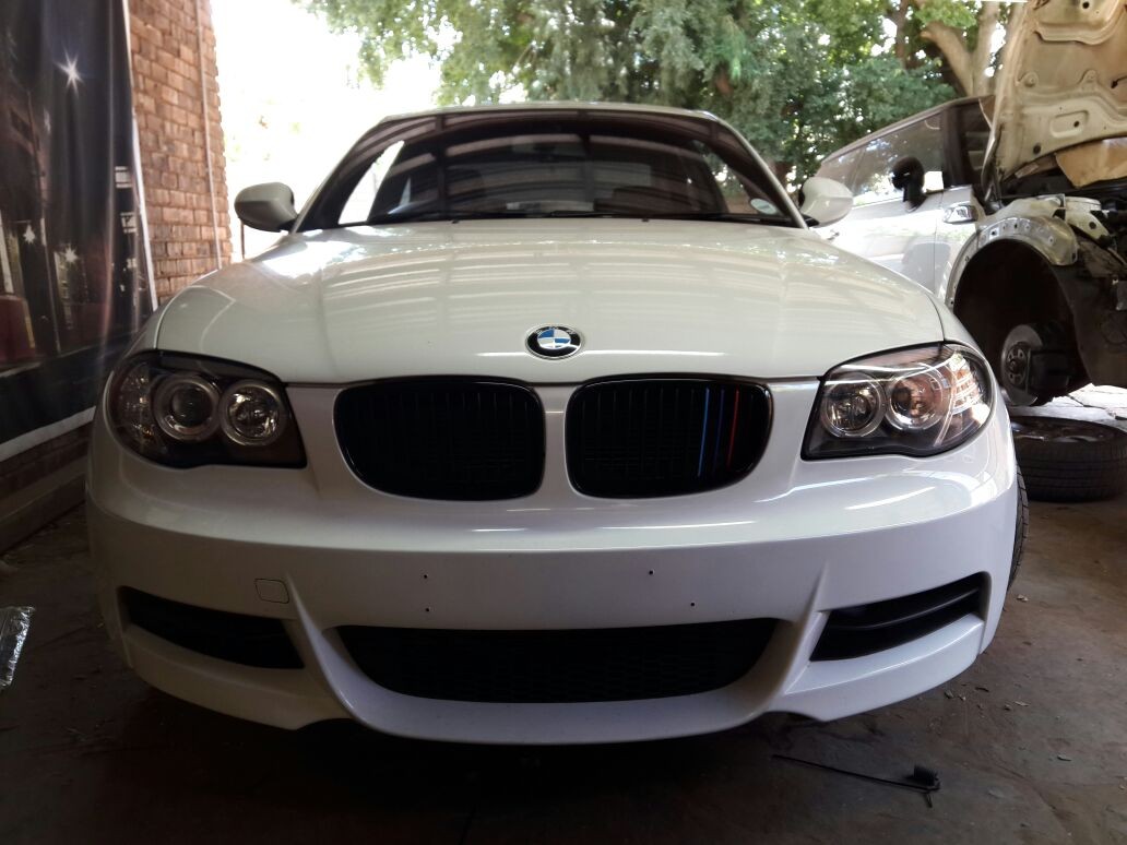

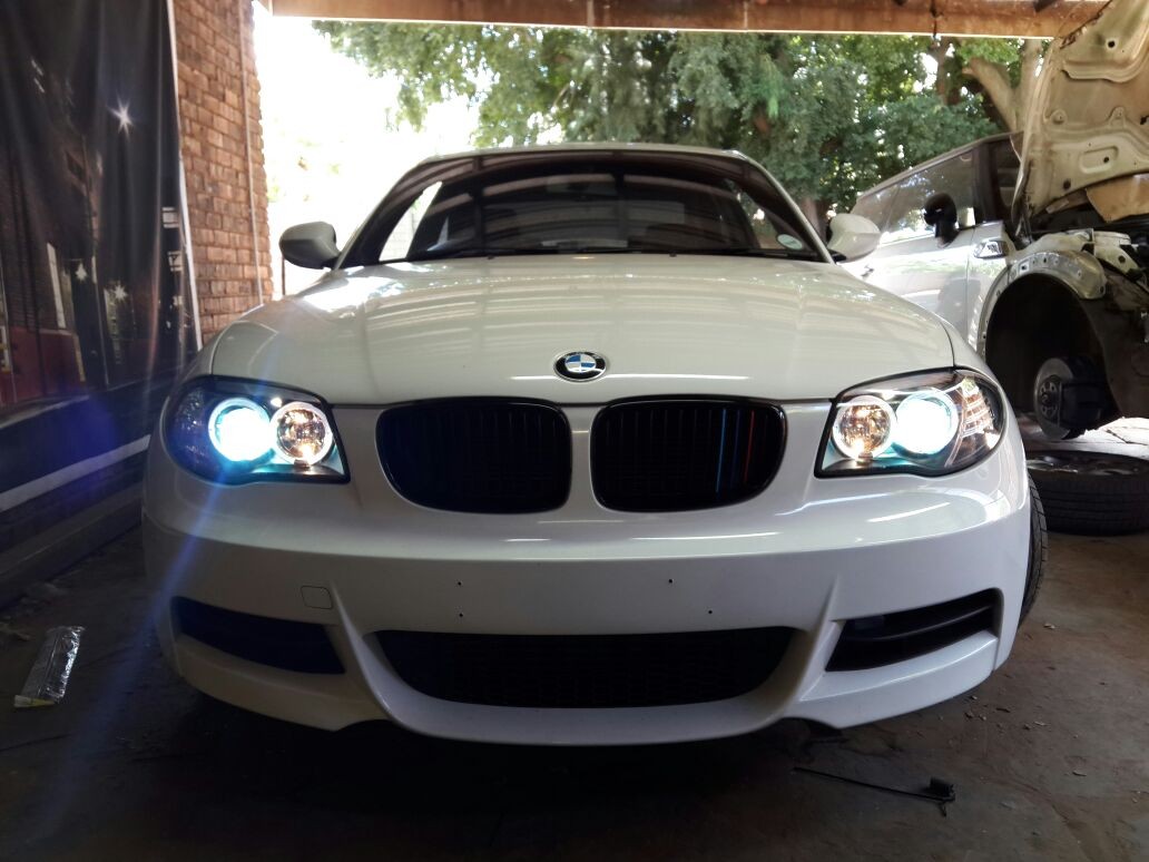

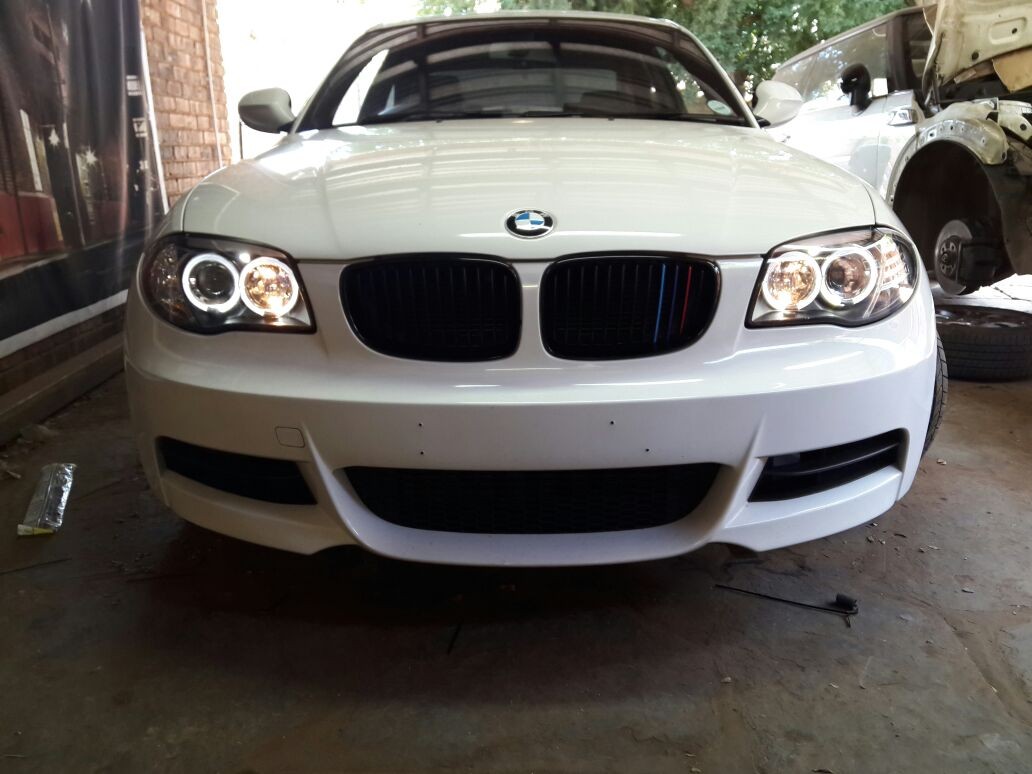

Just thought I would share my new headlight upgrade with the members.
My 135i never came with Xenons and after buying a few different types of bulbs and still not being happy I though i would try and change the headlights completely.
Comments welcome !

Hi all,
So as for fitment,one of the BMW techs that I work with did it for me.
Its pretty straight forward, one needs to remove the bumper and the rest is plug and pay.
I have however removed the lights again as I was not happy with cutoff line and when I tried to adjust them, I accidentally over adjusted the one bolt and the clip that holds the adjuster jumped out. The only issue with these is that they are a bit of mission to adjust. I will upload some pics later on.
I bought them from See-Dat Motorsport in Isando. They cost R3800.
I am in Pretoria East if anyone would like to come and see them.

Are you sure its just simple plug and play? did he not fit an HID kit or change wiring?
Mpower11
I did use an HID kit- but that the lights come with their own wiring, so Its not necessary to cut any wires from the original lights.Send me your number and I can explain it in details as to what exactly needs to be done.
