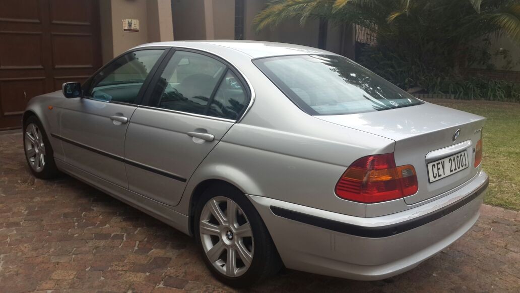

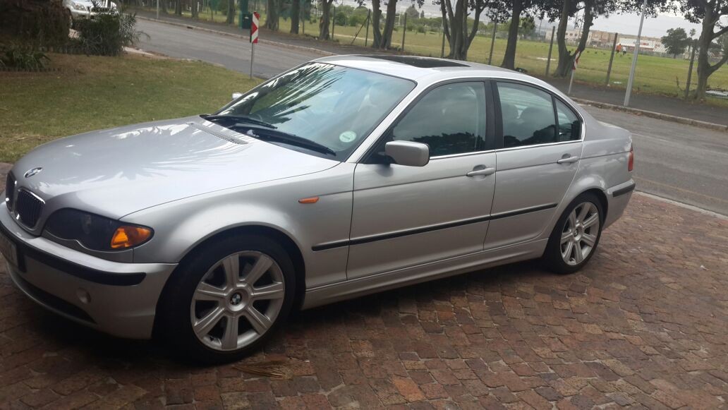

stiaan
Got the pics from the owner, Im going to try get the vin nr so can get the history @ BMW.
