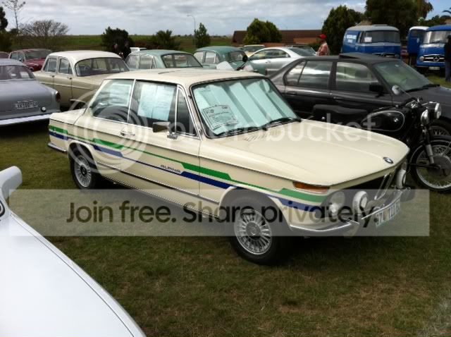

So this is what she finally looked like at the show:
Had a very good response from the public as well as a photographer from Car Magazine. Holding thumbs that she might make it into the next edition.....
Thanks for all the encouragement, and it was great to meet Phillip and Jandre at the show.
