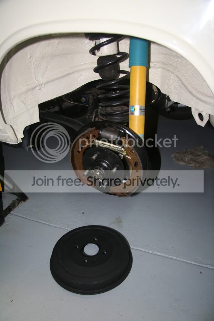

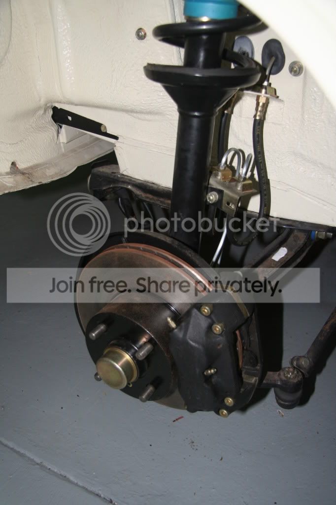

So this is my 10 year project which will be shown for the first time at the George Show on 11 Feb:

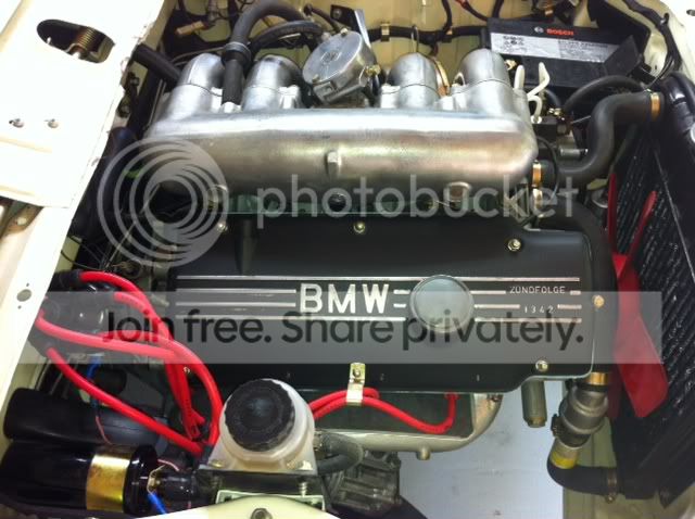

Engine:
Rebored .5mm oversize and new pistons and rings;
Bottom end balanced from clutch to crank pulley;
Lightened flywheel;
300deg Alpina Cam;
Enlarged S/S Exhaust Valves;
Compression Ratio upped to 10:1
Alpina A4 Kugelfisher Injection pump;
Pertonix Ignitor Ignition with 40,000V Flame Thrower Coil;
8mm Silicone HT Leads;
Ceramic coated Exhaust manifold and downpipe;
Getrag 235/5 Close Ratio dog-leg box;
Genuine 2002 LSD.........
More to follow:rollsmile:
