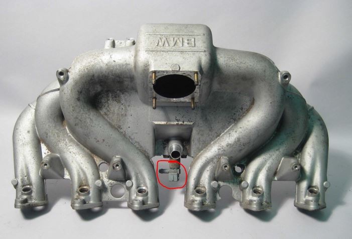

Then I found the point where I had a vacuum leak.
It was on the point where the evaporative purge system used to be connected on USA models. ZA models have a blank on. this little blank cap perished and started leaking badly.
Part no. 14.
The view from below(not my actual manifold shown):
Part no. 14.
