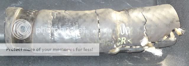

530d E39 Vacuum leak
Bossman
Here is a picture of the short piece of vacuum pipe that I had to replace
on the inlet to the vacuum pump. See how cracked it was.

No this is a diesel, there is no boost at the vacuum pump,there is only boost on the inlet manifold, this piece of pipe is,
mounted in the inlet to the camshaft driven vacuum pump.
The car is a 2002 E39 530d with 210000 on the odo.
