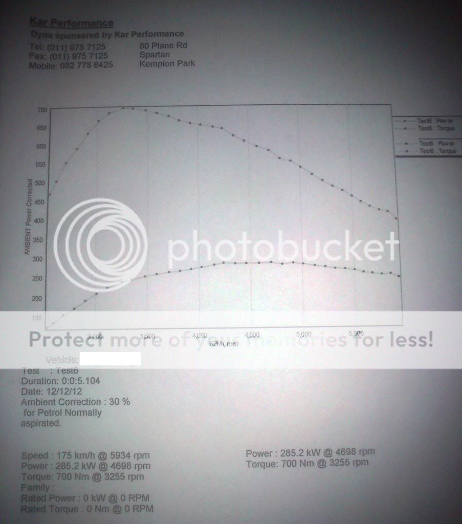

So I was on leave today and had some spare time on my hands, decided to see what my 335 can do at KAR .
Finally managed to get my meths running properly as I was having issues with it boiling when using the windscreen wiper, imported this tank from the US
Holds over 10l and is high quality, Alcohol injection Systems also helped me match all my fittings to the Vishnu PWM system.
So on 95RON and a 70/30 meths mix I made 285.2wkw and 700Nm this equates to about 348kW and 833Nm at the fly :rollsmile:
Am still a few kW's short of Rowen's record of 292wkw's with the M1 on pump fuel for stock turbo's at altitude, and still a fair way off Ed-z massive record of 308wkw's with stock turbo's on E85, but hey overall I'm over the moon with the result
PS: pls no politics with this tread (re which tunes are better etc), nothing to prove just thought I'd share it with those that are interested and have a passion for their BMW's

Would love to see some closeups of the meth tank and a dyno sheet.:bravo:
As for the disclaimer this car is tuned by Baracus so what is there to argue .:bravo:
Apologies for the poor quality pic but had to take it with my phone

Try what we said today. I found my old sheet and the boost was 16psi with only 531nm but peaked 10whp less than you only.
Agreed, think I need to turn down the boost slightly in the lower rpm's which should reduce the build up of friction a bit on the turbo's and hopefully give them a little more where I need it on top :thumbs:

Thats a strong "street" torque curve...me like alot :inlove:
Sherwin@xcede
Holy mother of torque! Well done Baracus. I know you've been through a lot & have worked hard to make this power. You deserve it, you have the strongest stock turbo N54 (besides the 1M's) on that dyno.
