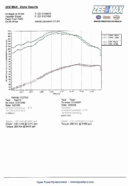

These are my dyno graphs in the stages that i did the work to my car. (I have posted these elsewhere but here they are again for ease of reference.)
The intake really makes a big difference to me because I mostly drive on the highways to work and back which is 90% of my driving in this car.
The combination of the intake and the cams however means that my car is absolutely no good in a robot to robot dice - all the fun is in the mid- high rev range only:fencelook:
Stage 1: Chip, decat and K&N filter
Stage 2: M50 intake
Stage 3: Group N Spec Cams by Van Der Linde
