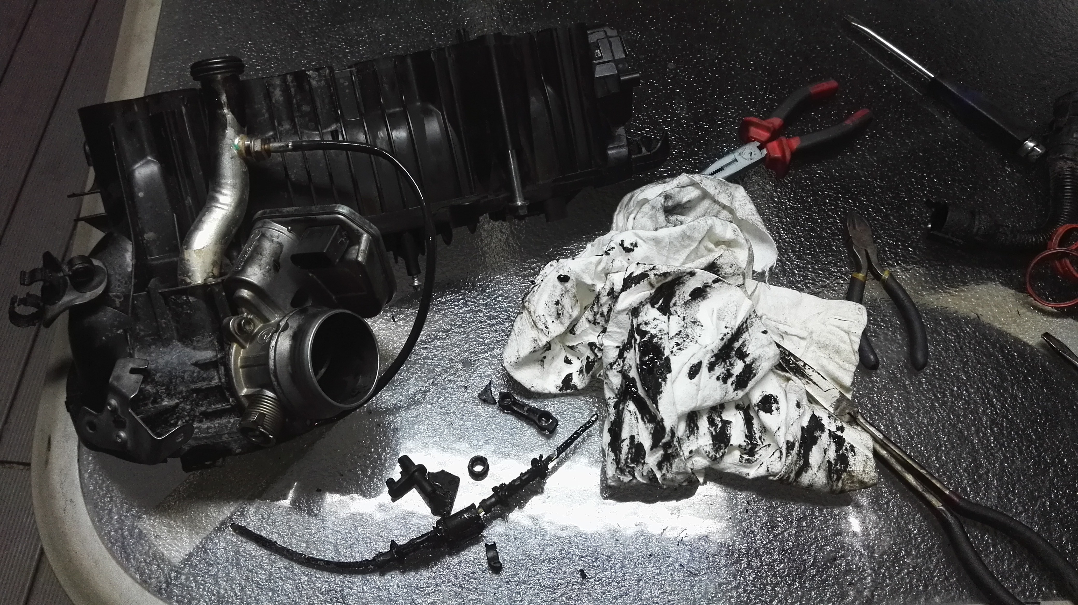

There are a swirl per cylinder.
The actuator valve that turns the swirl rod & flaps broke off..and the swirl rod broke the manifold where it connects to the actuator valve.
After removing the manifold i noticed two of the swirl flaps were stuck in the position you see in the pic. I suspect the stuck flaps caused the valve from breaking...another swirl flap had signs of disintegration.

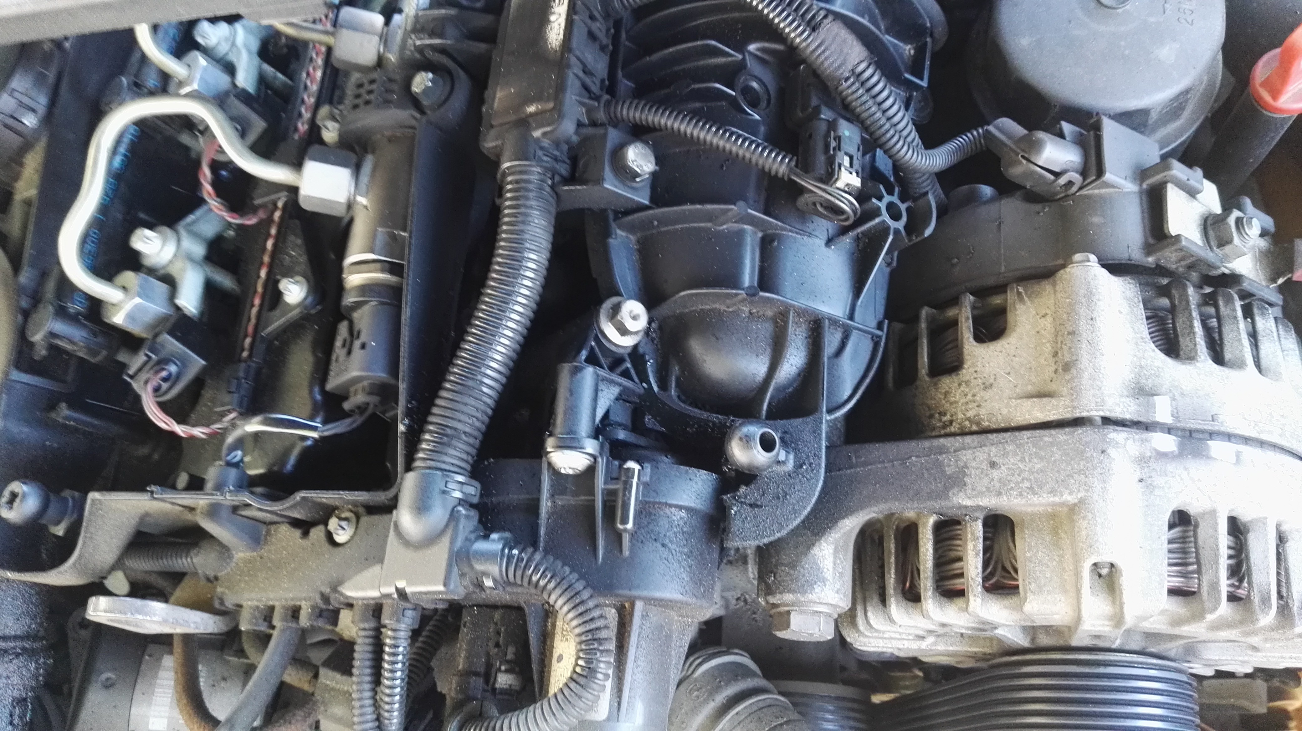

if you want to know if you got swirl flaps, remove the dust cover and take a pic of your engine bay and post it here. That will be a good start.

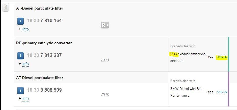

Doing some further research though, it appears there is just a normal CAT and not a DPF.
According to my VIN...
Engine N47T
Vehicle options
S169A EU3 exhaust emissions standard
Unless I am completely misunderstanding this :hammerhead:

...And the intake manifold...

According to those diagrammes you have DPF & swirl flaps.
