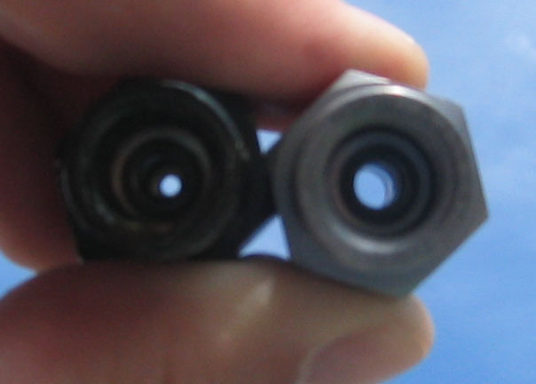

Just curious, have you removed the CDV? I am pretty sure that's why these diesels go through clutches so fast and develop problems with shuddering...

Philip Foglar
CDV = Clutch Delay Valve (read more info here)
Where is the CDV located:
Below - original CDV left, modified CDV right:
:thumbs:
