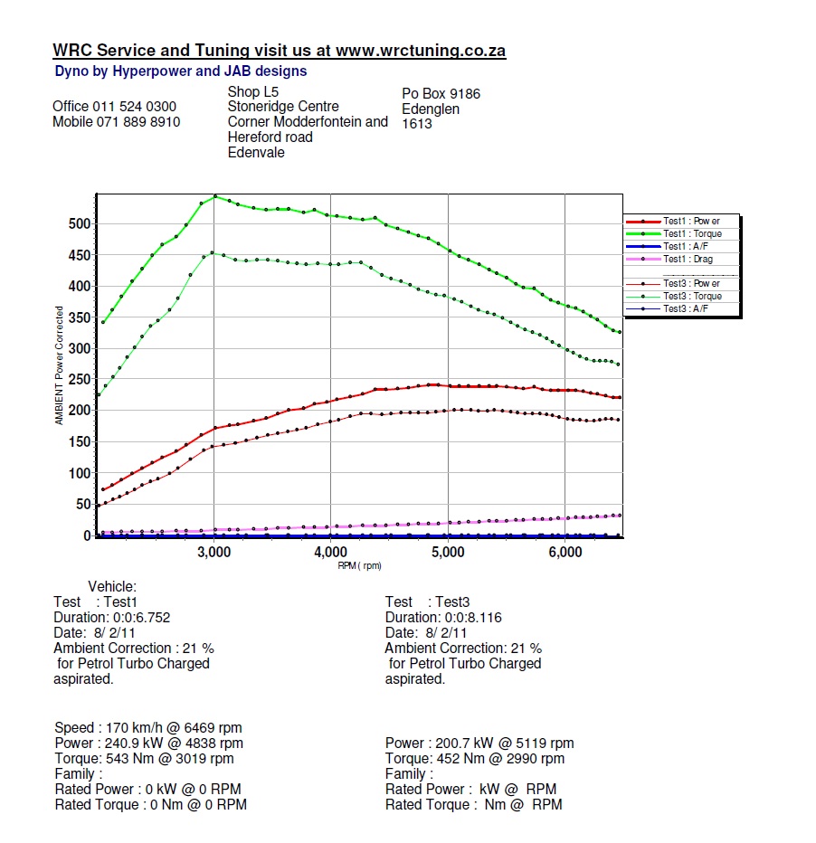

The best combo is the twin-turbo engine with the DCT box. Like this Z4 3.5iS. Got the 250kw engine from the 1M & the DCT box. And a really sporty exhaust note. Awesome package.
Just to illustrate how the torque ruins the launch capability, look at the torque gain of the Z4. And this is over a car that came with a factory over-boost feature.
