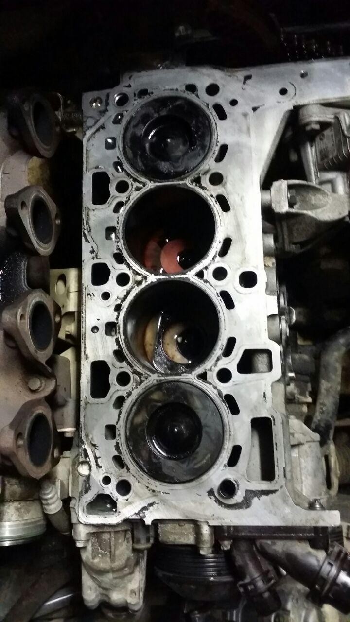

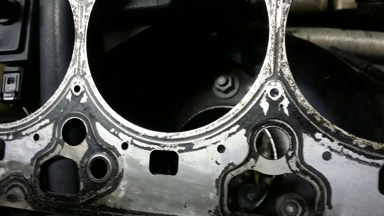

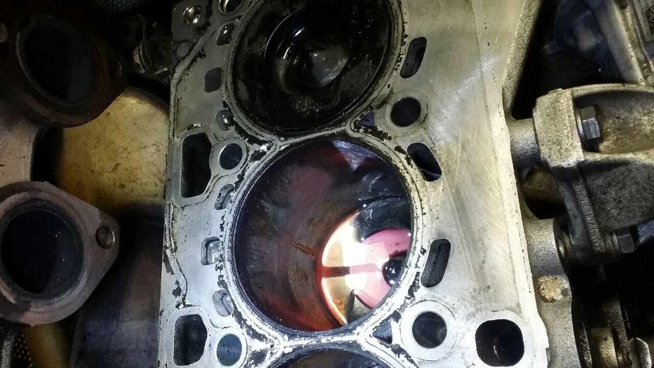

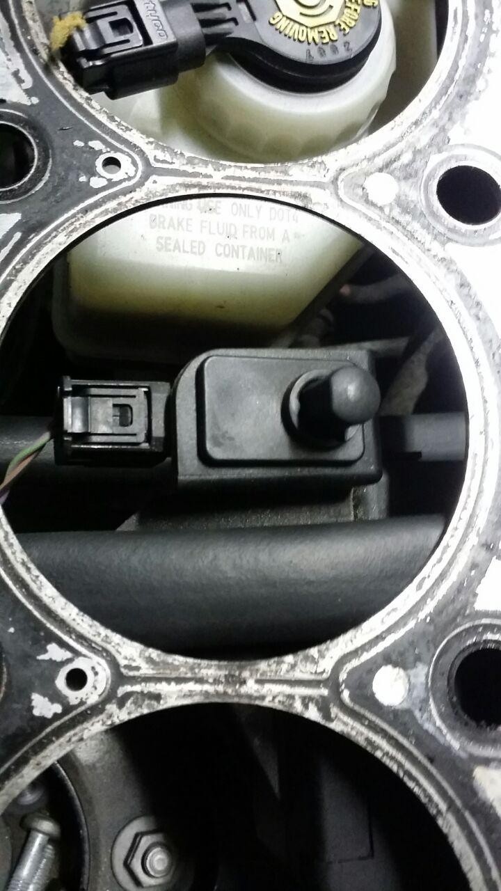

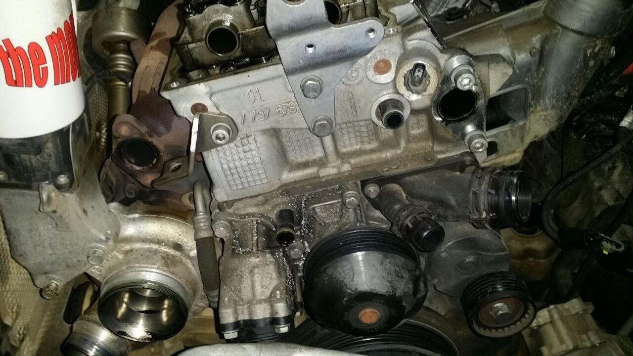

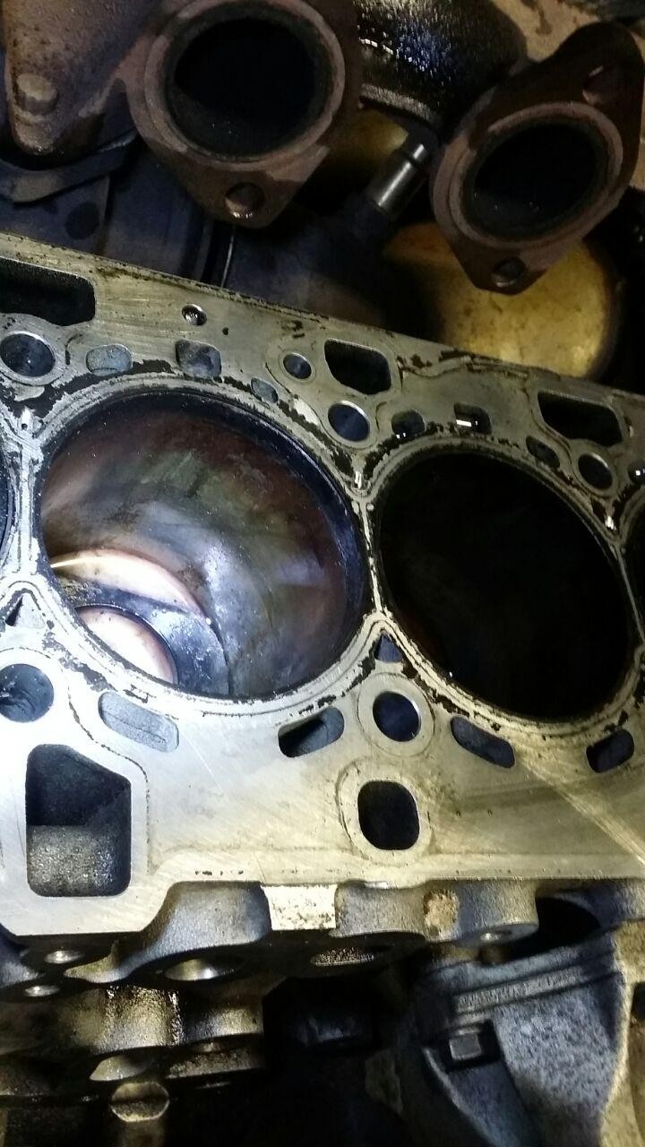

I'm also going to check the bores for cracks which is absolute worse case... holding thumbs - will include some pictures next.
Cylinder walls checked - nothing seems to be damaged or cracked - cylinder head is going in on Monday for pressure testing and new valve stem seals.
Pictures of the Carnage...

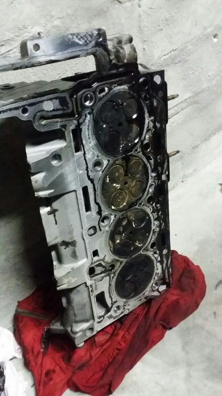

So after putting everything back in place - we still have a water leak, so it wasn't the head gasket - F**K!
So the heads come off and been sent to the engineers to coolant pressure test it and see what the outcome is - holding thumbs its fixable - else I'll need to find a replacement head which I really dont want to have to do...
noodlemonkey
According to my Mechanic the Value Guides/Stems do break from time to time and because there is water flowing directly next to the guides/stems it'll leak there.
